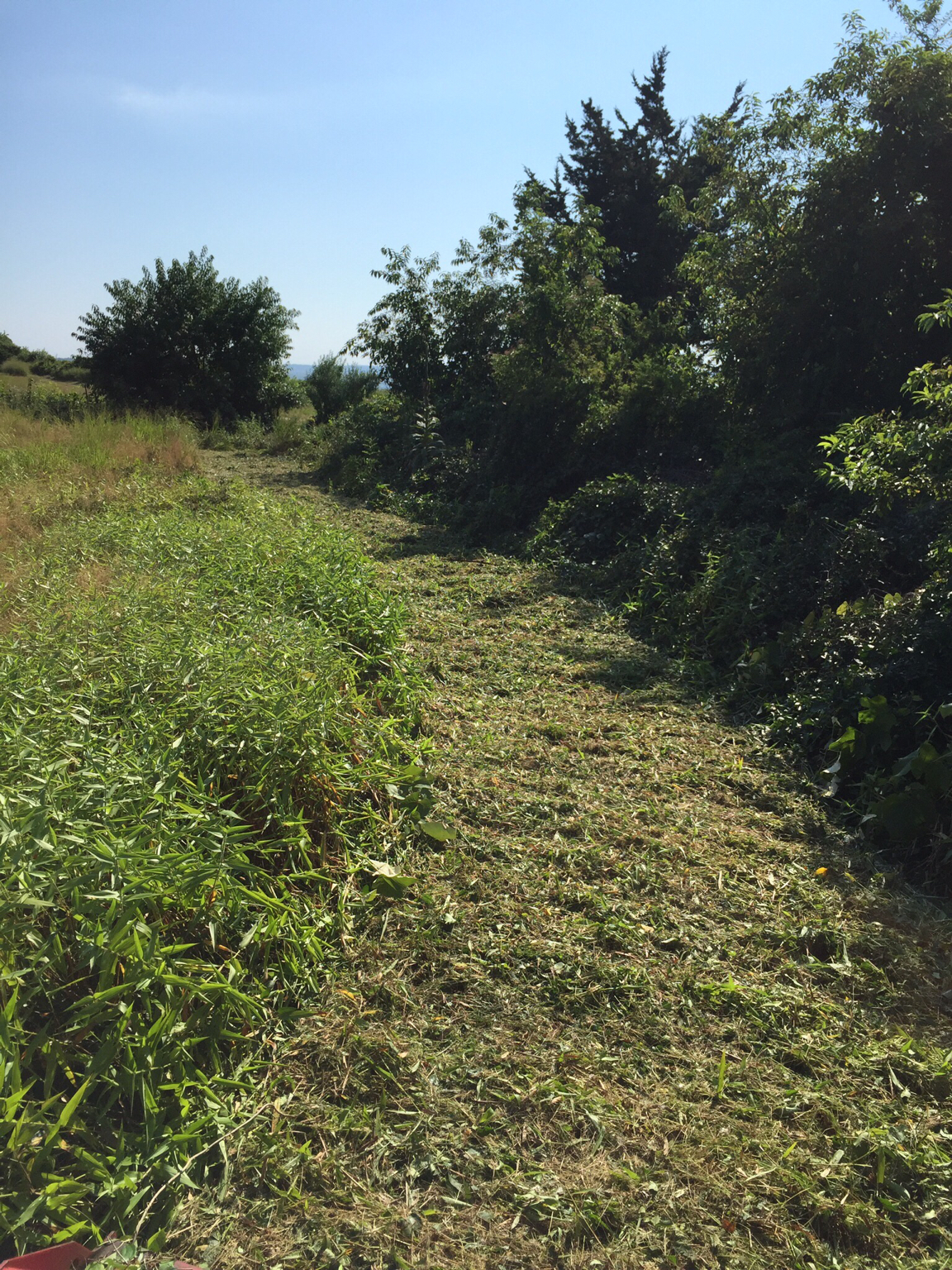

A couple of points to supplement what Leonz posted: I'm the one who keeps talking about breaking Caroni clevises but you need to appreciate that I mow in coastal Rhode Island where glacial rocks and shale are annual crops. If your soil isn't rocky then the standard Caroni clevises are fine.
Regarding cost of Caroni versus other Italian flails, for a given duty rating (simply measured by weight per foot of cut) and considering the cost of extras like hydraulic side shift (nice but not necessary) I think an important reason for difference in price is that AgriSupply buys big batches directly from the manufacturer. I'm pretty sure the smaller dealerships selling other similar Italian flails are buying either in smaller quantities or more likely buying from a middleman who takes a cut. Think of AgriSupply as Costco compared to mom and pop dealerships.
The last point is that the difference between the Caroni TM and TL flails is both the type of blade mount, (direct bolt to blade or bolt, clevis, blade) and that the direct bolt to blade rotor has about double the number of knives. The TL is a true finish mower (think soccer or baseball field or big lawn) while the TM is more for pasture/brush. The TM gives a very good cut if used regularly but can also handle a pasture that is cut just once or twice a year.
Photos show TM1900 giving annual cut.

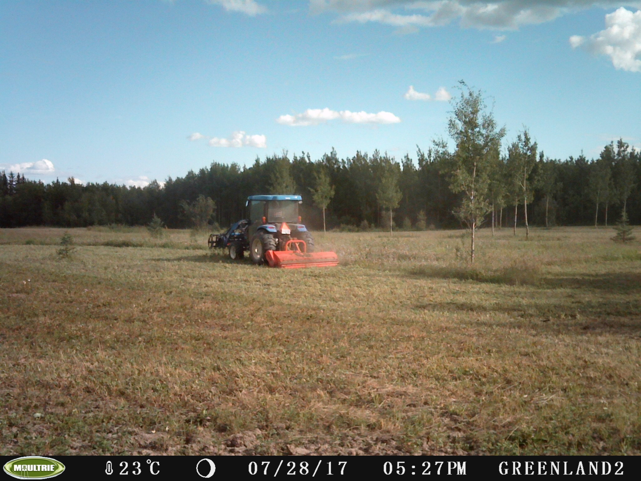

A few picks of a portion of the 40 acres I mow starting near the end of July. I used to do this with a tow behind my quad rough cut. The tractor and flail are far more enjoyable.
