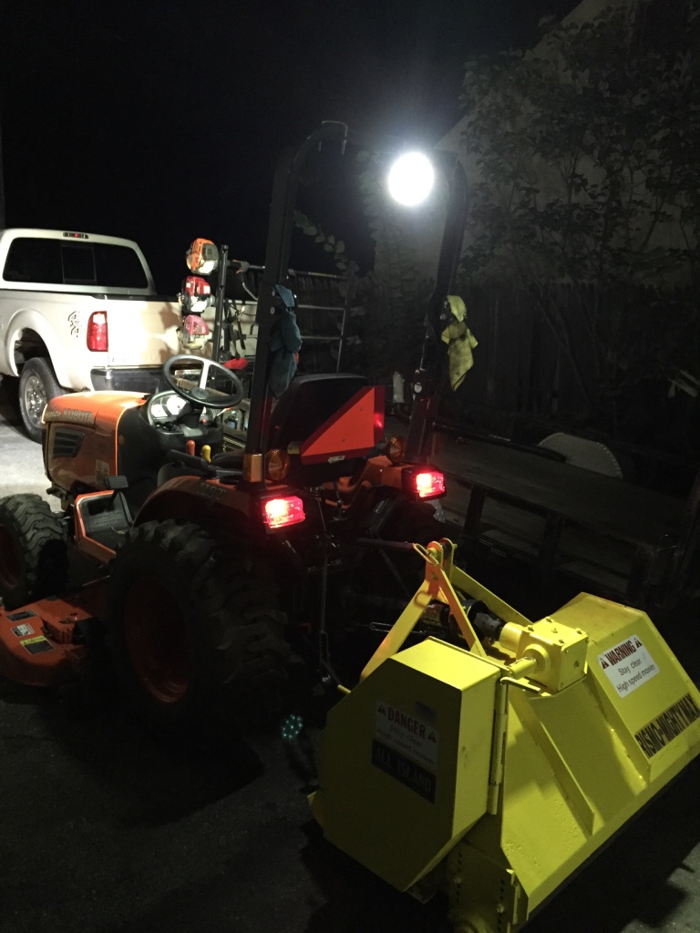

Here's a picture of my old 4-foot Vrismo Mighty Max. Very heavy for its size but it has mowed a huge amount of tall grass behind my small B2920, and I've even used it behind my larger L4310.

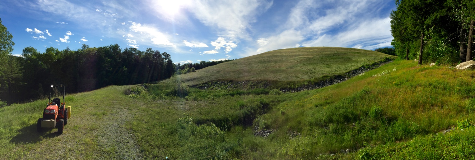

And one more pic showing a section of the sloped field this small tractor and flail mower combo has done many times...thumb_IMG_1946_1024.jpg
And one more pic showing a section of the sloped field this small tractor and flail mower combo has done many times...View attachment 518836
I almost bought the MightMax as it was a solid unit. Found out also these are made here in the USA while their MiniMax line is made in China. If you are mowing a lot with a small tractor these look like the strongest unit I found.
Major disappointment if the Minimax is actually made in China. I've had my eye on the Mini because of the lighter weight and my intentions of mowing only pasture grass with it. The light weight was an advantage to me on my hilly terrain. Now I need to find out for sure because I don't want to pay the premium price for one made in China. Thanks for the heads up if it is true, Iberian.
