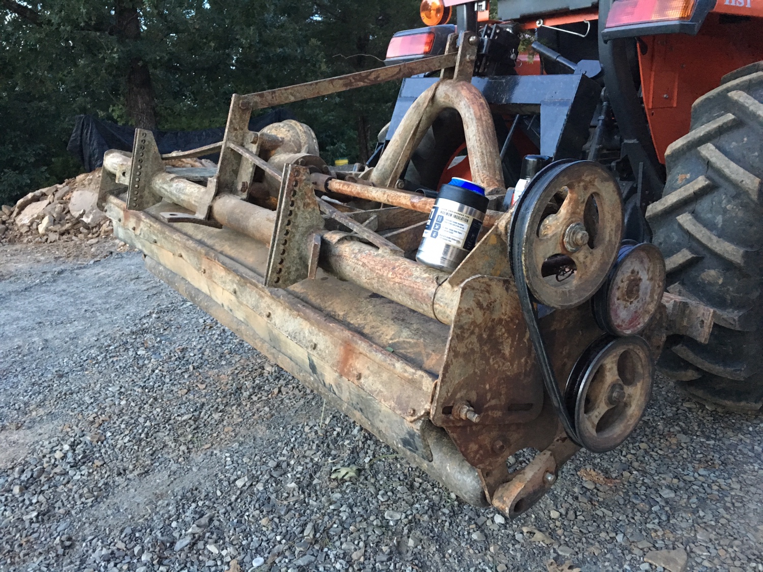

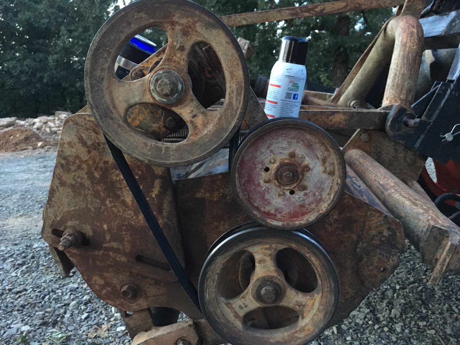

Guys, I think my belt has stretched. Leonz id'd this old flail as a possible Interstator. It is six foot wide.
Anybody want to hazard a guess on the proper size
And brand of belt to start with. I haven't used it a lot since I got it and decided
To work it tonight hard to see if its way try replacing all the blades. Which I think it is.

Looks like the same size sheaves and tensioner as my Mott 72 which takes a C-51 or CX-51 belt.
   / Let's talk flail mowers #4,727
The X is for "cogged" belts. I use them on my Mott but that is my preference as they seem to work better but YMMV.
You might also look into the spring for your tensioner. If it is weak it won't keep the belt tight on the sheaves ... like it was stretched.

I also have a mott 72 with the C-51 belt. I don't think any brand makes a C-51 using kevlar. The smallest C size belt in kevlar is about 70". I might try one of those cogged belts next time and I'm pretty sure I need a new tension spring. Might just add another spring to see if it will help. It's not a big problem but I hear it slipping sometimes.
lennyXZ11 that's a great built mower you have and it's definitely worth putting on new knives if it needs them. I've tried different brands of belts on many different mowers and I can't tell that much difference in any of them except the price. The better known the brand is, the more expensive it is. Kevlar belts are better for certain situations and I use them whenever I can find the size, but C-51 is not one of them.
