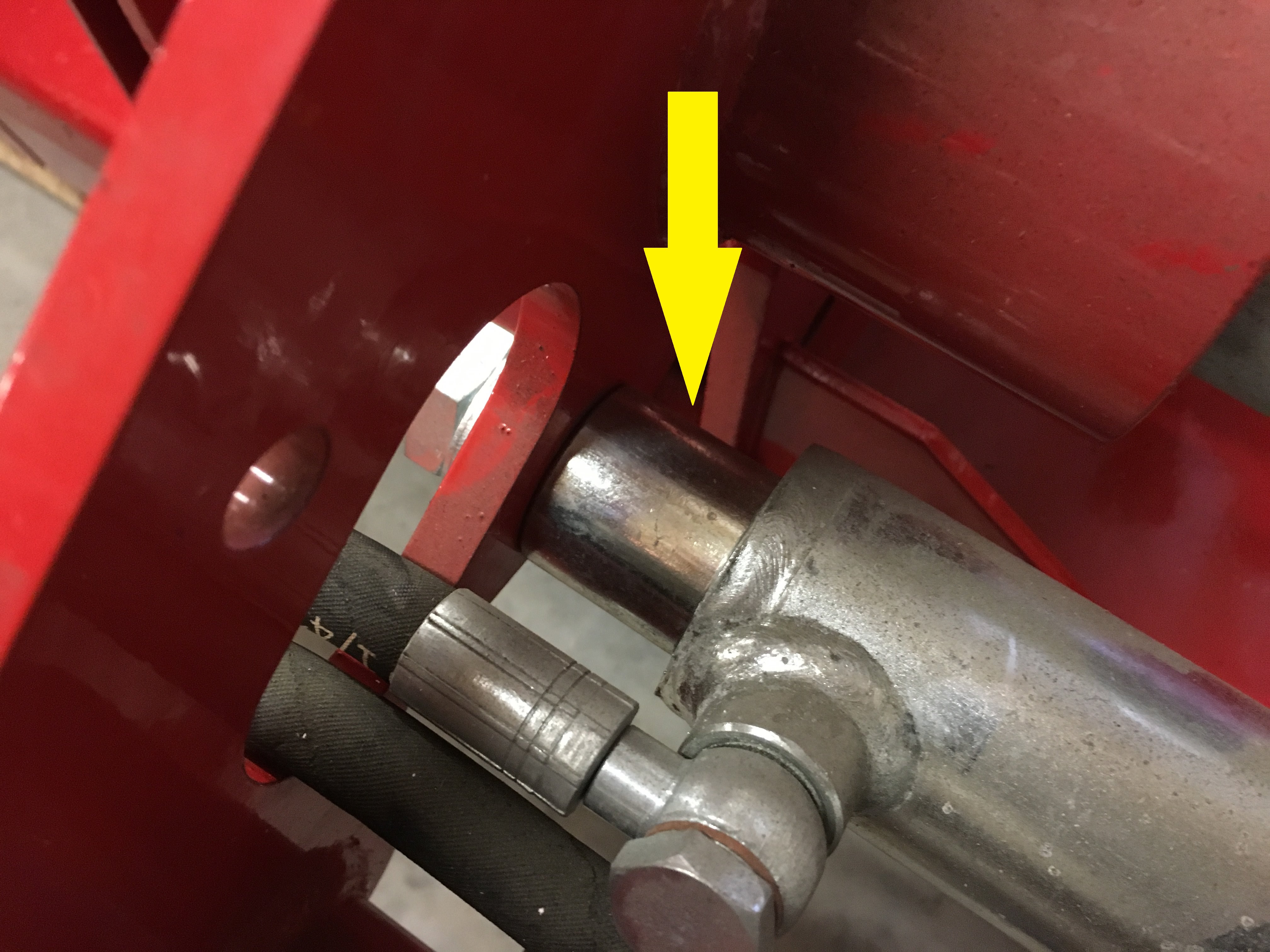

I have a question, why the cylinder is not parallel with the two track? I think this could make big noise when it is moving.

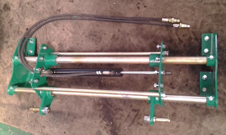

Well I finally have time to start getting the side shift kit onto the TM1900. The "directions" (if you can call them that) are TERRIBLE. I am trying to document the process in case anyone else can benefit from it.

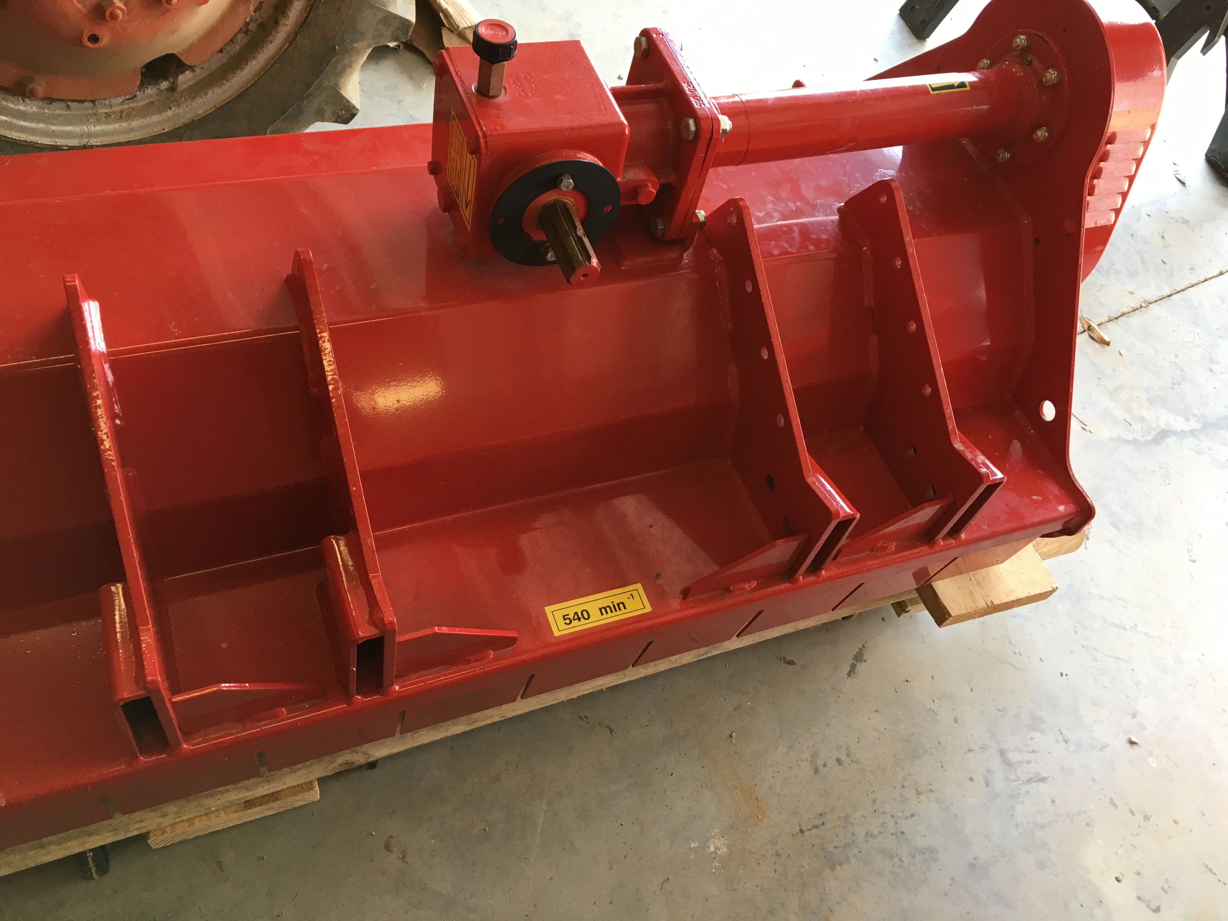

To fit the side shift kit you have to take all the standard hitch equipment off.
This leaves you with the standard top link tower and lower 3pt mounts as spare parts (unless you take the slide shift kit off later).

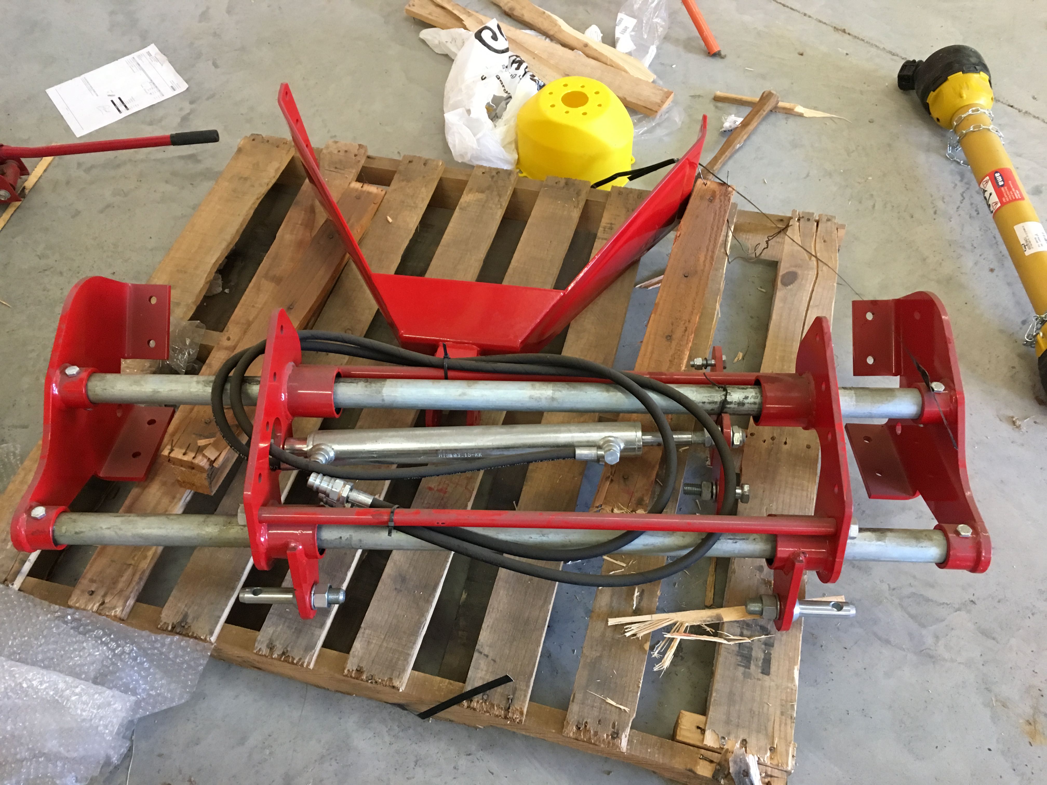

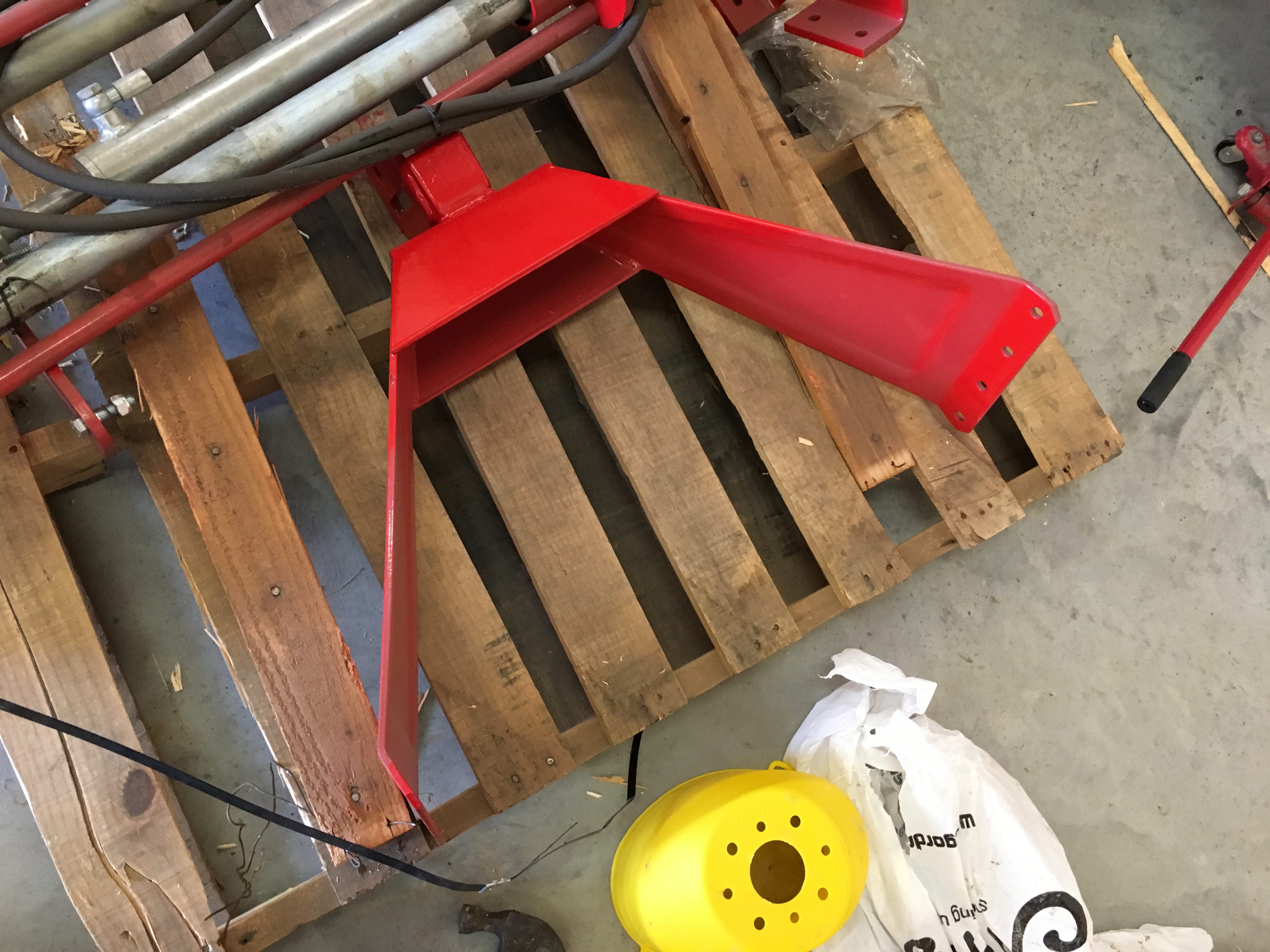

The kit comes with it's own top link tower. It is different from the standard one

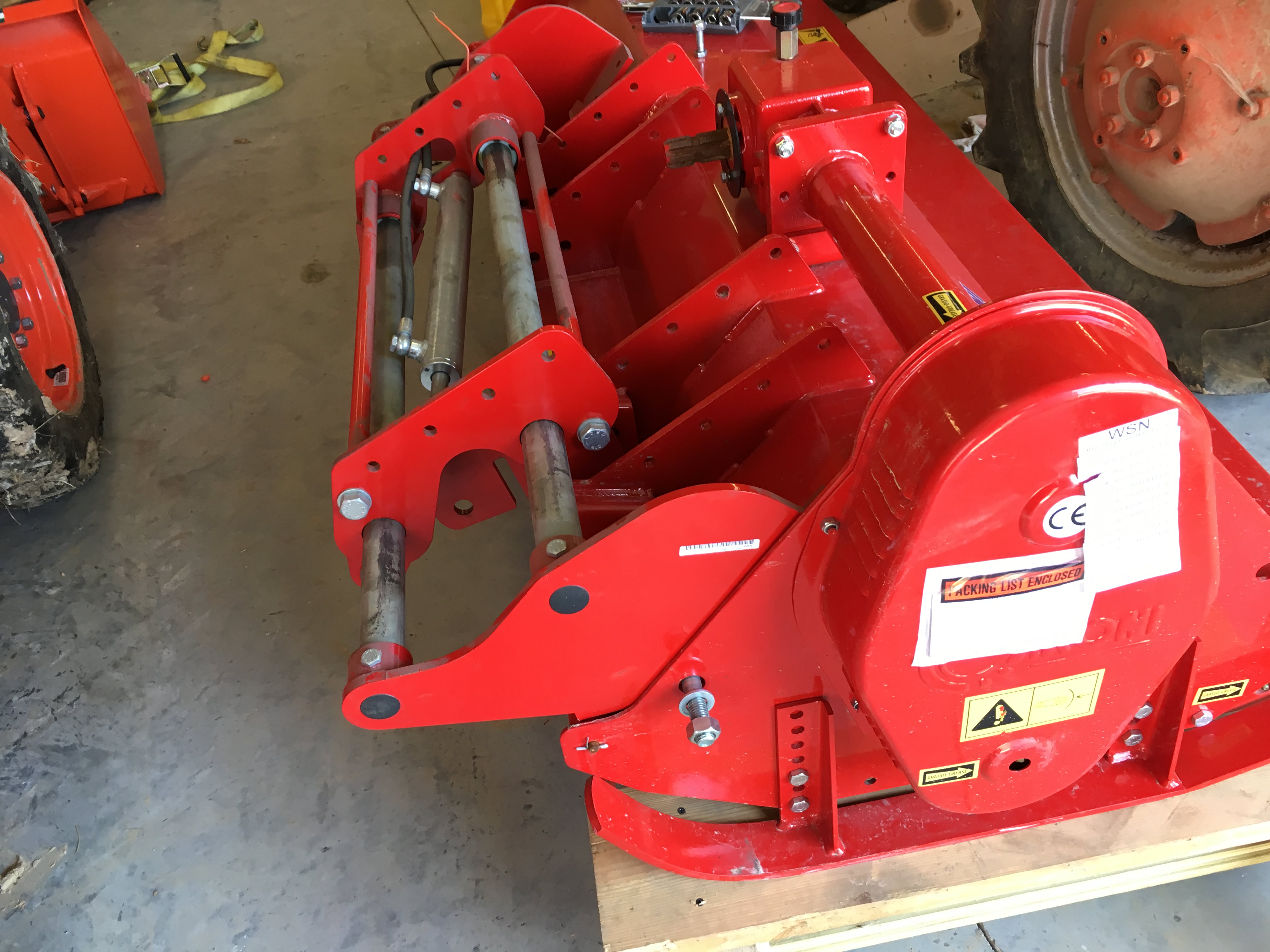

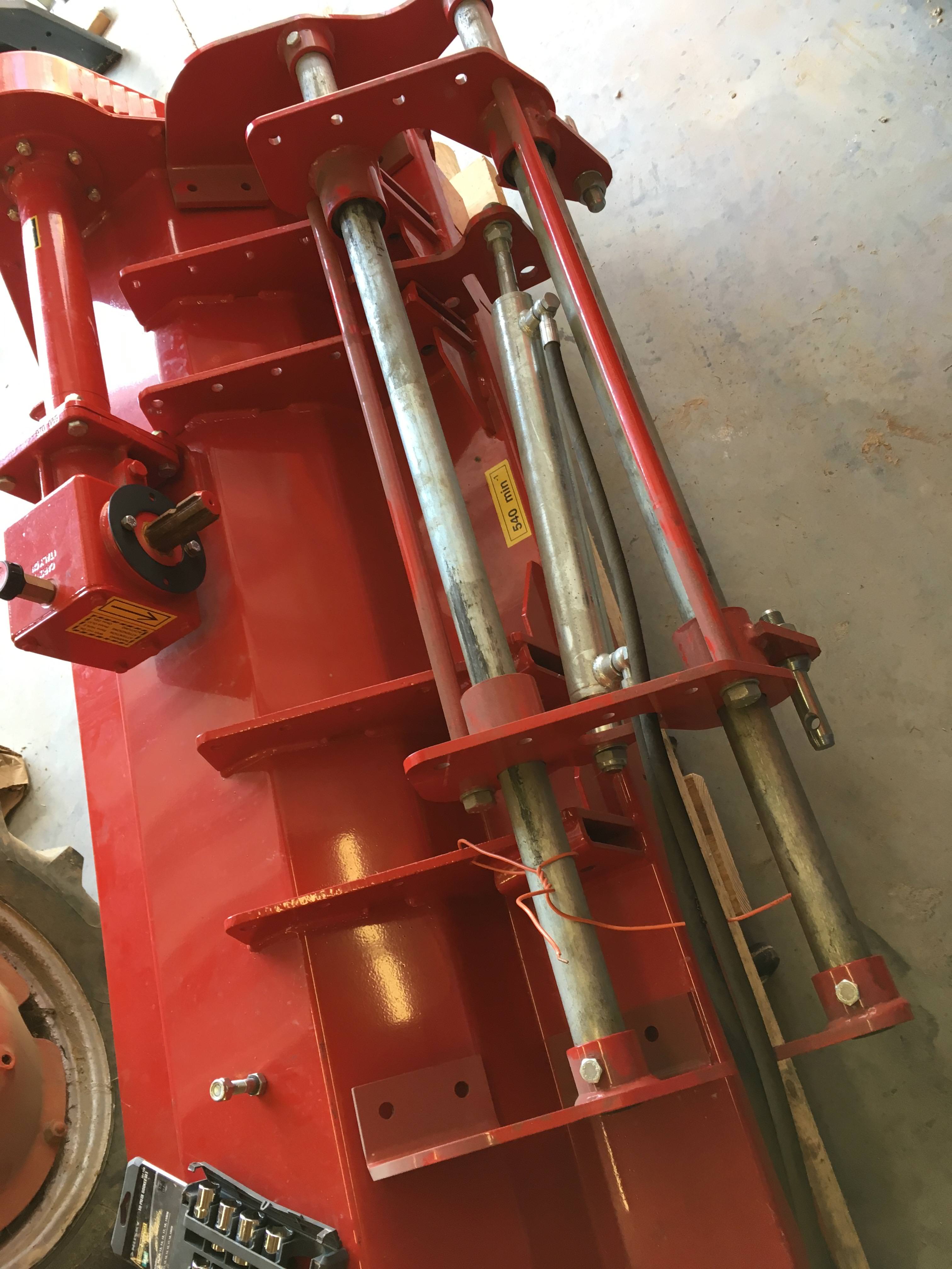

I dry-fit the side shift assembly on top. It's held on by a bolt and some wire. The cylinder mounts aren't lined up in this picture, so it won't normally be cockeyed.
One thing I didn't realize was that holes need to be drilled to mount the kit. I'm not looking forward to that. That's the next step, for another day. There are spacers that need to be inserted on the cylinder assembly, but I haven't figured out exactly how many or where. Different spacing is required for rear mount or front mount assembly, and the instructions aren't clear.

One thing to watch out for when drilling the holes is that you have everything "square, level and plumb".
Initially I didn't and a slight out of squareness caused considerable binding when shifting to extreme right.
I had to "oval out" a couple of holes, assemble barely snug then shift out to allow everything to settle "where all the tolerances tolerated each other" then really tighten things up.

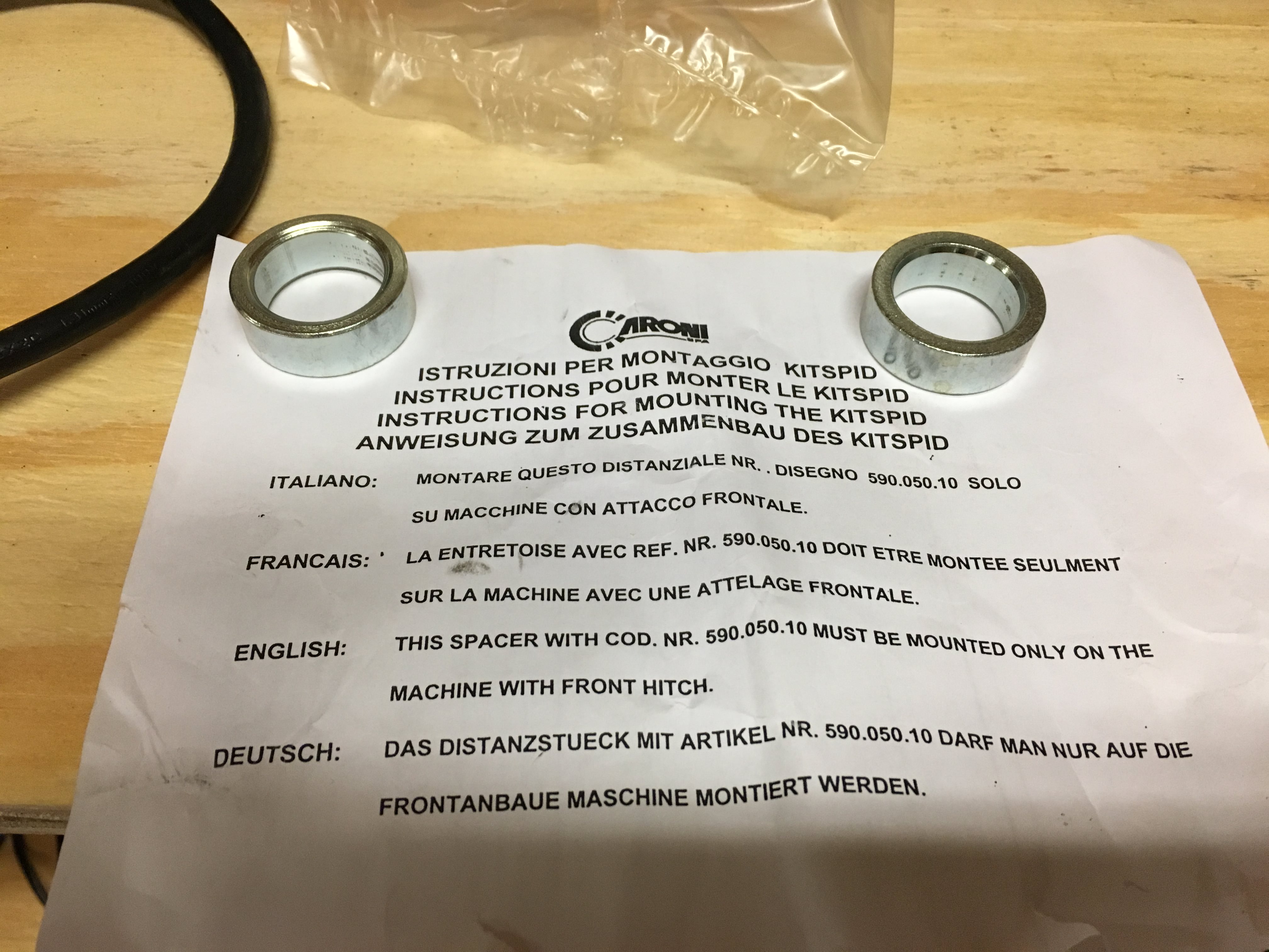

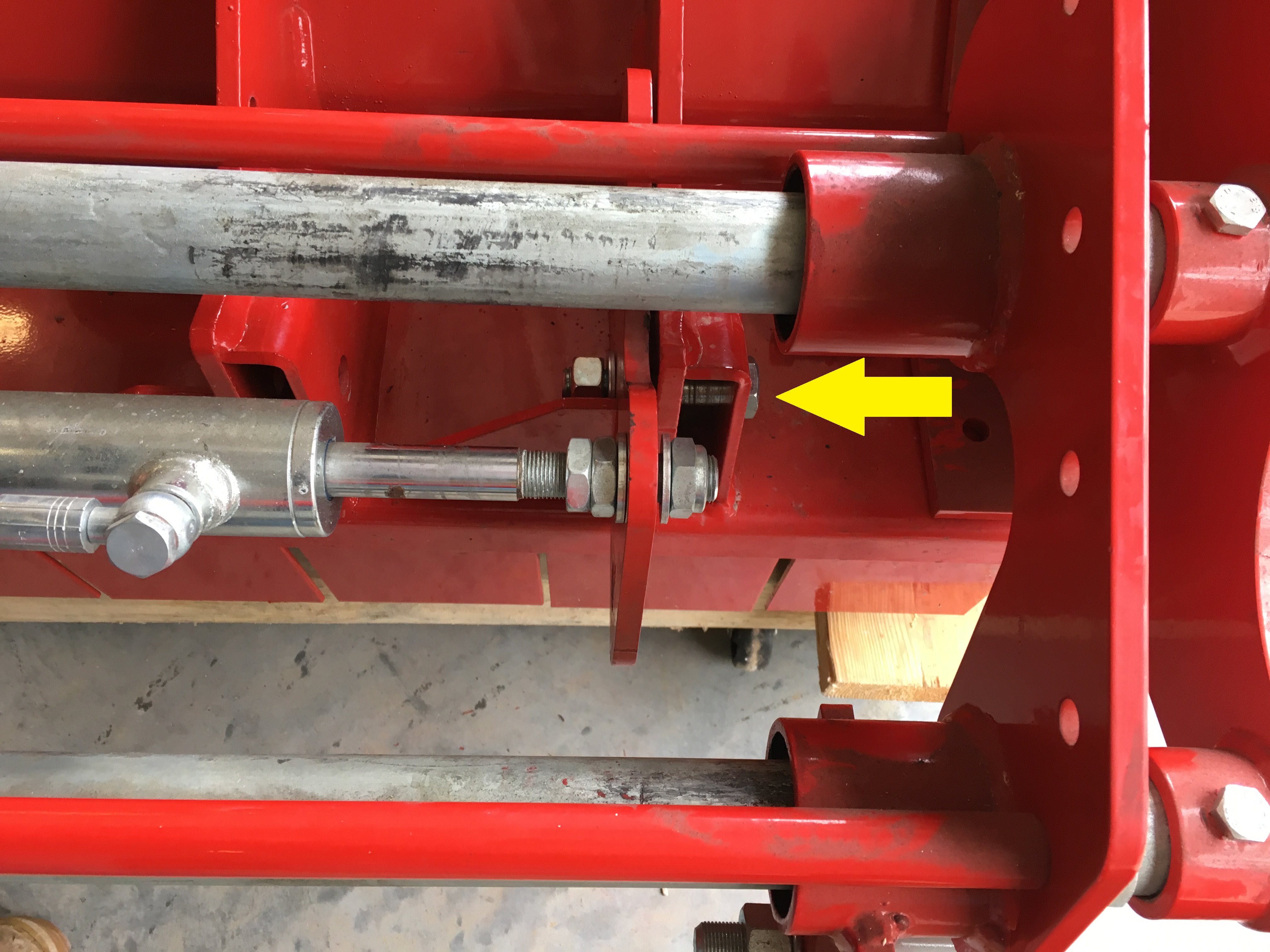

I got a little bit more figured out today.
In order to mount the strike plate for the hydraulic cylinder, I had to do some grinding on one of the welds where the 3pt link arm attaches. After that, the bolt holes lined up and the M18 bolt fit in fine.
I finally realized that the spacer the installation instructions were referring to was already installed.
The smaller spacer is only required for front-mounting. I don't know why I received two of the smaller spacers.

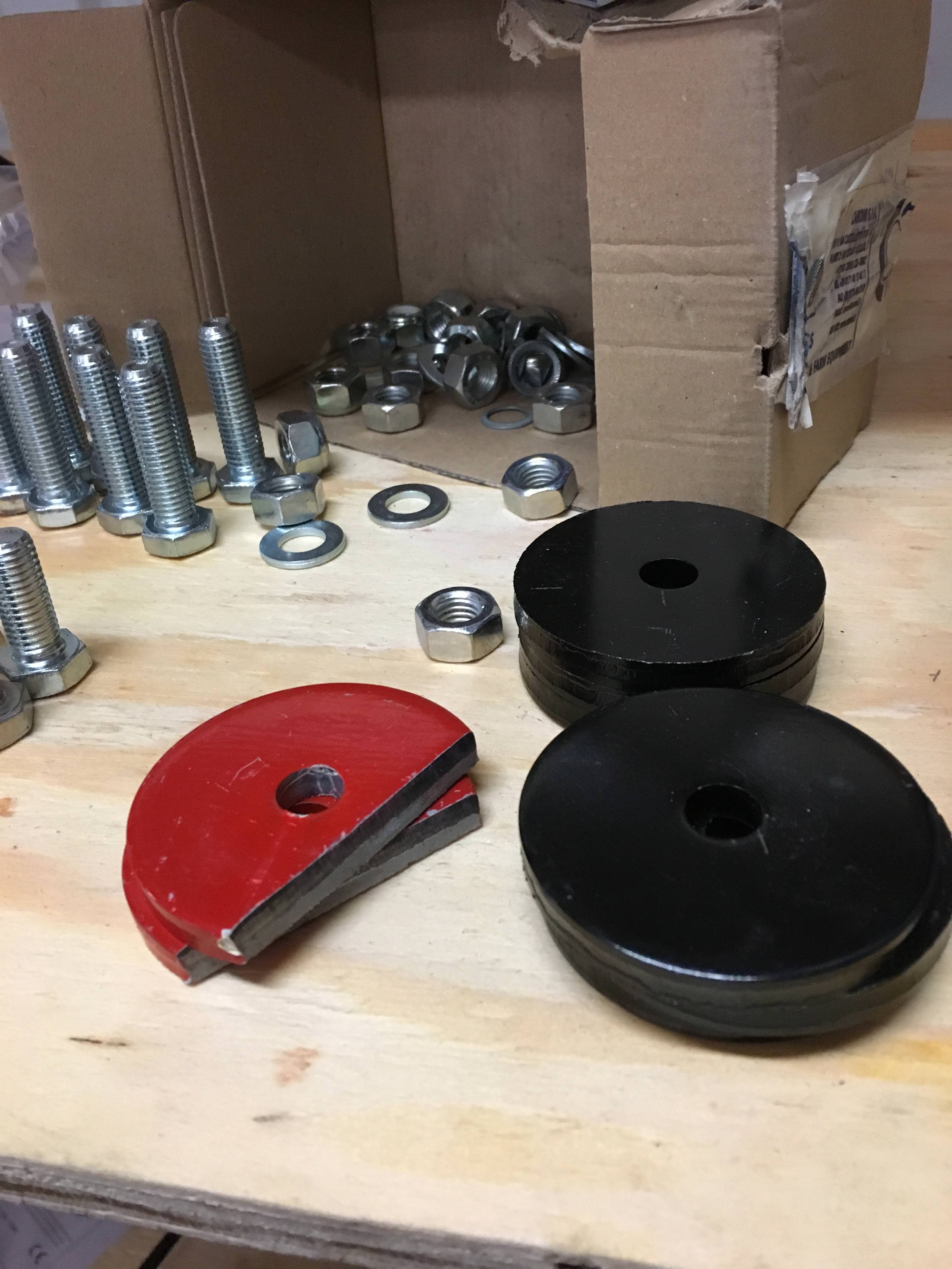

Here is the box of bolts and misc parts. I finally realized that the red and black discs are not spacers. They are heavy-duty washers to be used on the inside of the flail mower after drilling bolt holes. The two red ones are clipped because full sized discs won't fit with two of the holes.

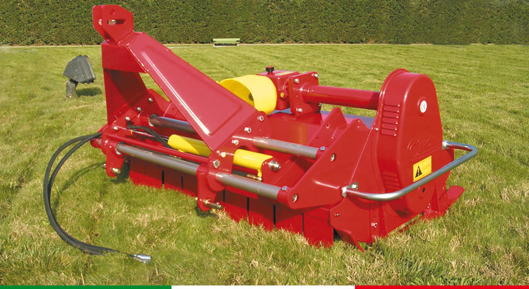

Here is another picture of the Side shift kit installed at the Caroni factory in Italy
