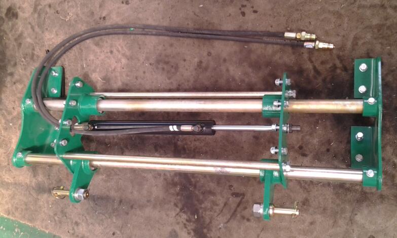

I have a question, why the cylinder is not parallel with the two track? I think this could make big noise when it is moving.
It should be parallel like this.View attachment 543410
Jack, yes absolutely! I had it off in my original picture and mentioned that in my post: "The cylinder mounts aren't lined up in this picture, so it won't normally be cockeyed."
When mounted it will be parallel, thank you for checking!

One thing to watch out for when drilling the holes is that you have everything "square, level and plumb".
Initially I didn't and a slight out of squareness caused considerable binding when shifting to extreme right.
I had to "oval out" a couple of holes, assemble barely snug then shift out to allow everything to settle "where all the tolerances tolerated each other" then really tighten things up.
YMMV etc.
Thanks for the warning! I'll make sure to keep things lines up as best I can. At this point I plan to drill out the top left and bottom right holes first, then tighten them down and drill the rest.

You have to flip the side shift kit over to mount it in the 3 attachment holes that correspond with the three holes in the side shift kit on both weldments on the flail mower shroud.
I will have to get in touch with Rodney Barbour about this.
Sorry, not sure I follow. Are you saying I have the whole thing upside down, or spun 180 degrees? There are absolutely zero holes on the surface of the mower, so I can't imaging not drilling holes and getting this thing mounted.

If you can rent a mag drill(drill press with a magnetic base) you will have a much easier time of mounting the side shift attachment that will help you 500% in assembling it as the magnet on the drill press will hold it in place with no effort and the drilled holes will be perfect.
Once you have the holes drilled I would definitely want you to use red Loctite to secure the nuts as tight as possible.

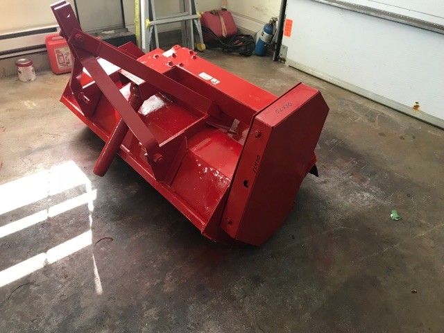

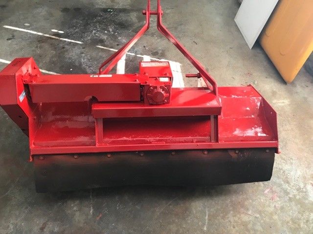

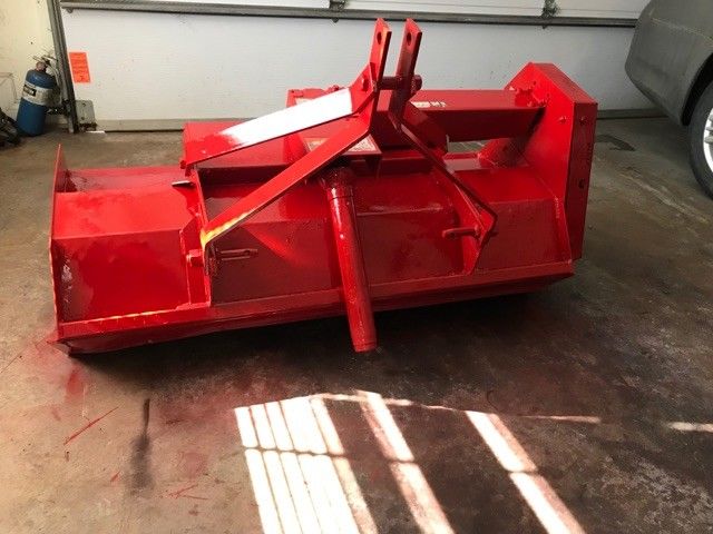

Looking for some advice. I've been looking for something a little more serious than my finishing mower for sometime now. Leaning towards a flail over bush hog.
I have a chance to pick up the following for probably about $600.
It is a 48 inch vemco according to the ad.
Google didn't net me many results in terms of reviews or durability.
Does anyone here have any experience with Vemcos, and perhaps what should I look for when I go to look at it?
I appreciate all of your time.
Thank you,
Nate

Hello Nick,
For $600.00 I would want to run it on your tractor long before I wrote a check or offered cash. The fresh coat of paint and not having a complete drive shaft is an almost automatic no sale for me.
If you really want to buy it hire farm equipment mechanic from a local dealer for an hour to look at it and buy his dinner for his time.
Do you know what type of knives it has mounted on the flail mower rotor or what condition they are in??
I have a long post on the forum here describing what one needs to look for in a used flail mower.:thumbdown:

Maybe they decided to make it look a little better and the driveshaft was truly lost. Looks kinda fishy though. I'd borrow a driveshaft off another one of your implements and try it out first.

Is this one of your side shift kits that you sell????
As the cylinders stroke is limited by its mounting point and stroke limiter it will travel only a short distance along the XY plane but the bronze bushings if used will be a major wear part.
Hi Leonz,
I used to sell this offset flail mower. You are right, the bushings on the track are the major wear part. This offset kit only has 11inch offset capacity, too short, so I change it into 20 inch now.

That's why I think the seller sold you the wrong offset kit which is not for your Caroni mower. I cannot believe Caroni need customer to drill holes on the mower to assemble the hydraulic offset kit, Caroni engineers won't be so stupid, I don't believe it.
