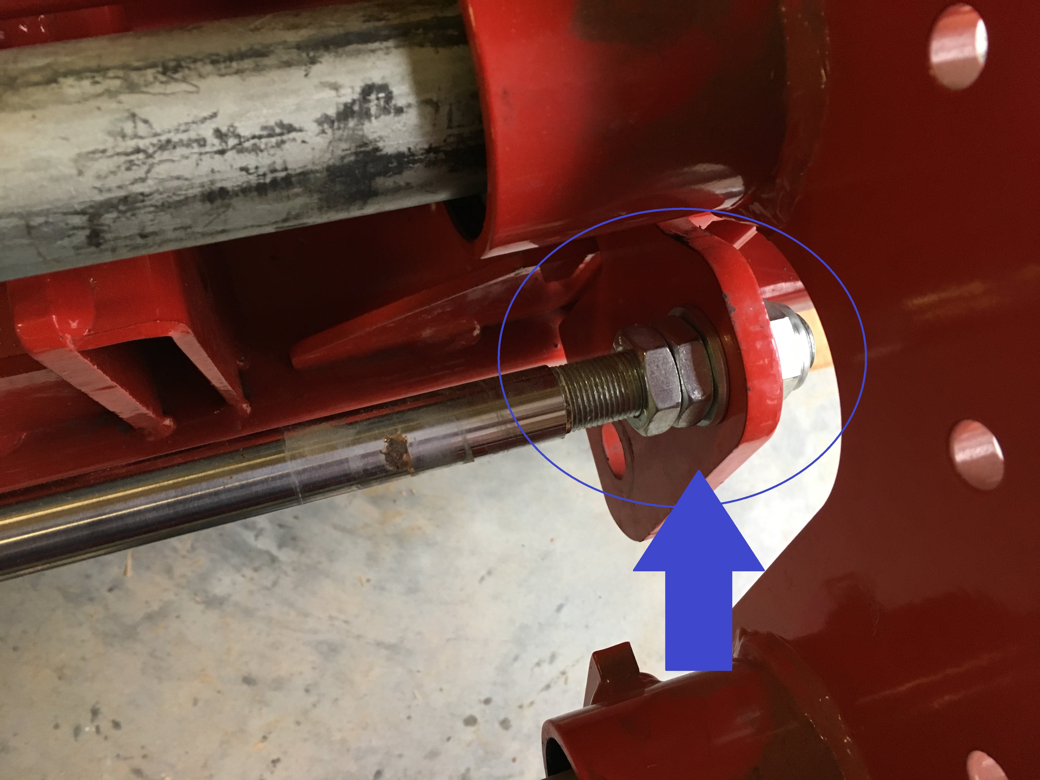

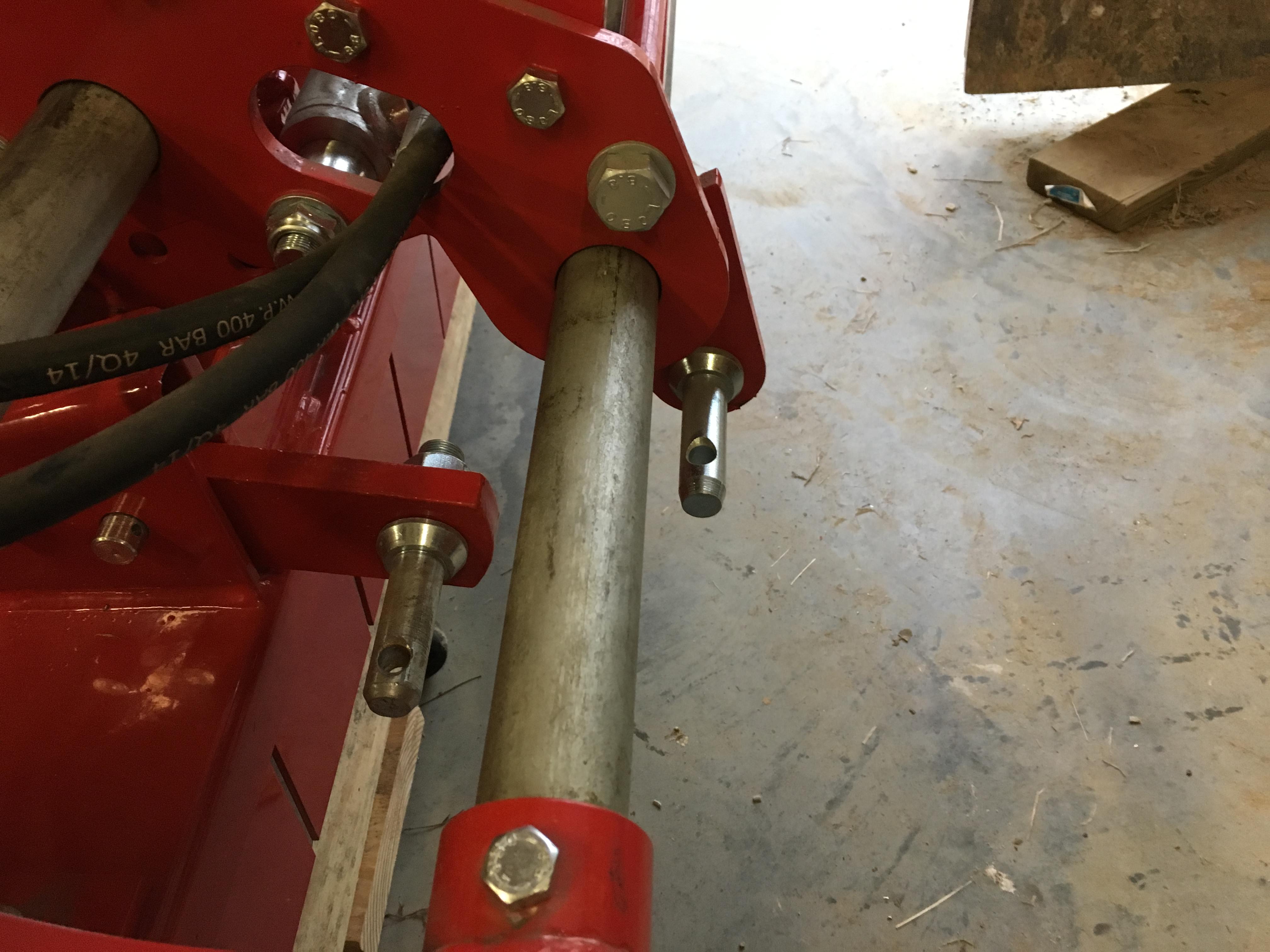

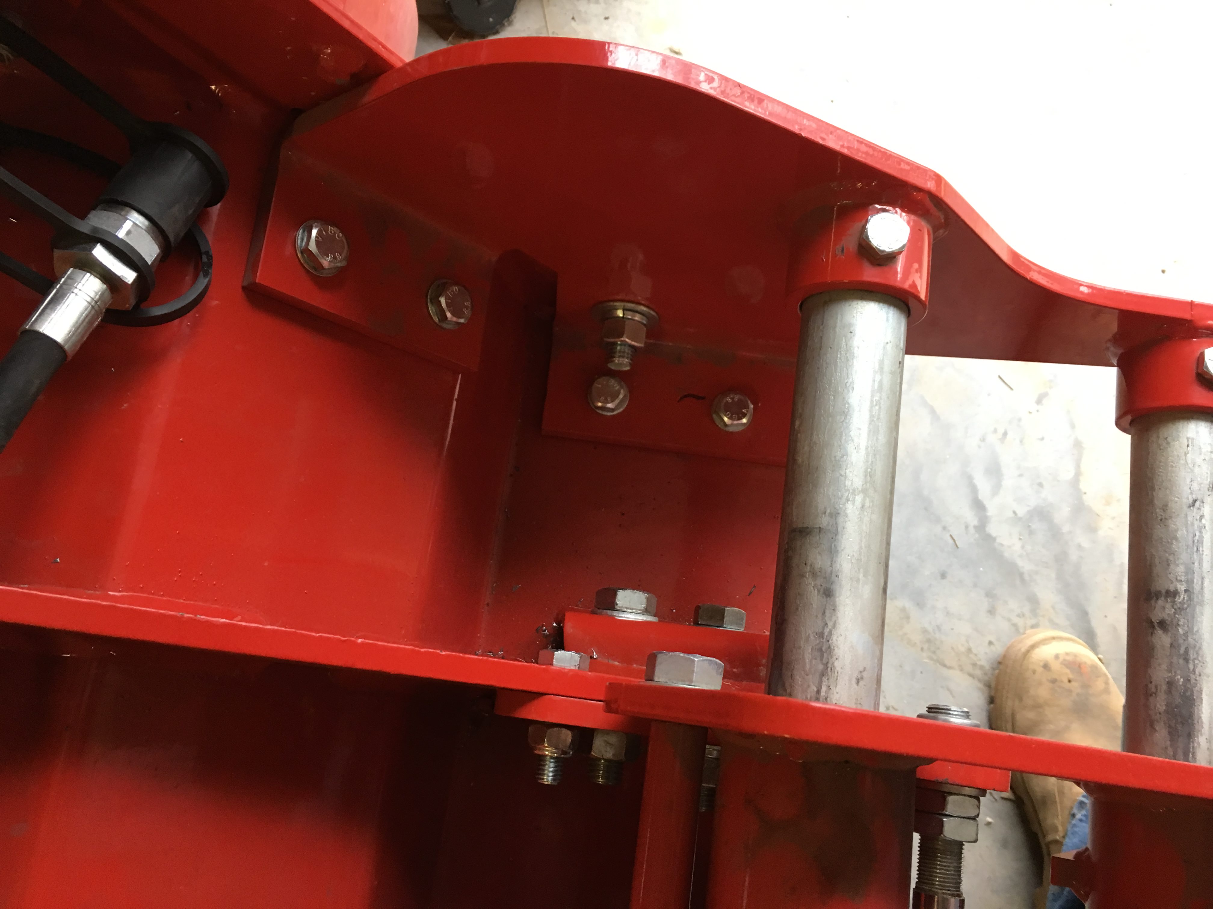

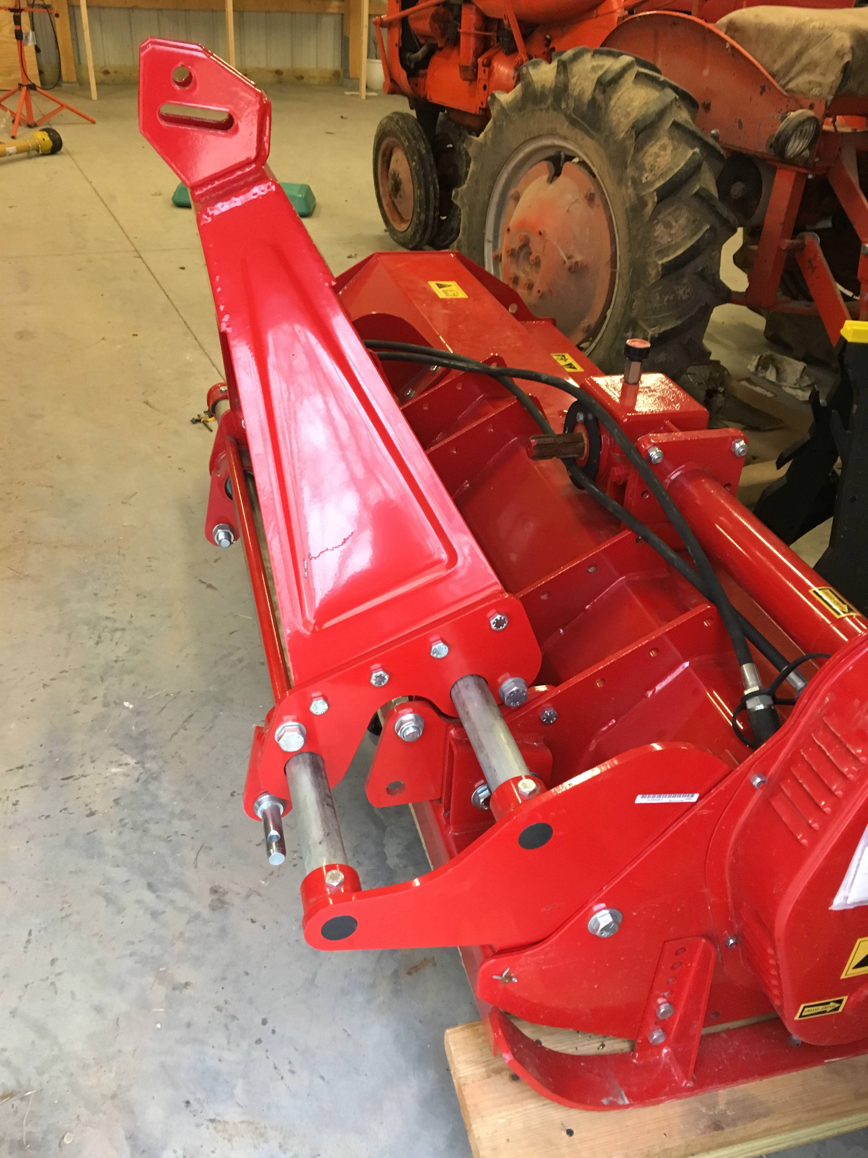

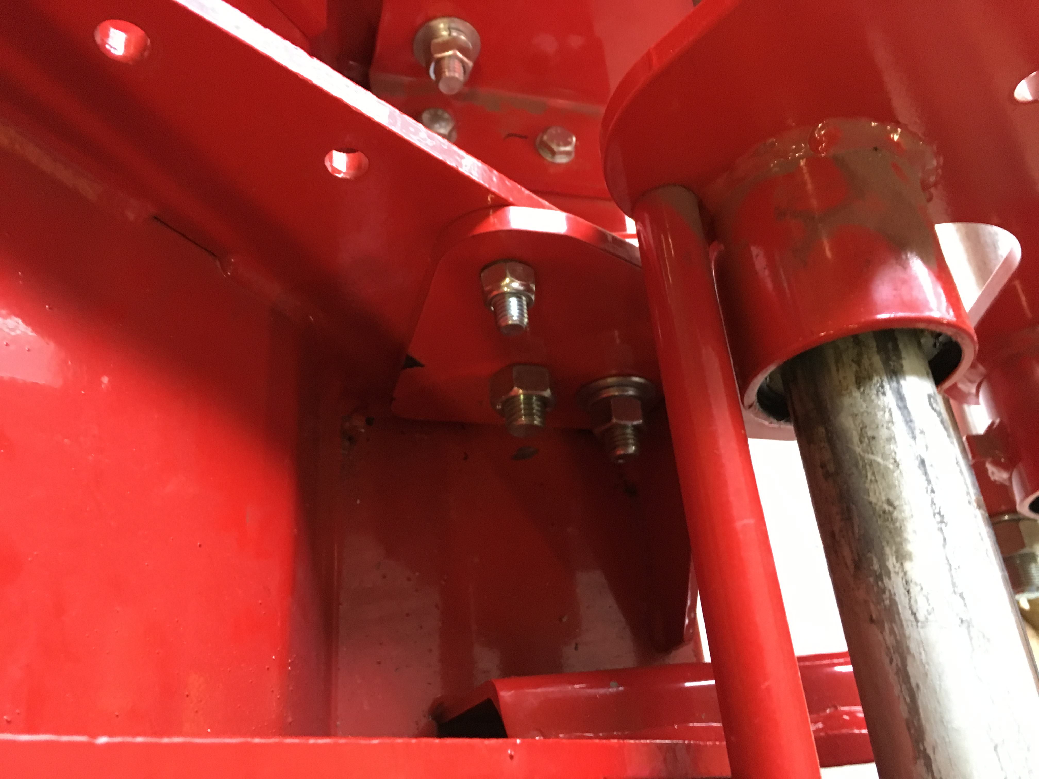

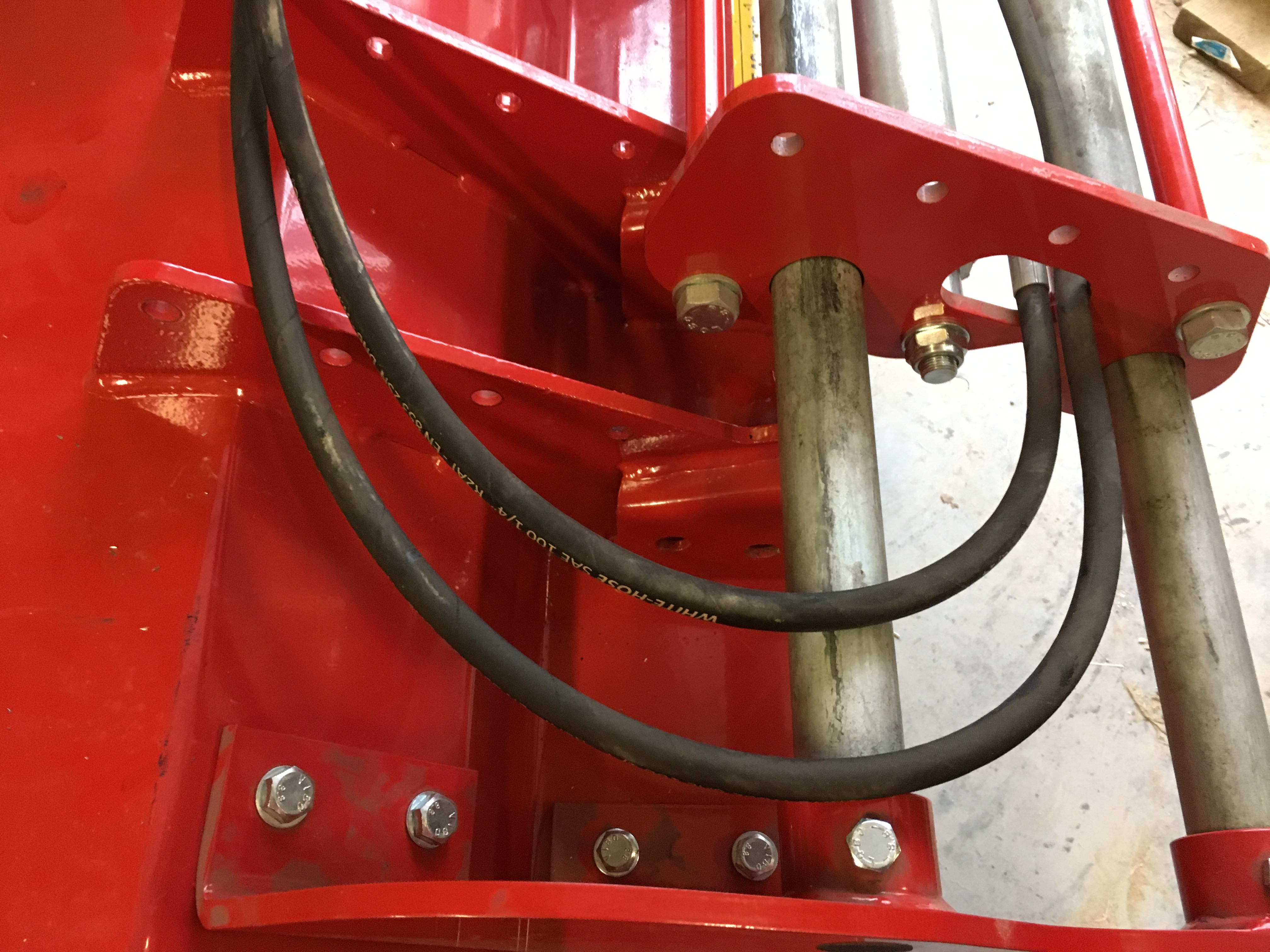

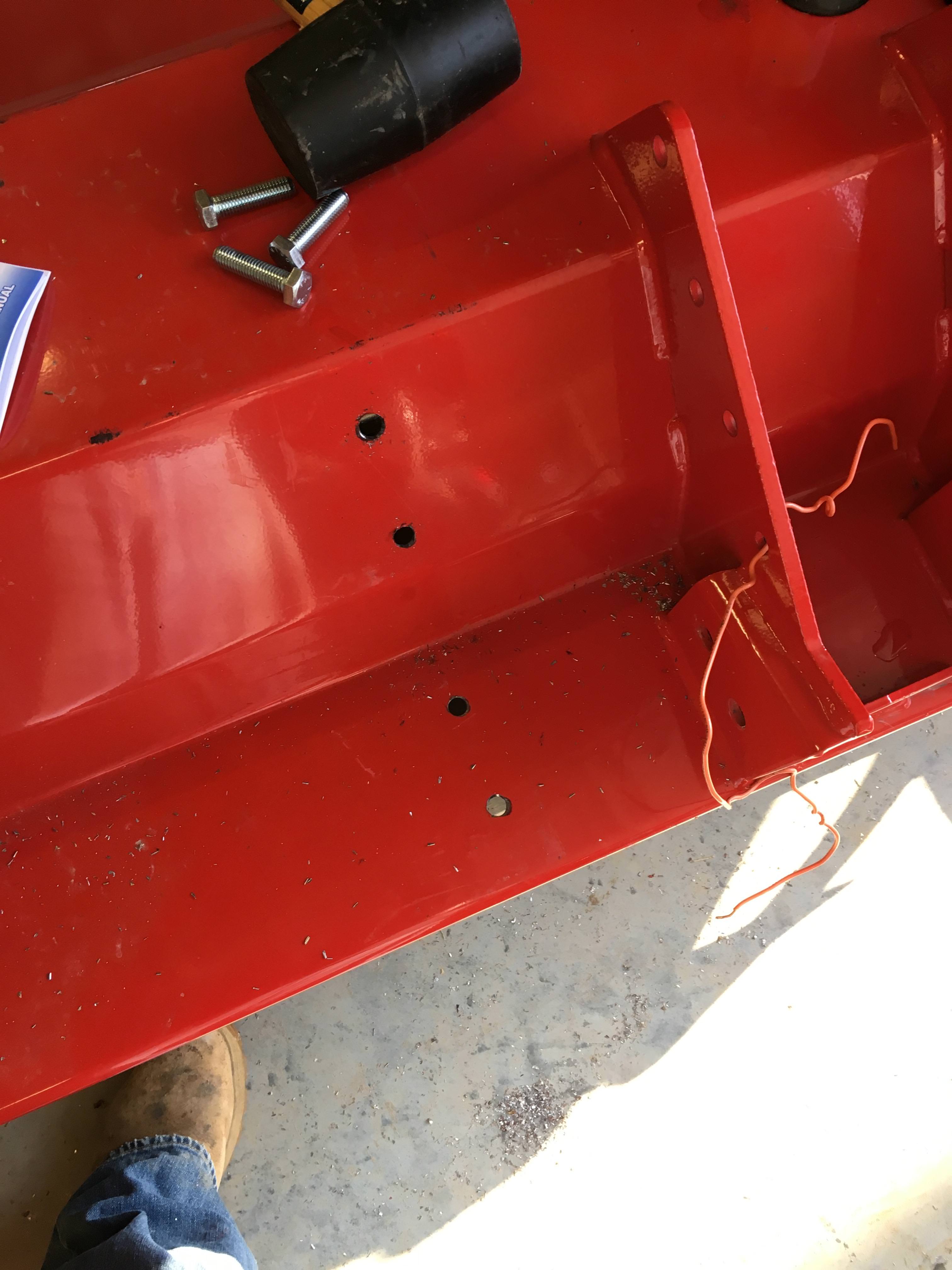

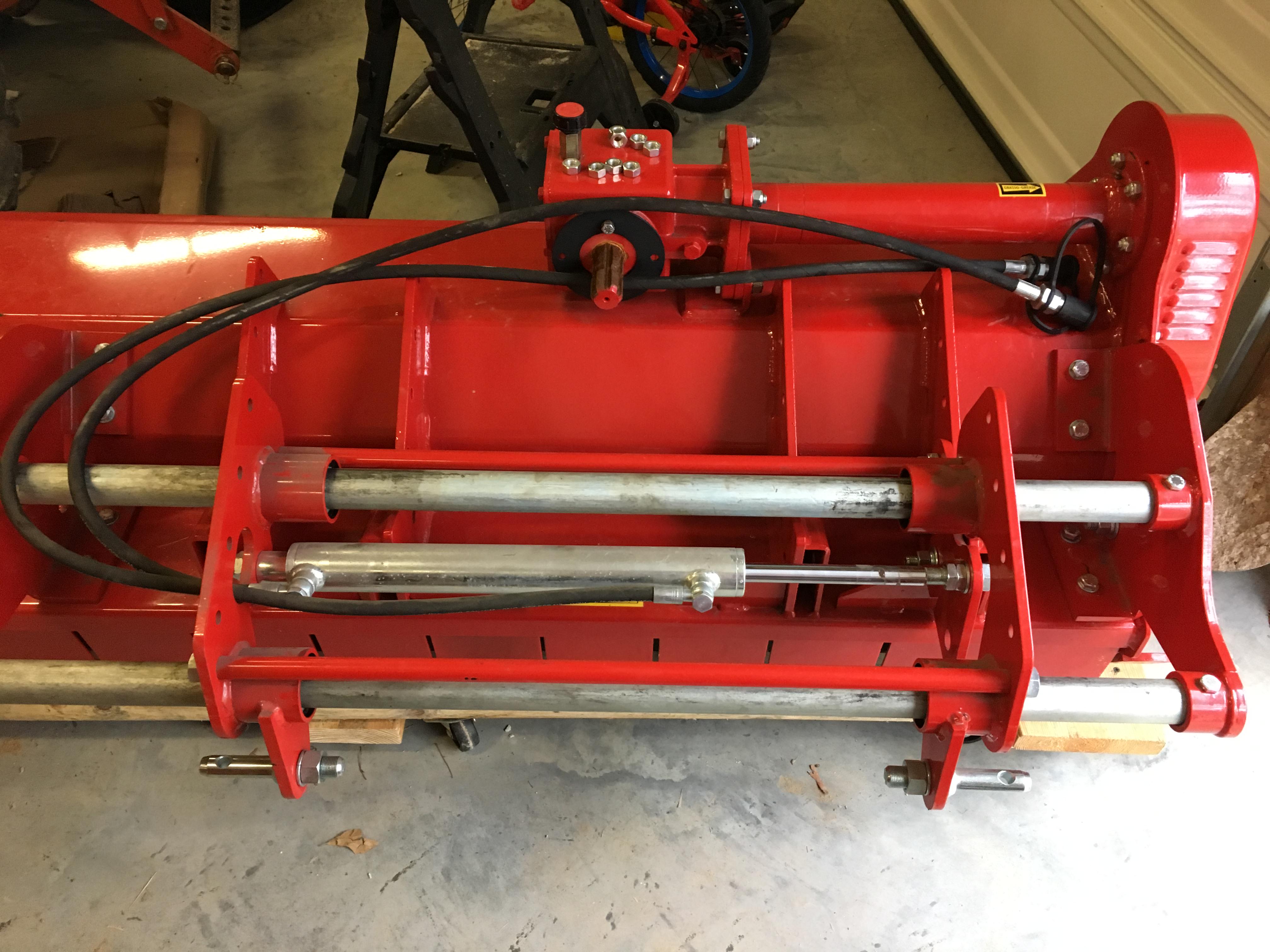

That's why I think the seller sold you the wrong offset kit which is not for your Caroni mower. I cannot believe Caroni need customer to drill holes on the mower to assemble the hydraulic offset kit, Caroni engineers won't be so stupid, I don't believe it.
Jack, I was definitely disappointed, but I can understand Caroni not wanting to pre-drill holes on all units when 95% of them will never see a shift kit.
I made some good headway last week.

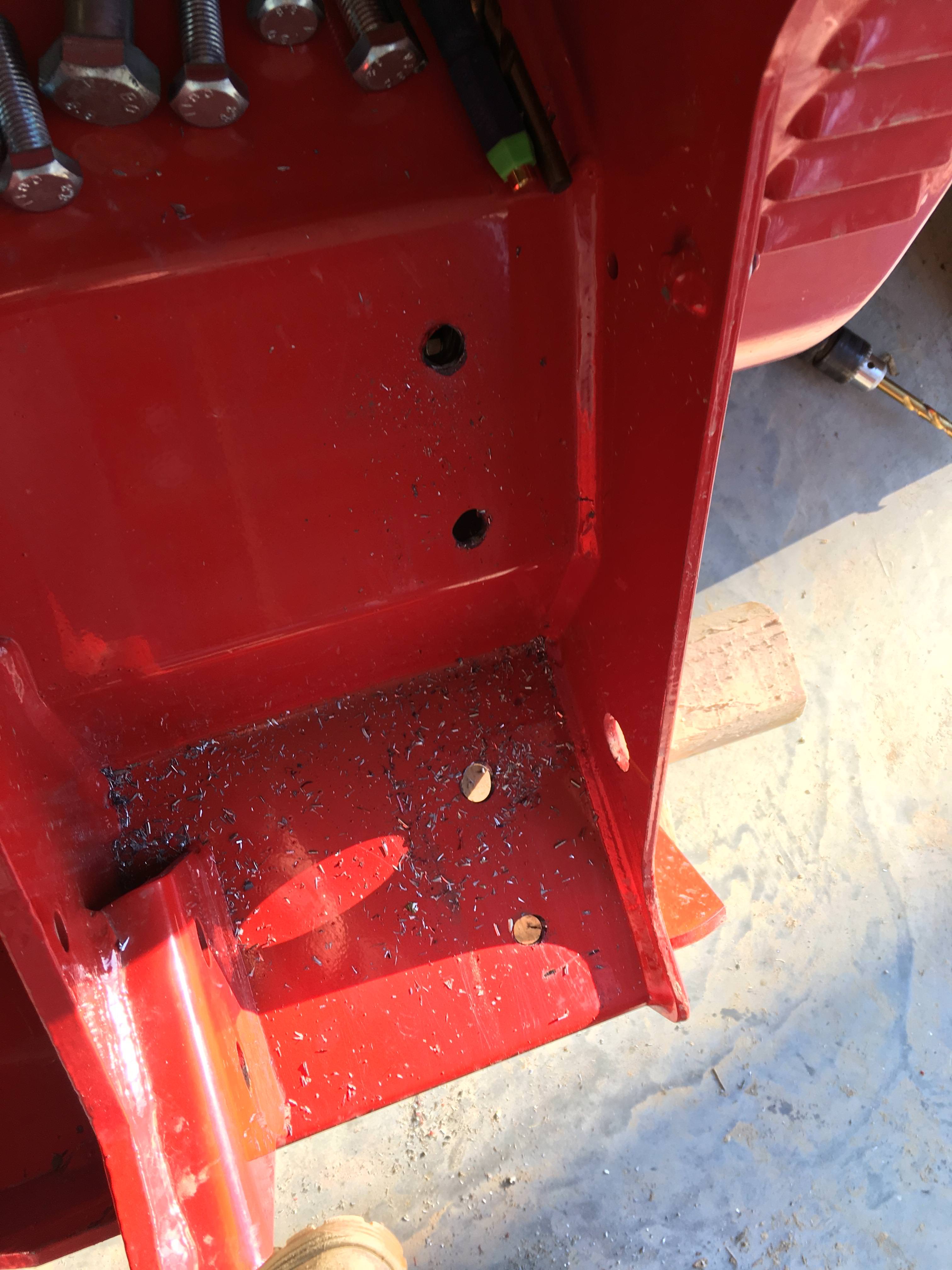

Holes drilled.

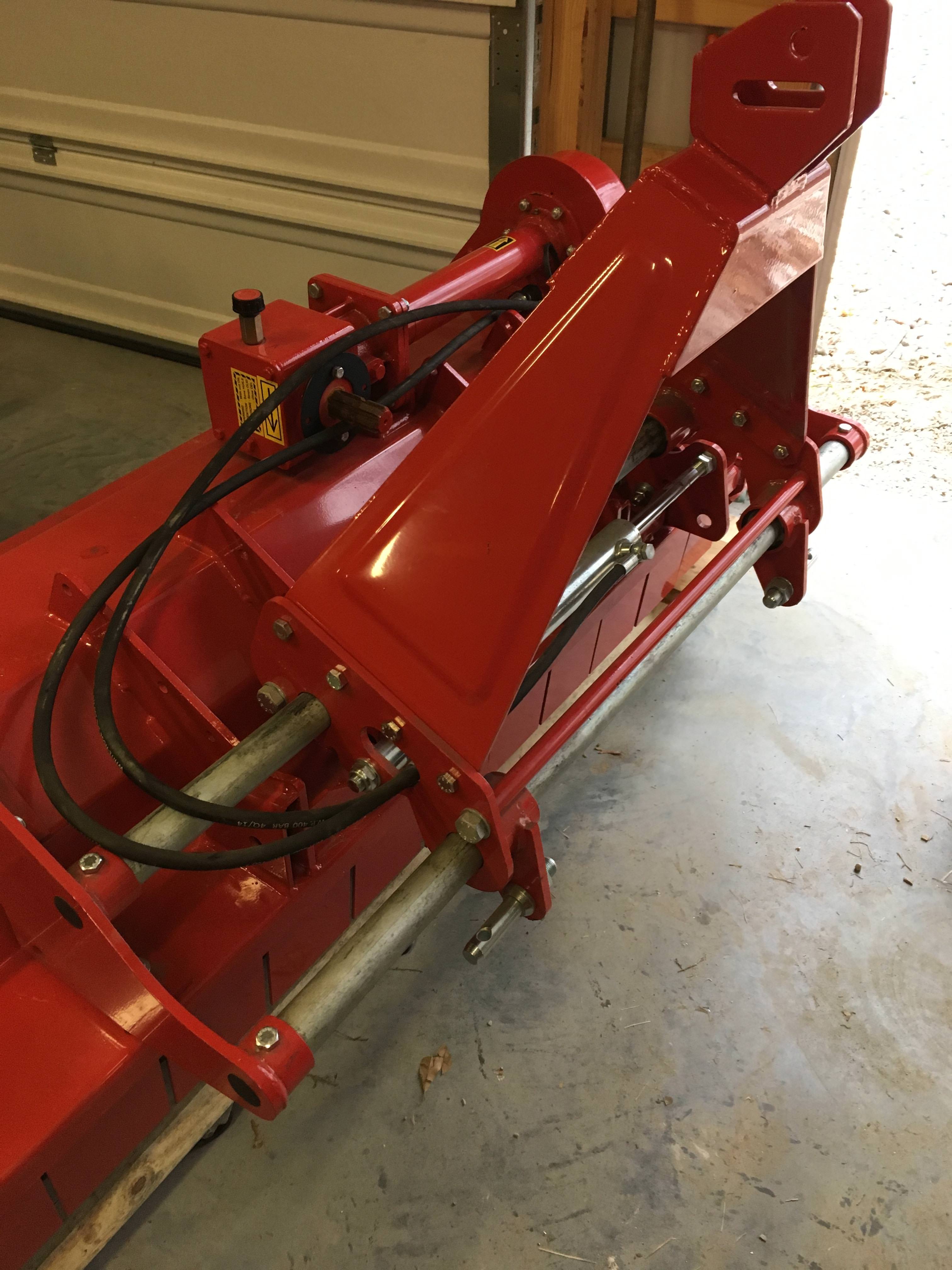

Assembly finally mounted!
In my previous post I showed the huge washers to put on the inside of the mower. Two of them were red, and clipped. I ended up needing to clip two more of them to get everything to fit properly. On each of the two columns of holes, the bottom and second from the top holes required clipped washers.
Starboard side bolts.
Port side bolts. The horizontal bolt you can see at the top of the picture was not included in the kit. I added it since there was a hole there anyway. If you get side guards for the mower (like in this picture https://www.europages.com/filestore/opt/product/96/38/Trincia_e_b920e9cf.jpg ) one of them will bolt through that hole.
Strike plate attached. The Kit came with only the top and bottom left bolts. I added the bottom right since there was a hole there anyway.

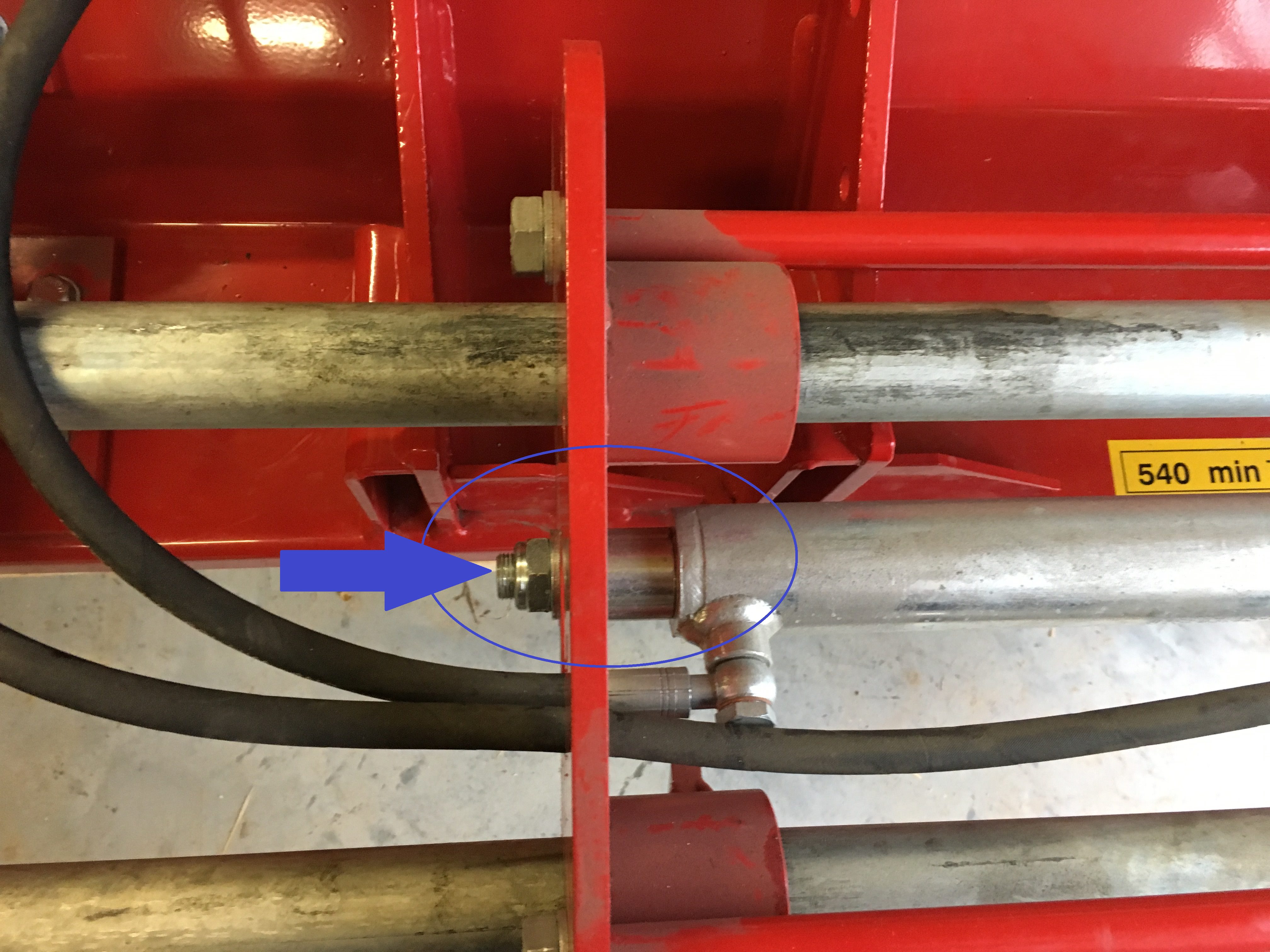

The hydraulic cylinder was pre-assembled on the assembly, but there was a centimeter or two of slack in it. I'm assuming this was to allow for easier mounting. Once I had the assembly bolted onto the mower, I tightened this end to remove the slack on it.
Then I adjusted this end to get rid of the remaining slack.

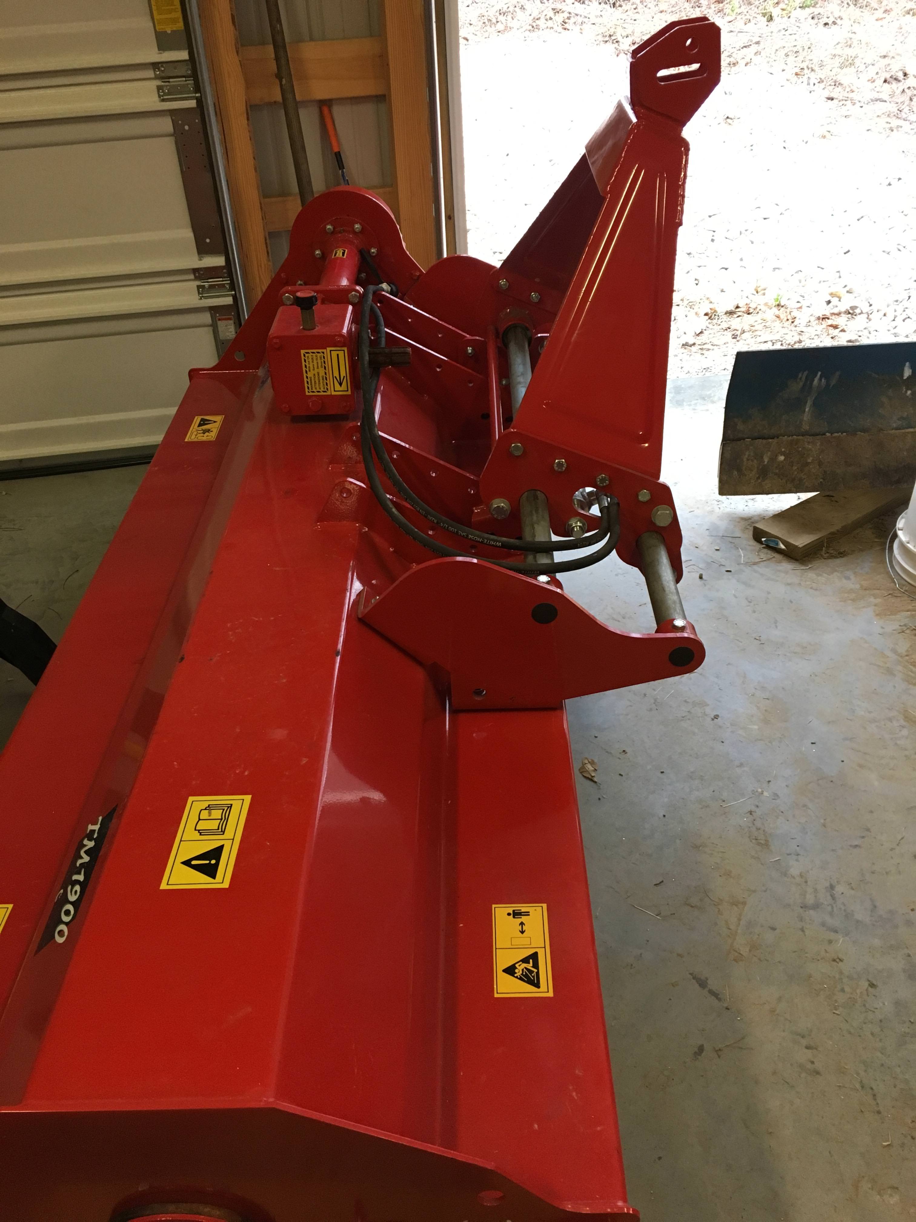

Fully assembled with toplink tower.

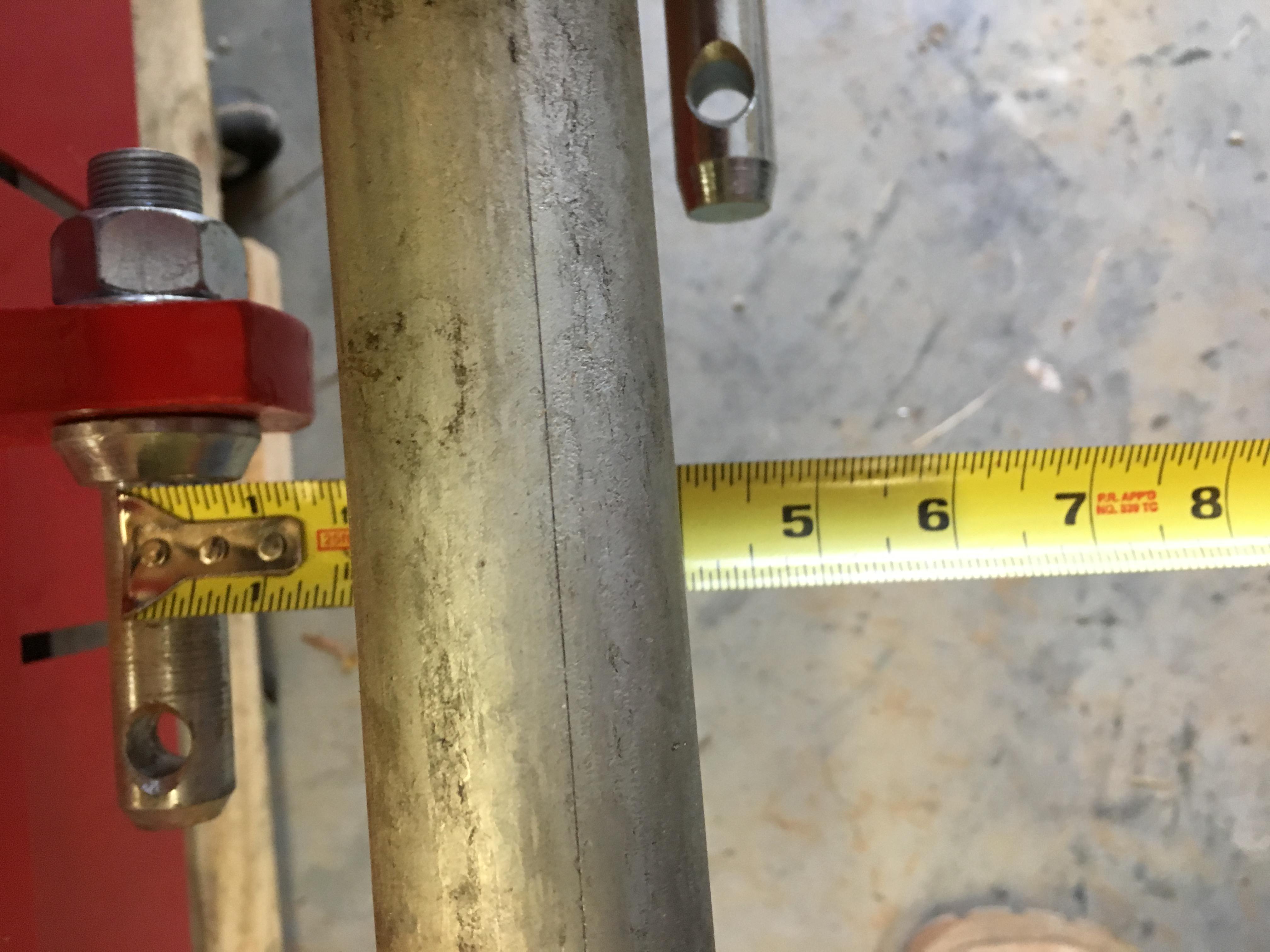

I put one of the original 3pt lower mount points back on (left side of picture) to compare with the new hitch point. The new hitch point is around 4.5" forward of the old one.
The full album is here: Caroni Flail Mower with Hydraulic Side Shift kit - Album on Imgur
This week the plan is to get the PTO shaft cut and test her out!
