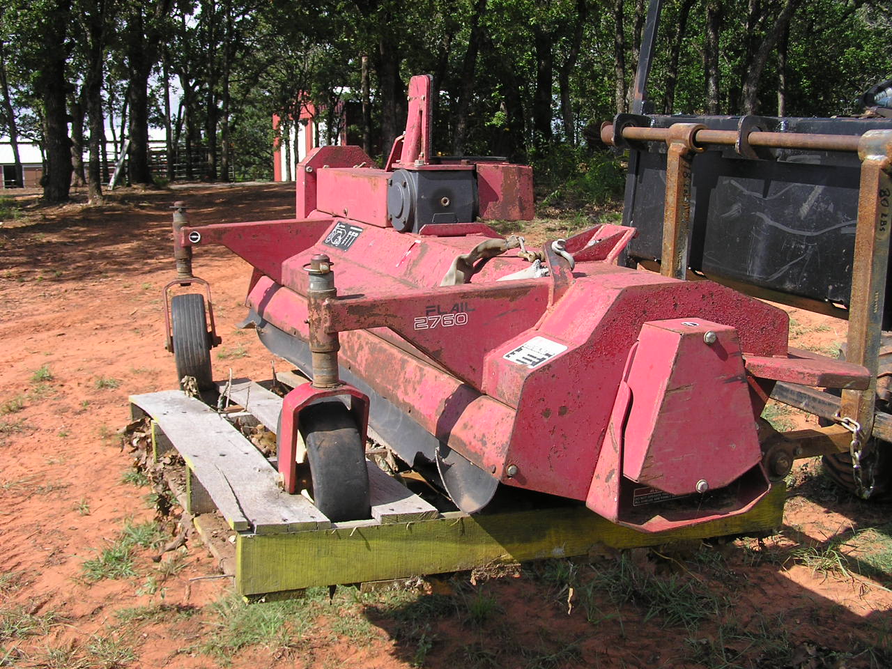

Thought I would share my new purchase, picked up a John Deere 25a the other day. It was the original owner who bought it back in '95 and used it for mowing schools and parks for county jobs. He ended up not using much bc it took up his whole trailer and needed to bring another mower for his help to use. He estimated its got 700 hours. He always maintained it with lithium grease in the bearings and JD fluid in the gear box.

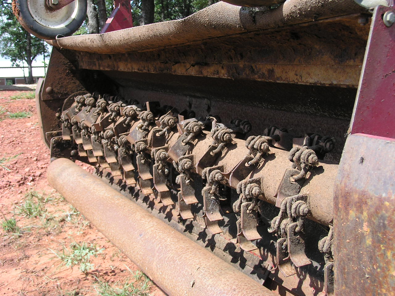

The bad is its been sitting since early 2000s. The drum and roller were locked up and the driveshaft is lock up (won't telescope). The flails could use replacing and I'm sure the belt could be replaced too. We were able to work the drum/drive pulley's free. I never was able to test it bc we couldn't get the pto driveshaft to move (telescope). Didn't mess with the freeing the roller yet. After we worked it for an hour or so he dropped the price and told me to just take it.
All in all, this thing is in good shape. Has some surface rust from sitting but nothing is rusted through. Just needs a little tlc to get her going.
For new flails I'm looking at switching over to the two 'Y shape' flails instead of the scoop "duck's foot" style. I'm less concerned about a low golf course type cut and more interested in having something that can handle thicker brush and woody type weeds. Any thoughts or recommendations on this?
Any thoughts on freeing up the roller? Think it'll free itself once I start running it?
How about the driveshaft? Probably need to just soak it in PB Blaster and throw some heat on it.
Anyways, looking forward to using this thing. I'll be cutting about 22 ac with it. Currently there are some small saplings popping up so it'll be interesting to see how the 25a performs.

Your 25A is ten years older than my fathers 25A and may have sealed bearings. you will need more knife hangers and hanger straps to use the side slicer knife pairs to convert it to side slicer knives-you cannot mix the two types of knives.
You will have to spend a bit of time cleaning out all the mounting holes in the three weldments that are used to mount the knife hangers on each row.
The Y blades you are referring to are called side slicer knives which will give you a great cut and recut the clippings very well with little effort.
You have a great flail mower there and the equivalent new model JD290 would be almost $9,000.00 nowadays.
About the rear roller it would be simpler for you to remove the rear roller and install two new open flange bearings as the rear roller always puts on a lot of miles as it spins faster.
Replacing these bearings will save you a lot of aggravation as they have seen a lot of miles and a stuck bearing IS A BAD BEARING!!!!!!!!!!!!! I cannot emphasize that enough to you.
As far as the propeller shaft goes it will take you a bit of time to take care of as I want you to try to grease the shaft first before you wander around it with any heat.
If you can rent a bearing heater please do that and then remove the entire shaft that will be easier as you will be able to clean the splines with a small wire brush and isopropyl alcohol and then grease it properly before you reinstall it.

Regarding replacement flails, you say you're going to use it to cut a mixture of growth including brush and weeds. My Chinese flail has the heavy forged duck foot style flails and does an excellent job on both my Bermuda lawn and the field currently in clover with some sticks, brush, saplings and the occasional Buick hubcap.
That PTO shaft should free up with some PB Blaster, as you say. Keep us posted as you make progress.

You will not be able to make use of a cast hammer flail knife on your JD25A as the mounts are a completely different style and flail mower rotor.
The heat treated side slicer knives and the micro mark wet well grinder and angle setter from wood craft will enable you to have sharp side slicers for many years.
Don't forget that the side slicer knives have two cutting edges and they stay sharp for a long time as long as you take the time to mow at a slow pace with heavy brush and by mowing in a spiral pattern to save on fuel and brake wear.
