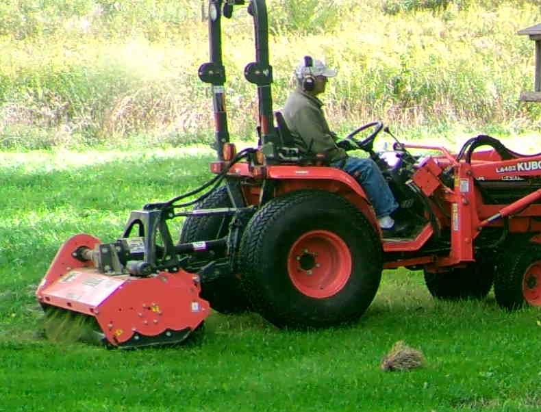

Was cleaning up pictures on my trail cam yesterday. Found this one of my Woodmaxx FM62H in action.
