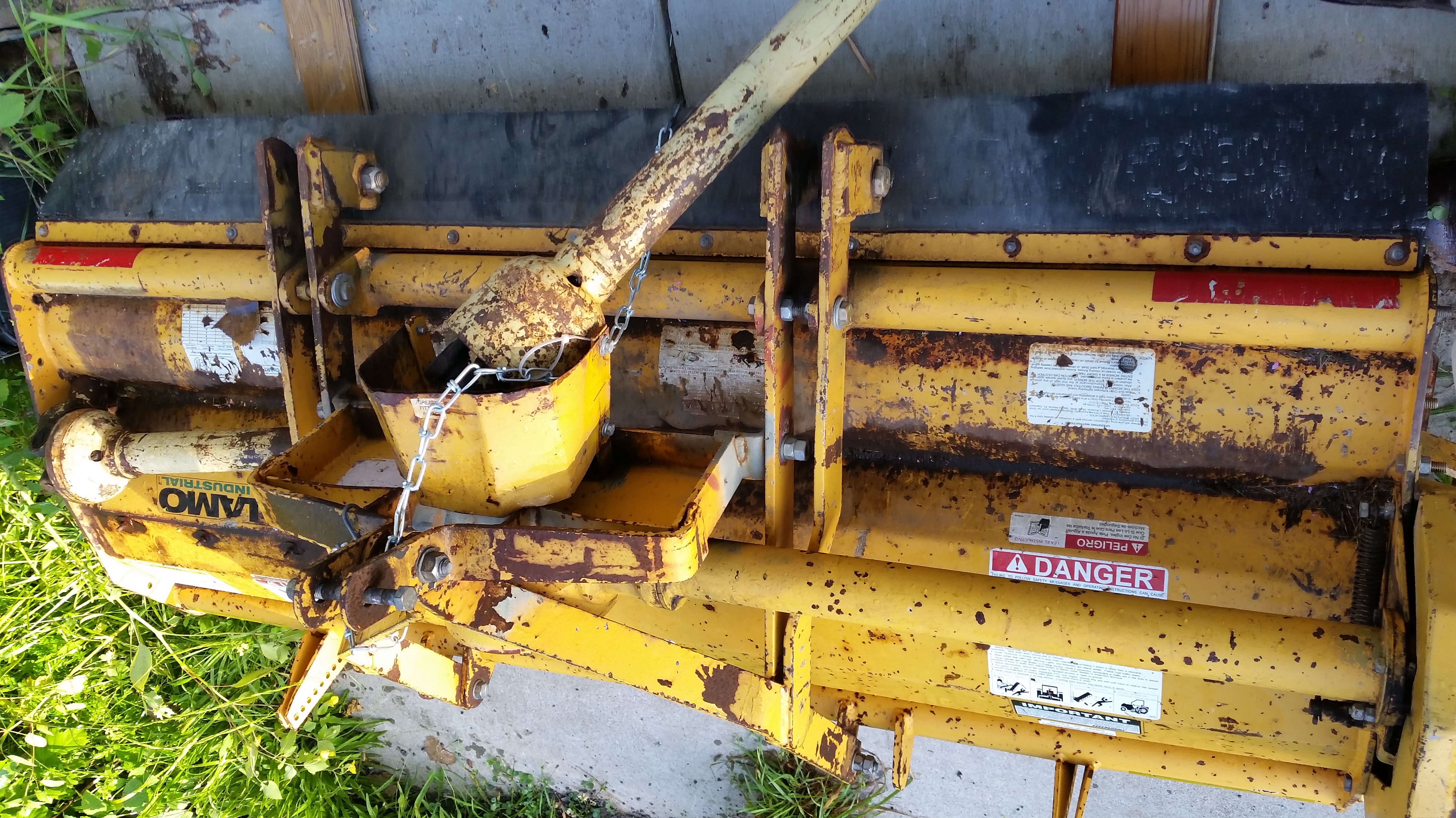

Stupid hurts. Thankfully only my wallet is injured this time.
I was interested in a flail, started reading and looking at the same time, found an alamo shd74, read how stout they were, made a move on it because it seemed like a good deal. I checked what I knew to look at but after I unloaded it at home I realized that the hitch and gear box were facing the wrong way. It must have been on the front of a tractor. So to make work I think these are my options.
1. Buy the hitch and gearbox mount from messicks for about twice what I have into already.
2. Buy the gauge wheels and take the roller out and run it reverse, about the same price as the hitch.
3. Put it all back together and use it as trade bait for an ditch bank flail which would be move useful.
Are there any salvage yards that would have the parts I would need used?
What ditch bank flail is best reviewed? My tractor is a ford 345, about 8800 lbs and 42hp at the pro. Thanks for all the advice..

Apeman: No idea what you paid but my instinct says sell it somehow/someway. Even if you take a loss it will not be as much as the money you will put good after bad trying top re-do it.
But... you may not want to do that. There are all sorts of parts available. Flailmaster was the dominant source for flail cutter parts for most brands. Even after they went out of business late last year, there is some lingering part business that I am not up on. Suggest tracking down Flilmaster status. 2nd., Alamo flail mowers are so durable and common and used by so many highway maintenance outfits there are parts forever. For example the big John Deere dealer in north central WV also sells parts for Alamo. Alamo themselves (cust service) tends to be quite helpful in all sorts of oddball situations. Try (830) 372-9551. There are rare but a few people who want/need/prefer to run the flail mower on the front of a tractor so they may be interested in it.
If you do welding/fabrication work yourself or have access to a good shop there may be some interesting possibilities there.
It depends a lot on what you really want and need to do with the mower. If it is "reach over the edge" bank mowing, [you probably have the wrong machine] and there are some really attractive new cutters for that. Look back several posts in this thread for some discussion. If you convert to putting this one you have on a 3pt hitch, check on rotation direction and whether it is right OR does it matter, etc.
Be nice to see some pictures of what you have.
Anyway, good luck !

That number was super helpful. He was able to determine that what I have is a shd-h, it was designed to be pushed on the front of a tractor. He also said that there is no way to make this work from a 3 point without significant money and work. Only 1% of these were made in this configuration, figures that I would find it by accident. Kind of makes me want an alamo after talking to this guy and seeing how sturdy this thing is. It's for sale to say the least, but I'm sure everyone on this site is smarter than me and cant use this thing. Haha Most likely going to be trade bait for something else. Thanks for all the help and advice

I think it is 540 rpm. I listed it in the for sale forum. Thanks
