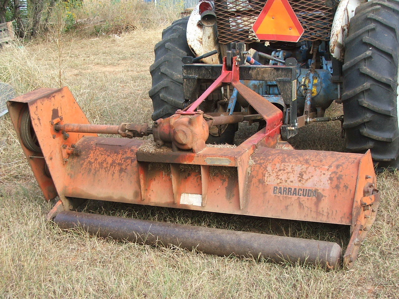

My flail uses the spoon type on a D-ring. It will throw one or two occasionally on stuff that shouldn't be in the grass/weeds--Like rebar or pieces of cinder block. If I hear it and find them, I'll sharpen them and put them back on before the next cut. I can feel a little vibration if I loose more than about two.
I've rolled up about 100' of barb wire and a few fence posts before. That was a lot more nerve racking that throwing a cutter. :oops:
Mine is an old Giant Barracuda I picked up at an auction for $35. I got it cheap because no one knew what it was. :giggle: It will get a make over after I finish the tractor and a couple of other implements.

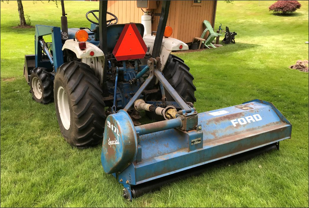

I bought this Ford 917L last year for few hundred bucks and after set on new flails + bolts, rebuilt belt idler pulley, new PTO drive shaft, new gearbox shaft seal, new belts and new roller bearings it is working very good!
Al together perhaps $350 worth of new parts but at least the labor was free.
It is the perfect match with my Ford 1310 tractor and the exact model I wanted so I did not mind doing the repairs.

That's one ugly looking mower but, it looks like it is indestructible. Paint it blue!
Better than my $100 917. Mine had paint but lots of dents on the hood & other obvious issues.
