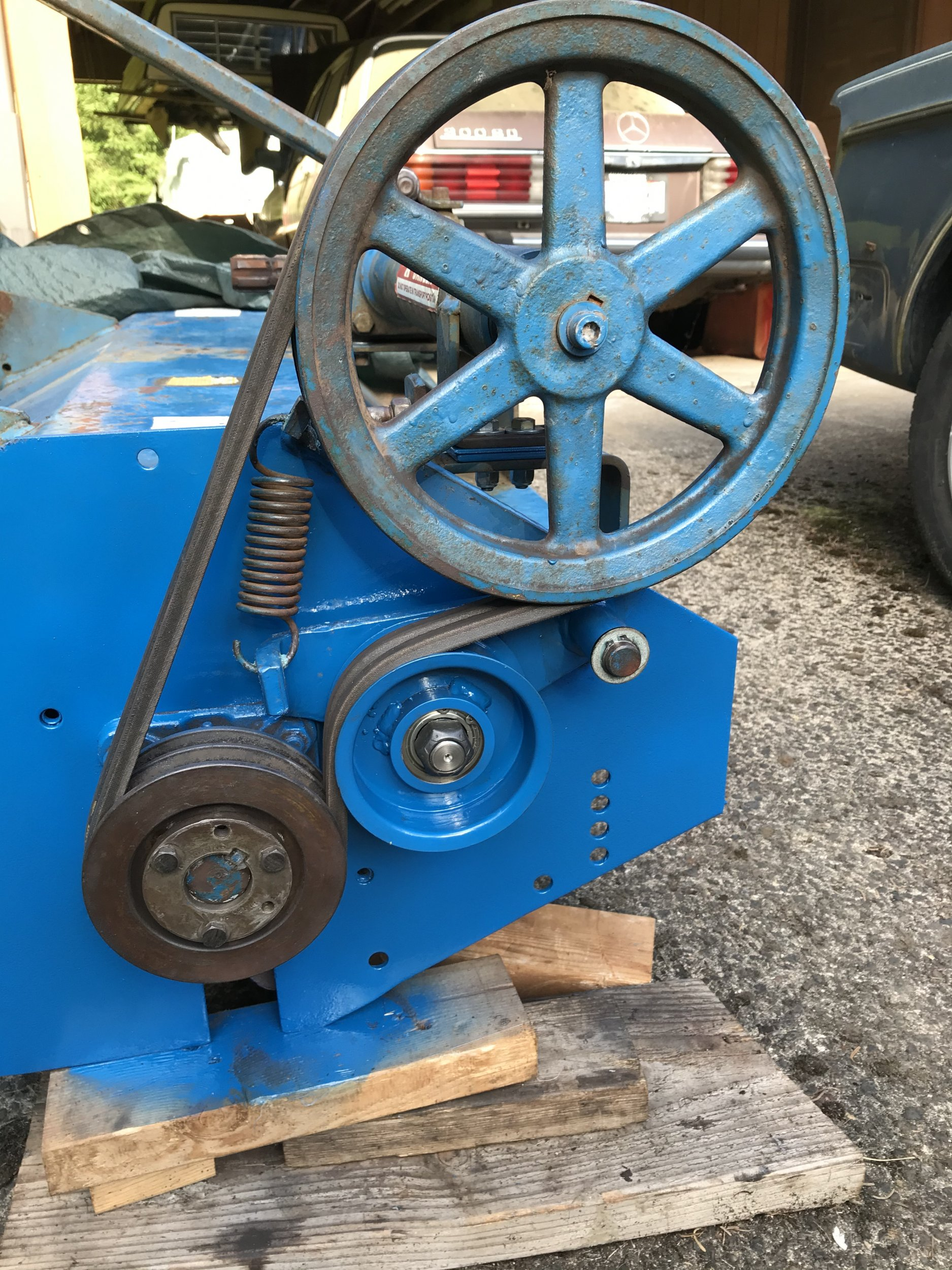

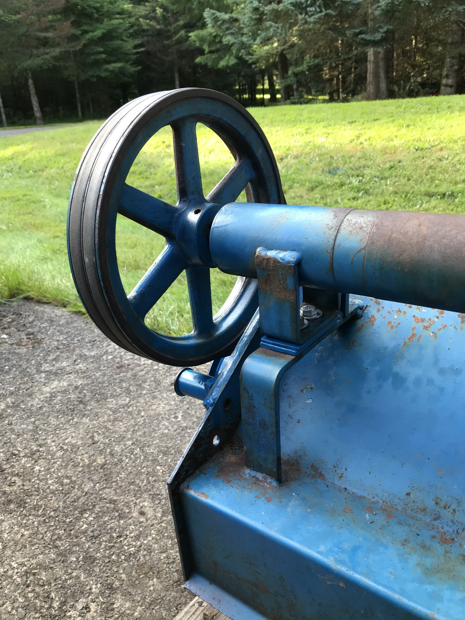

..........................snip........................ as long as your pulleys are aligned you should have no issues.
No kidding, just take a look at the two thick shims I had to make in order to align the two V-belt pulleys in my 917L mower!
The two pulleys were totally out of alignment before installing the shims.
This mower is probably 25 - 30 years old and who knows what the previous owner did to it, so it may have left the factory perfectly aligned?

OH MY GOD!!!!!!!!!!!!!!!!!!!!!!!!!!!!!!
What the He** did they do to it Art??????????????????????
The tube looks like it has a slight bend in it unless its the angle of the photo image you provided.

The tube is straight no worries.

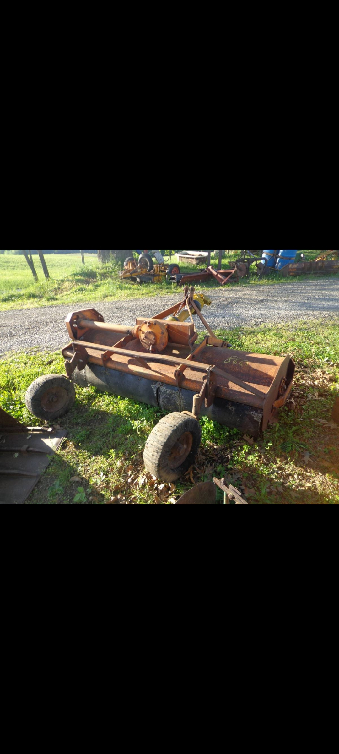

What flail would this be? It's a 6 foot cut and has trailing wheels behind?

I believe that flail mower is a Mott mower with rear wheels instead of arear roller.
It is worth every penny if you can afford to buy it and have mule big enough to lift it
