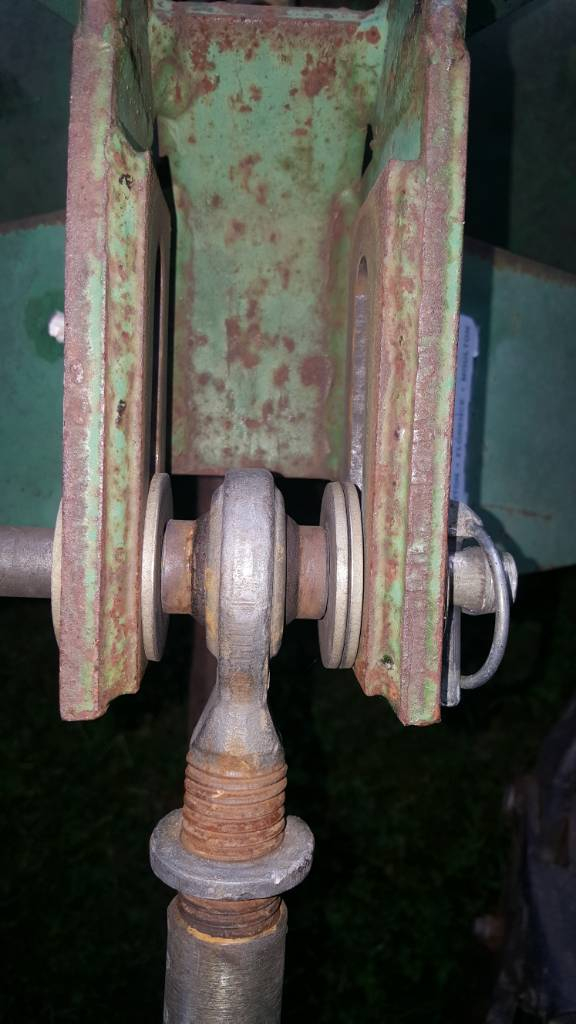

That pic is from Deere site.
Here's the one I'm looking at
May I ask for a picture of your own Quick hitch model? So I can fully grasp what your worried about please?
   / Let's talk flail mowers #7,064
Wow, *Now* I understand. That’s a seriously long slot to have a pin slide fore & aft in!
That is definitely a speed bump to adapting for a quick hitch setup with that amount of slop.(for lack of a better description.
