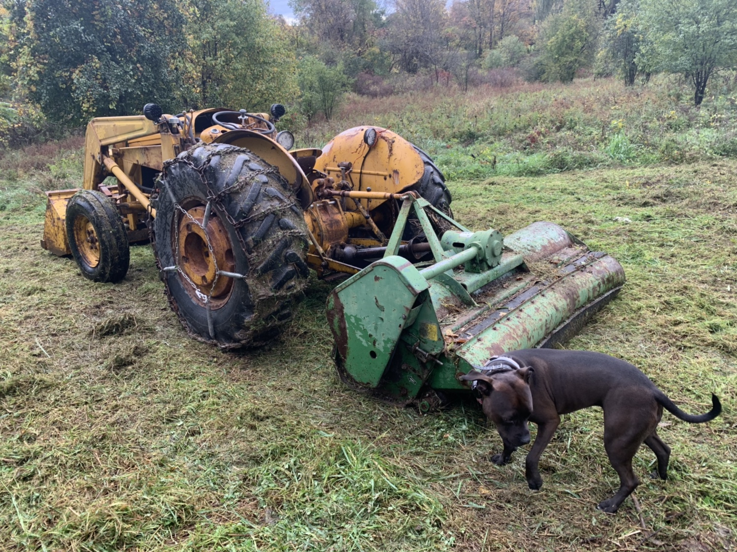

Took my $300 JD25A out for a spin this past weekend in the wet, soggy field. Just tuned the carb on the old MF35 and needed to load it up to test it.

What's your opinion of the cut quality?
Considering that I've never replaced any of the knives aside from what was damaged or missing when I got it, nor have I ever sharpened any of them- I'd say the cut quality is pretty dang good. In dry conditions at the lowest cutting height it'll take my overgrown field (seen in pics above) and make it look like I mow it weekly in just one pass. The cut quality is orders of magnitude better than a brush hog/rotary style cutter. If I hold the back guard up in wet brush it'll blow the clippings out in a smoother fashion than if it's super wet.
The key is to make sure the flail is set up right, don't let it nose dive into the ground. It takes a few minutes of careful adjustment on the threaded top link to get it to sit just right, but once set, it's great.
If I run over a small tree, something woody about 2-3" diameter at the base, it'll just shred all the small branches and leaves off of it and leave the main trunk mostly untouched. A hammer flail would likely mulch that up. But as I said, I paid $300 for this thing, it came with a coffee can of extra knives (which I had to replace six or seven of...) and top off the gear oil. I've been running it for about six years.
The plus side of the duckfoot/scoop knives is that they leave a flat cut like a lawnmower blade does. It looks more "finished" even though there are only 36 knife stations. If my zero turn dies I can use the flail to knock my yard down while I wait on parts, it still looks really good after I'm done.
