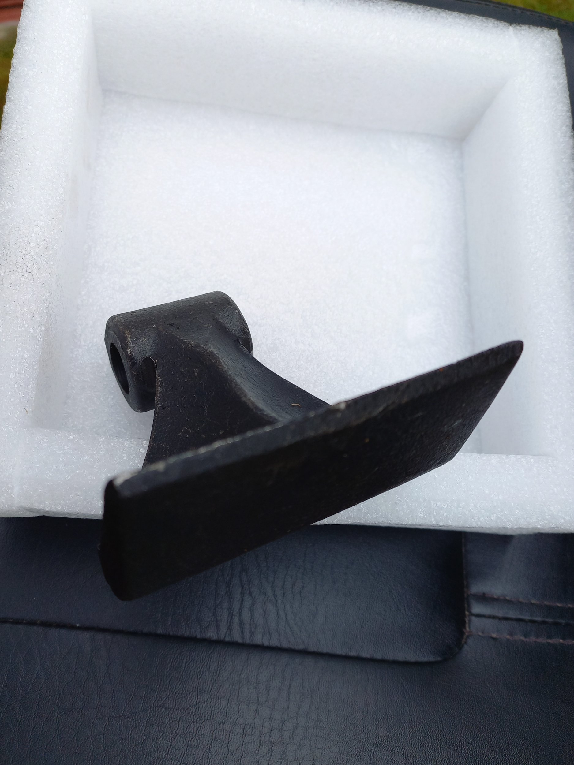

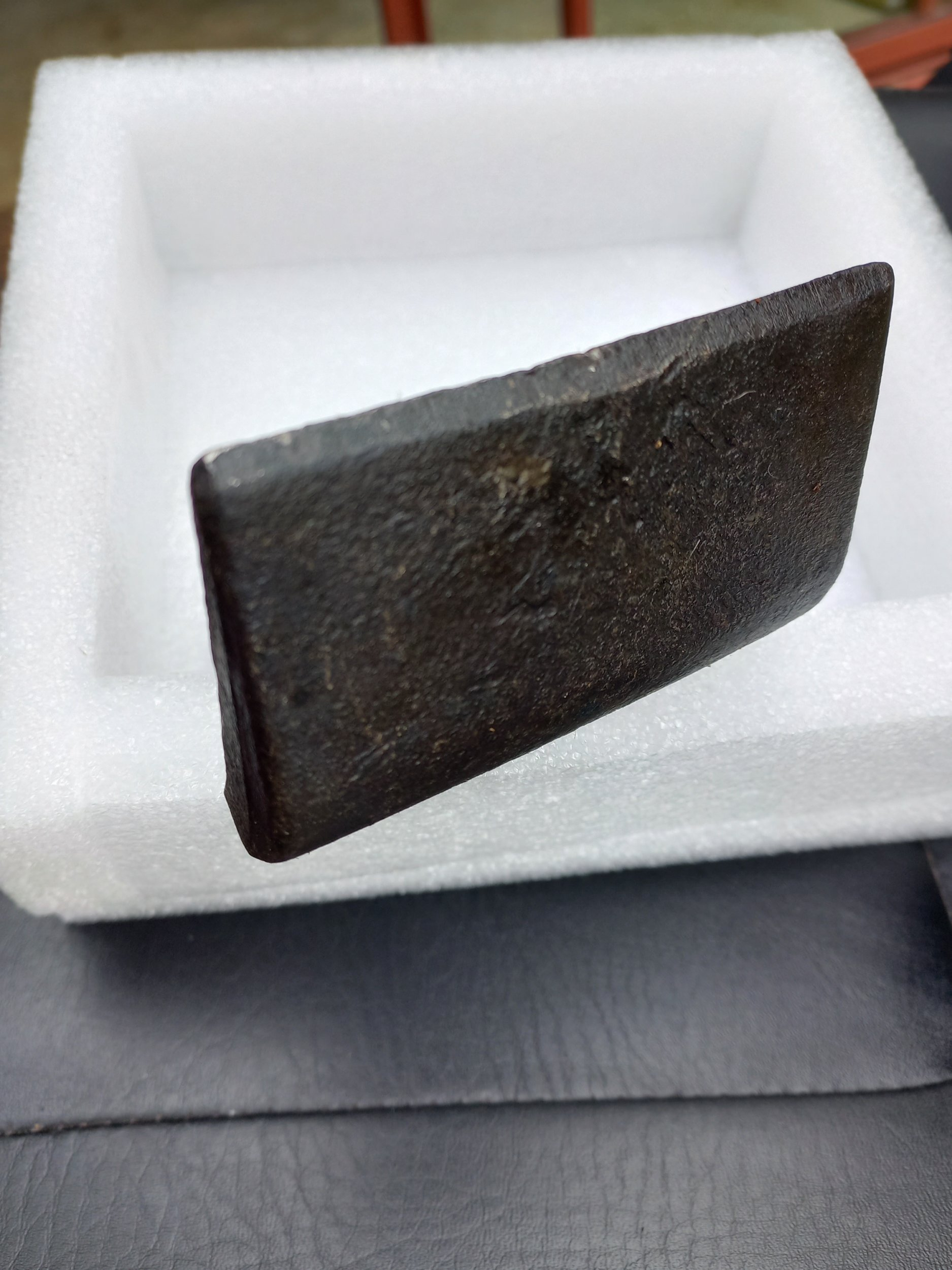

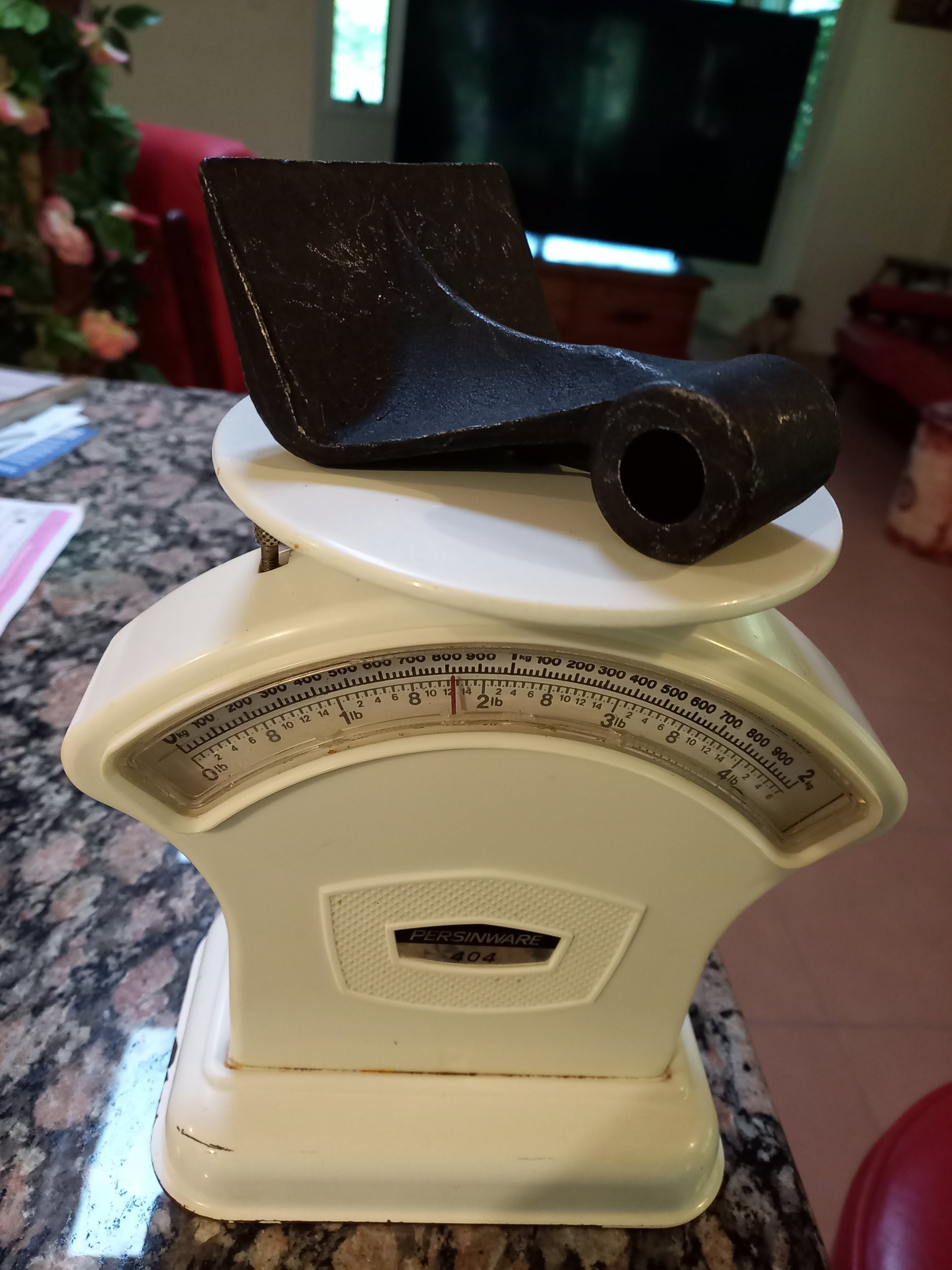

I just weighed one of my hammers. It is 1 3/4 lb. View attachment 743028
those are the exact ones Titan sent me, and like mine, they weigh 1 lb 12 oz with a slight variation from blade to blade of 12.25 to 12.75. The OEM blades I took off and weighed were 1 lb 10 oz, with that same 'slight variation' of up to a 1/2 oz. These are the blades I'll replace with when they all need to be replaced, and at no point in my original 'question' post did I in any way indicate running different weight blades was my 'long term solution' for that one who seemed to think it was

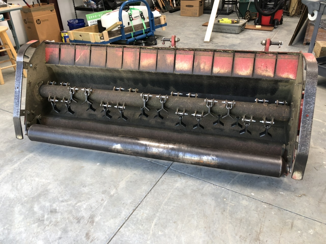

Added a side shift flail to my collection today. I have a ditch bank mower on my Branson but wanted a dedicated flail for my AC.
Befco D90 72" this thing is a tank

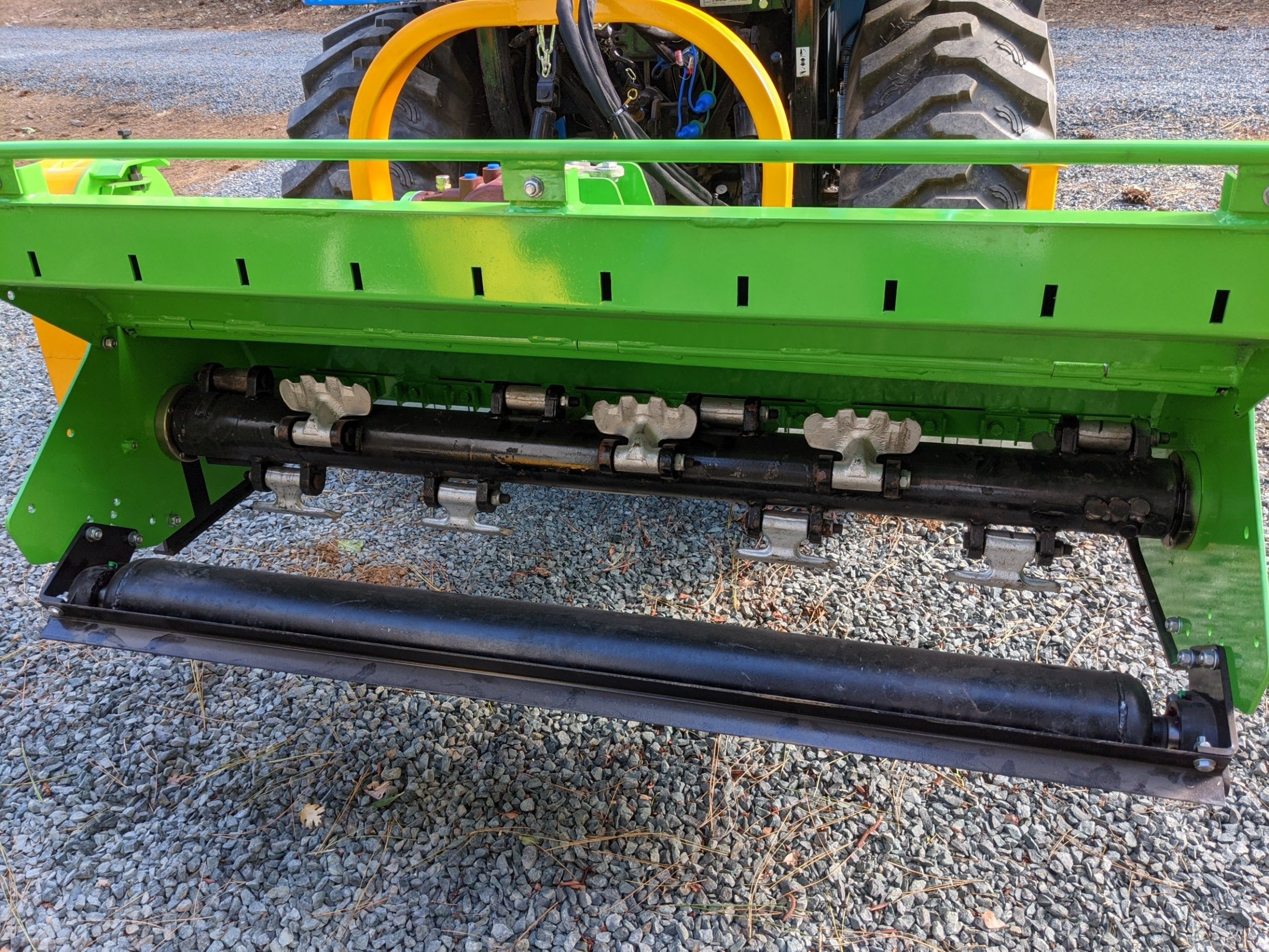

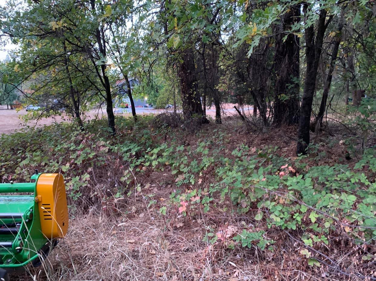

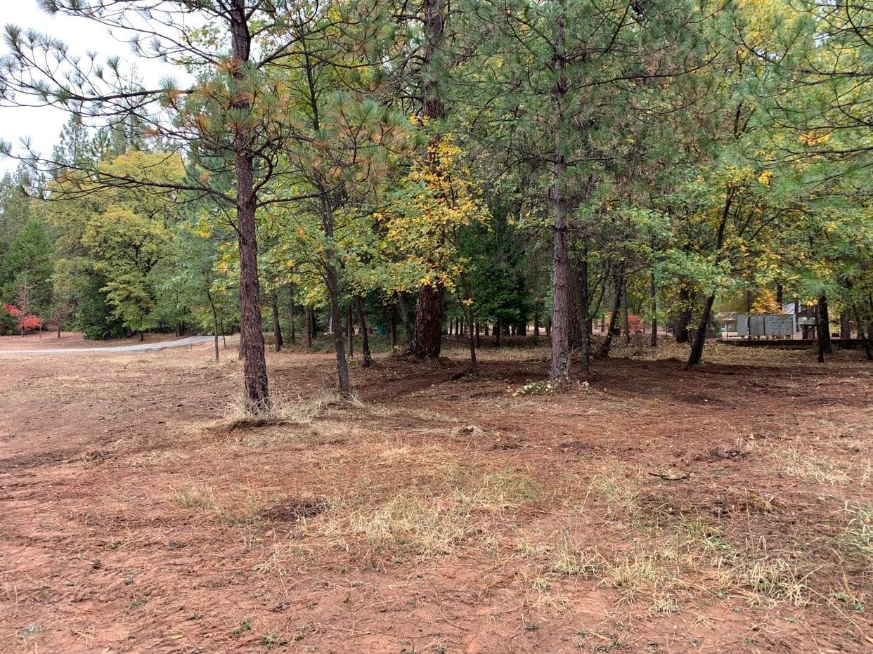

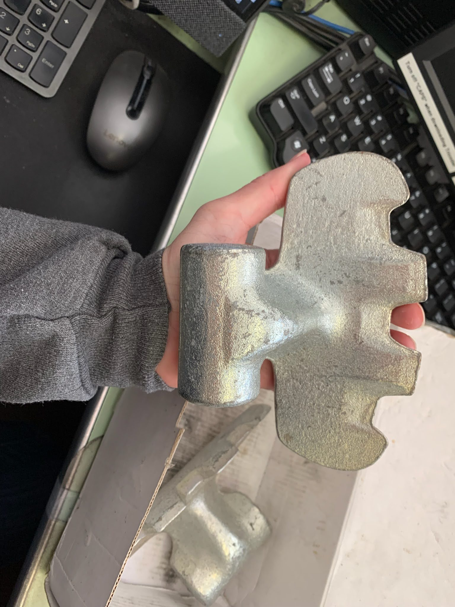

   / Let's talk flail mowers #7,436
Loving my flail mower. Got the Novatractor MFZ with 3lb hammer/bear claws. It's a beast. I thought I'd have to rip out berries and them mow what was left.. nope, it just eats it up. Before and after, different angles, but same area. When I first got it, I accidentally hit an old 8 inch stump in the grass. While I don't recommend this, that stump is no longer a problem :D We're calling it the "park maker" because it makes rough areas look like a park. So far it has been great, no belt slippage, no teeth breakage, nothing more than grease at the spin spots.

Man those a wild looking hammers Racenut!
I agree ! With some searching I find the NovaTractor products are from a Houston TX company. But the very foreign tractor in their YouTube videos looks to be a Chinese (??) machine. NovaTractor flails appear to be very new and not on the market long. Wonder what the whole story is ? Impressive looking mowers.
