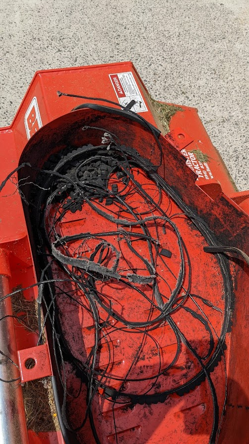

Not good...that is a brand new machine (hours wise) and if set up well should have no such issues. I have to guess that the belts were not tightened correctly, out of sight under the shield, and just ate themselves due to slippage. (i.e. I think the root cause is slippage.) Another possibility is that grease and/or oil got on the belts causing them to slip and heat. Once that happens they get hotter and hotter and destroy themselves. Maybe something was caught/jammed in/around the rotor and cutting parts. Wire? Polypropylene twine? If it was under that much stress you should have known it.
   / Let's talk flail mowers #7,454
Between being in the cab, my ANC headphones and listening to music I was blissfully unaware if they were signaling me their doom. I do know when I did hear them at various times they sounded "normal". Points against me for not checking it first, I usually do a pre inspection on stuff like this but I was anxious to mow.
It's a wonder you didn't smell them well before it got to that stage.
I was in a cab, I could smell the cut grass at times but never any burning smells.
What make and model of flail mower is that?
Befco D90

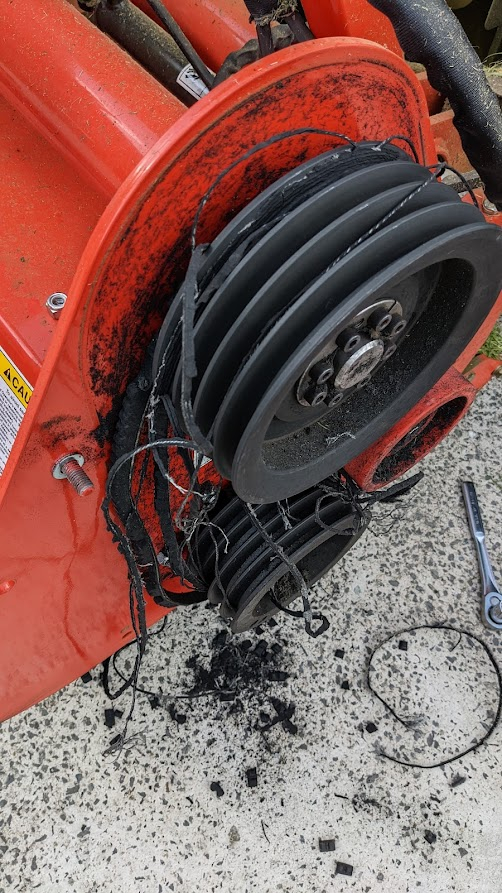

Did you check belt tension before use?

No, and that is a strike against me. I greased it but figured I would check the belts at 8-10 hours for stretch. They were Goodyear belts so not low quality as far as I know. Mine is a Befco not Betstco. (just saying because they are similar)

A similar result for me my first time out with my dad’s old Caroni flail last year. A couple of hours out I see black stuff clogging up the belt cover vents. Slimy mess. I’m pretty sure I over greased it and grease got onto the belts. Now a couple dozen hours with new Gates belts and no issues. The greasing until it oozes does not seem to work well here. ;)
