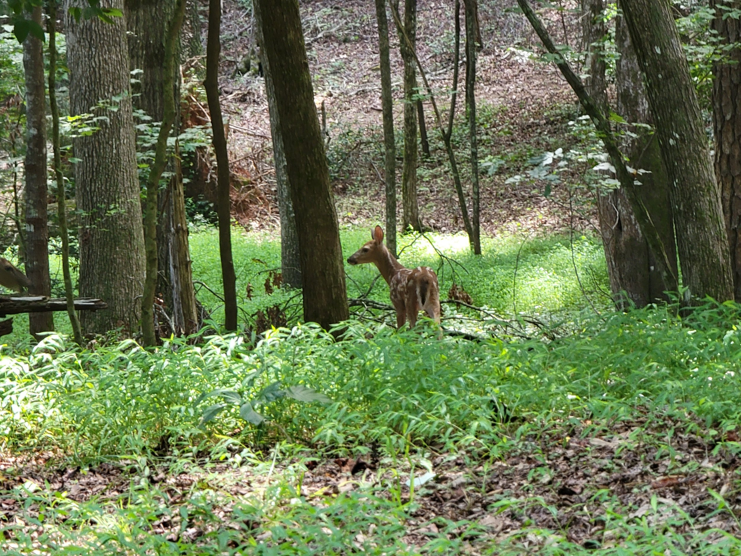

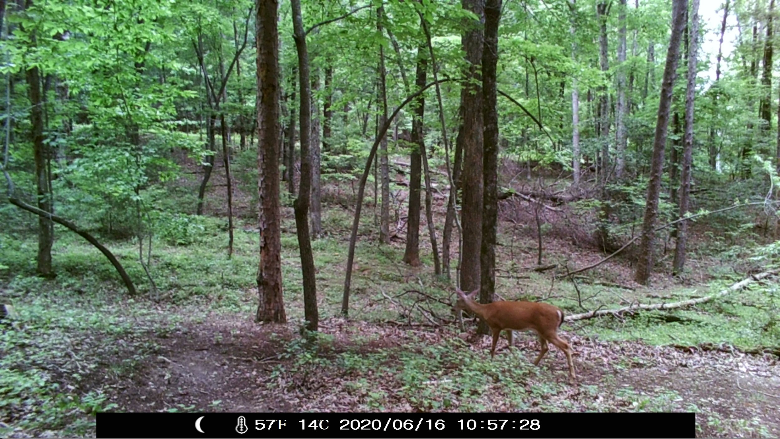

I have been interested in a flail mower for about a year and have been going through a LOT of posts. There is a lot of great info here... (y)
Now I'm looking for some help before buying. Sorry for the length of the post, just trying to provide a good overview...
We have 12 acres, mostly wooded and a number of fallen trees to clean up. I want to use the flail mower to clean up what is left, small branches, small saplings and some brush. (I've been collecting all of the bigger rocks and getting them out of the way.) Also to maintain these areas once things are cleaned up.
Originally I wanted a 60" mower, however the paths in my wife's garden (it's a big garden) between the 15 raised beds are only 65"-66" wide and even though my tractor (Kioti CK5310) will just fit down the aisle the overall width of a 60" mower is too wide. ( I have an old Ingersoll 4018 with a 60" deck that takes care of the grassy areas, but that is also too wide for the garden.) I also thought that having a flail mower narrower than the tractor would make it easier to maneuver in the woods. I also like the idea of a 53" cut rather than a 48". The flail will also be great for the times when the grass gets too tall in the open areas for the Ingersoll to manage. During the spring and summer in Georgia, the grass grows VERY fast.
Here are a couple that look promising:
Betstco FH-FMC135 53" The "Commercial" level unit 53" wide. ( Side shift is +$500 )
Nova MFZ135 53" 53" unit with side shift
If I do not get a side-shift model, will I regret that later? (I wanted to stay somewhere in the $2700-$2800 area.)
With the tight woods, uneven ground and some elevation to deal with, I want a unit that is as heavy duty as possible. While I have collected a lot of rocks, the flail might find one or 2 that I missed... Also, the tractor has ~30 hp at the PTO, so 60" or less should not be a problem.
From comments and issues that I have read, it seems that no matter what I buy, putting Loctite on most of the fasteners might be worth the time up front.
The availability of spare parts and a reputable company is also important.
I am open to other options/suggestions. Thank you for taking a look.
Craig
