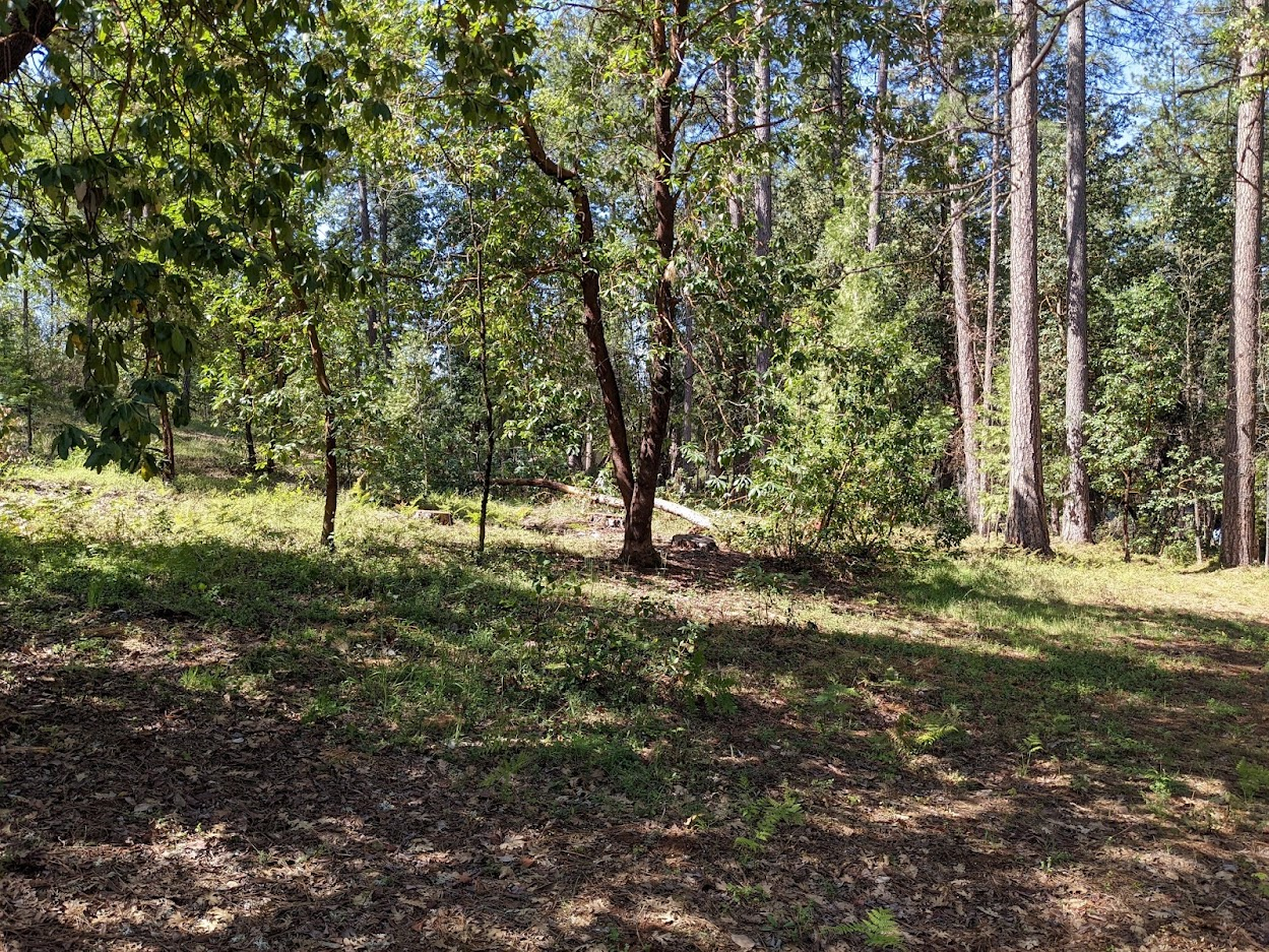

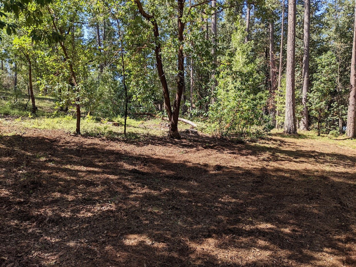

My property looks similar to yours in some places. I went with Novatractor because it had the meanest looking hammers I found. I was telling my wife we need to take better pics and video of what we're doing with it because so far all I find online is people just cutting grass lol. This thing eats twigs, small branches, saplings and pine cones like nothing. This was 15 minutes and was easy stuff compared to some.
Also, the sideshift has been great! I have the MFZ155, my tractor is 66 inches wide. So it's 60" cut doesn't quite cover the tires but I didn't want to go wider because it can be tricky to maneuver between the trees. The sideshift lets me reach a little as well as letting me get it out of the way when turning or up against the fence line. I am glad I went with a slide model.
I was a bit leary about getting one that seems almost nobody has heard of, but they've been on the market for at least a few years so hope they will be around when I need something. I do have a few spare hammers. And as I saw someone else mentioned, the back panel on the Novatractor opens up for inspection and maintenance and makes it much easier to deal with.

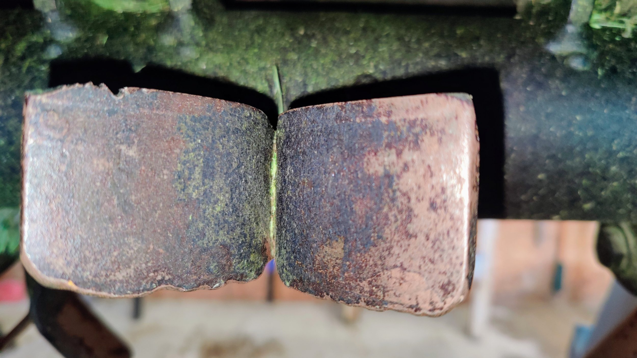

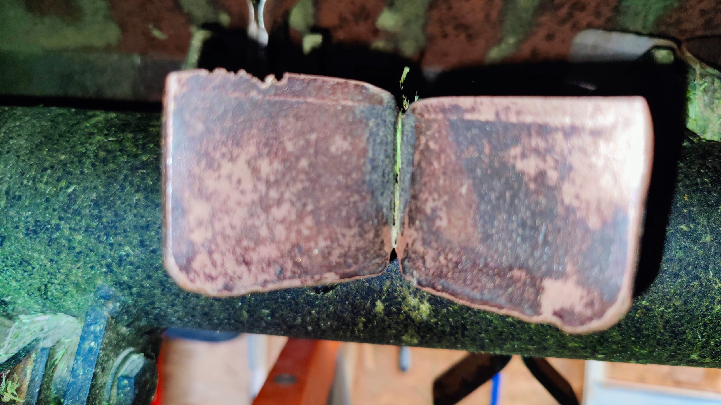

I'm sure this is asked and answered, but sorting through 700 pages of this wonderful thread? Crikey!
After one season of mowing with my wonderful new flail mower, the grass and weeds are not coming out with a clean cut anymore. Sure, I'm going to raise it up and grind the Y knives (or reverse them), but while I'm at it I'd love to get a better knife set. Something hardened, that will cut better, and for longer before needing another sharpen. Would like your advice on what to buy, and from where?
Flail
: Del Morino Funny Top FT158C 62", 24" manual offset option. Stock Y Knives. (happily purchased from Good works tractors, replace the frequently failing stock belts with kevlar, never replaced another belt since.)
Tractors: I alternate between my 1025r and 2025r, depending on what's attached already.
Mowing: 15 acres of grass, wildflowers and weeds. Nothing thick enough to need a hammer. Over the next few years most of the fields will be nothing but white clover and a few wildflowers.
To see example of the grasses in the fields, view of video or two here:. https://m.facebook.com/cordolake

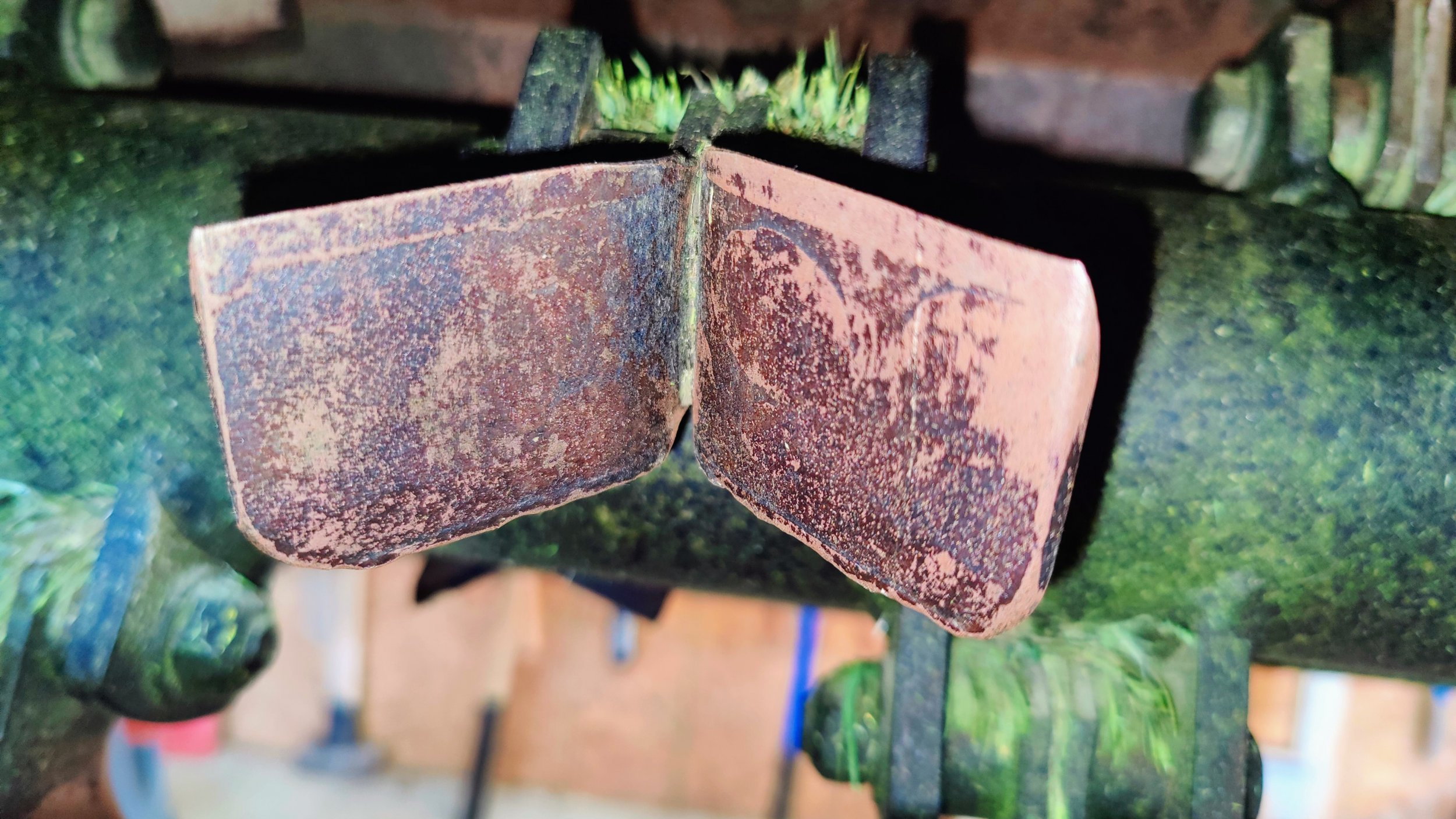

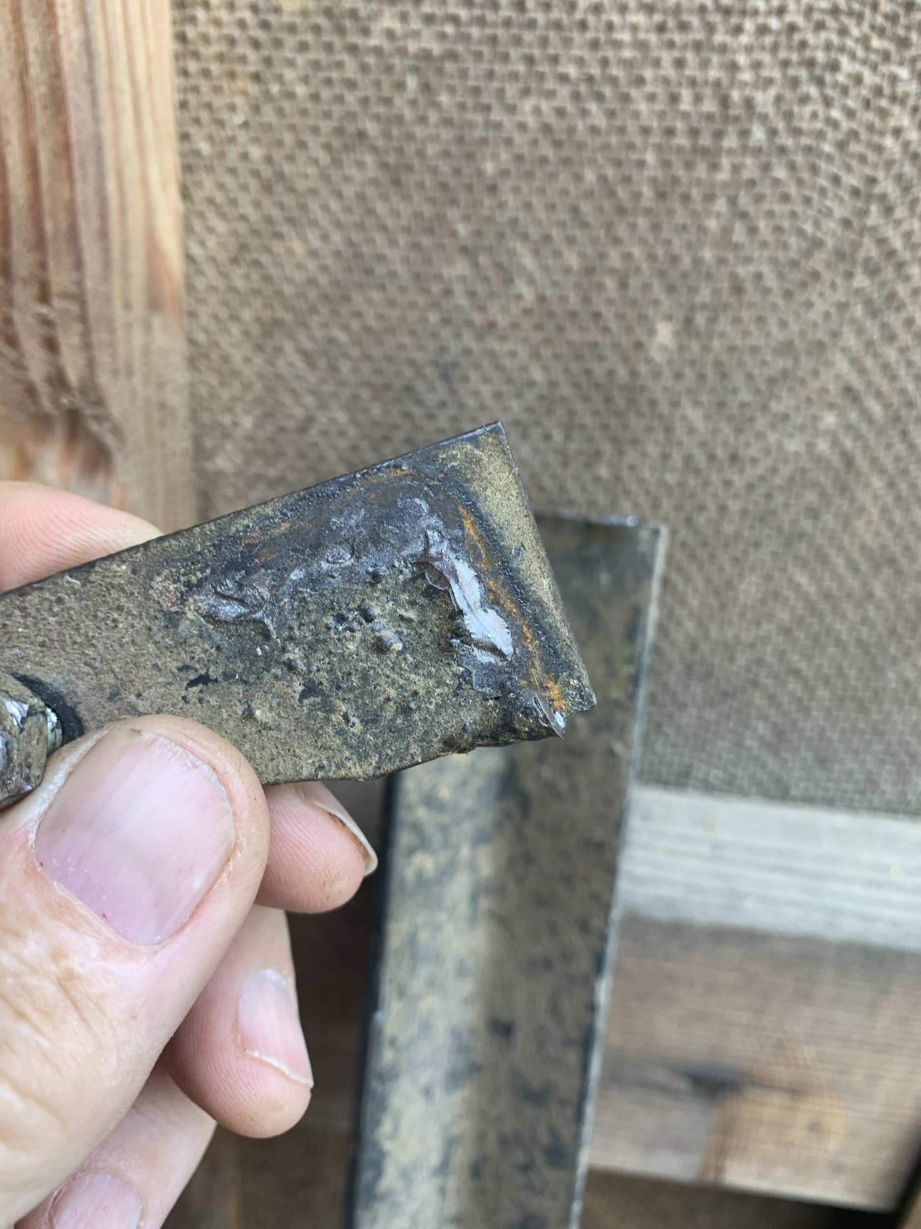

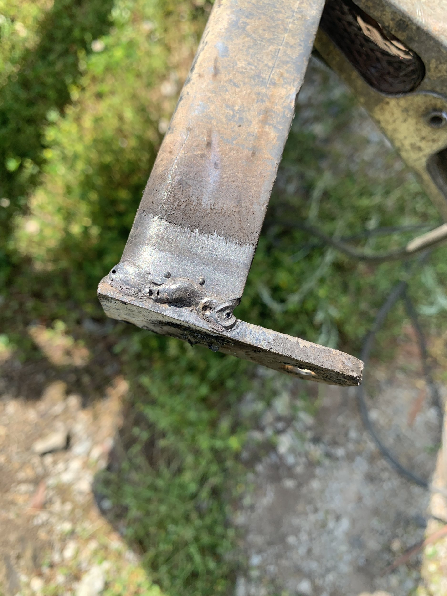

Here is the condition of my knives after about three full mows of 15 acres.
Bottom is the business edge.

I have touched up the edge of my hammers 3 times in 4 1/2 years but only as a maintenance precaution. I mostly cut grass but a lot of twigs and small branches that are constantly falling off dead trees. Also occasionally lantana bushes. Hammers make a real nice cut on grass. As above, I bought a new set of hammers but it will be a long time before I fit them due to the excellent condition of the originals. Knives may be more forgiving if you hit a stump and a lot cheaper to replace if you hit a rock. I have sandstone rocks and the hammers can handle hitting those reasonably well as they are not as hard as granite. I still try to avoid them. So for a nice lawn finish, my vote is hammers.

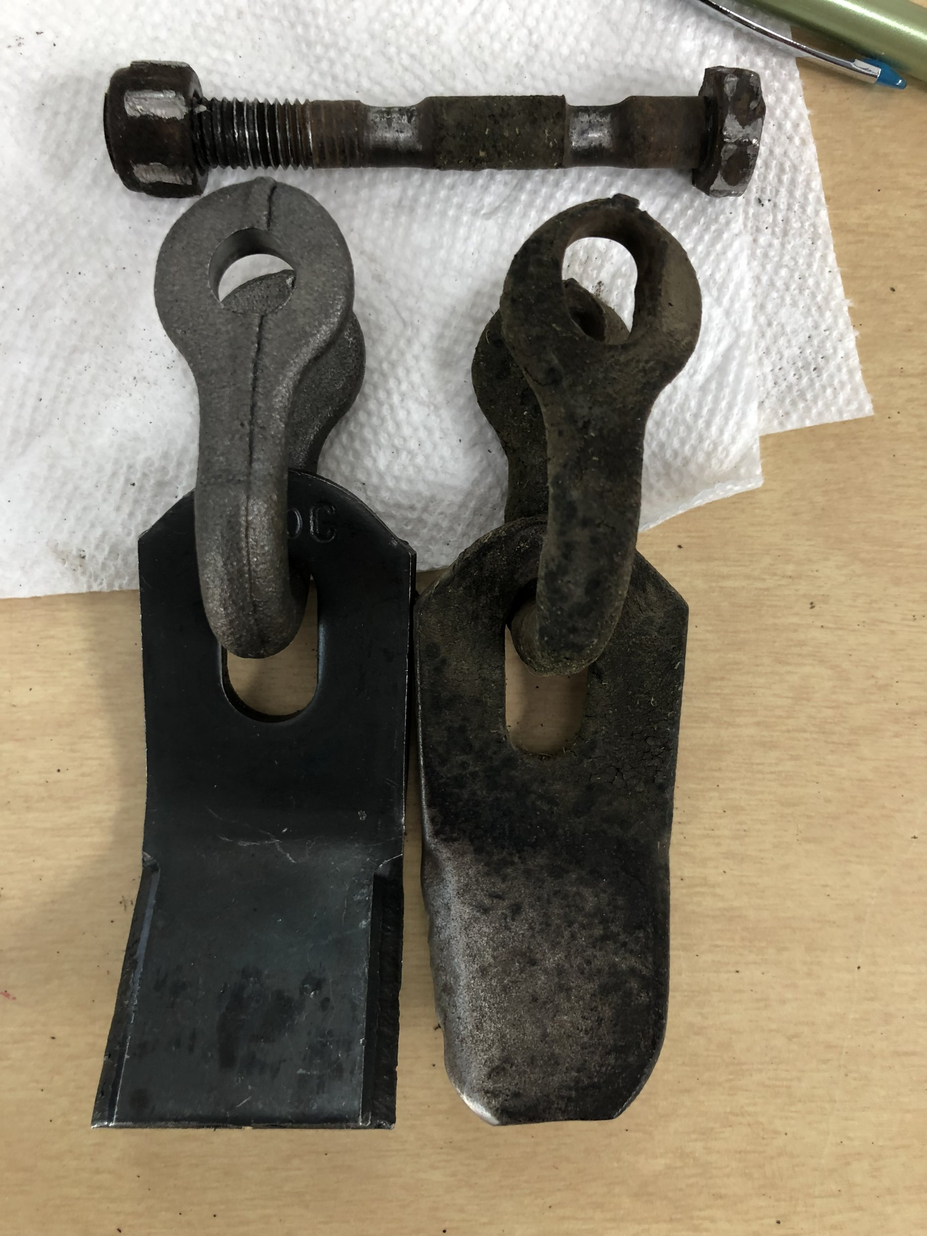

Maybe just sharpen them? Not a chore I’d want though. Here’s a new and old from mine. The old pasture cut is now better but not what I’d call WOW. Maybe we expect too much.
