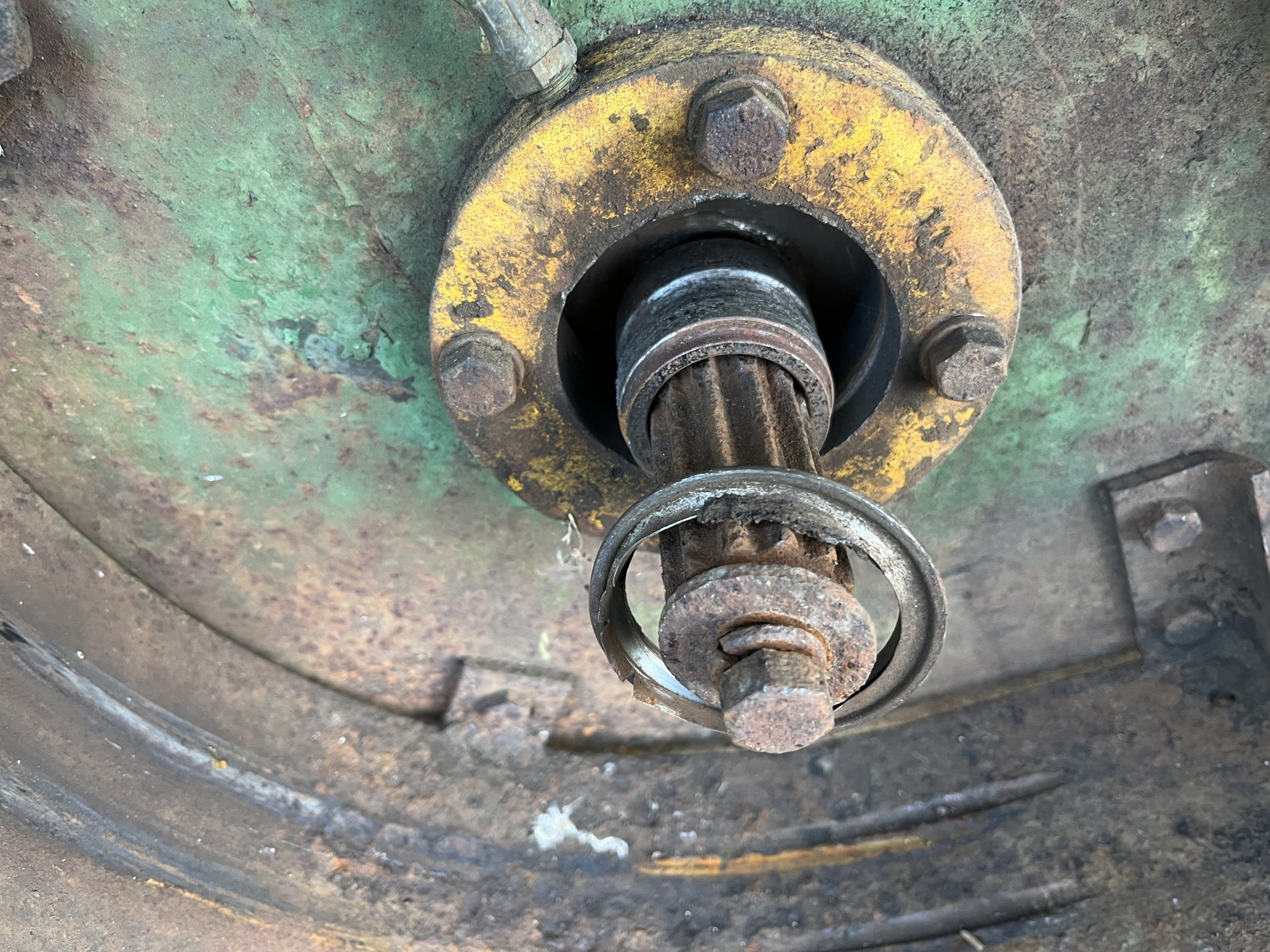

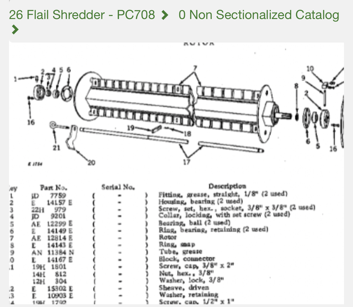

Found the spool of wire I was missing….
I was cutting nicely until I found my missing spool of fence wire. After untangling the mess, here is what I’m left with. Looks like I need parts 5,6,8.
Will I be able to get this off with a standard bearing puller?
Any tips would be appreciated as this is my first bearing replacement.
It looks like I can only find aftermarket parts for this JD 26.
   / Let's talk flail mowers #7,582
For situations like that I usually use a Dremel and cut-off wheel to score the bearing race in 3 locations evenly space around the circumference. Usually the bearing will crack at one of the scores when they get deep enough. At that point I can begin to pry it off and it will break at the remaining scores. I haven't had luck with a bearing puller on something like that or even with a bearing splitter in a press. I've also done a single score, then a bearing puller when it cracked. That one was on a boss where I could only get a Dremel to one side of it, and It had to be a spiral cut at that. Don't worry too much if you cut too deep and mark the shaft, there is plenty of surface area left to hold the new bearing. I would cut as deep as you can on the first cut to create heat in the bearing race. When the bearing race cools down is when it tends to crack. I've had it crack as I was putting the Dremel away. If you get to a point that you don't feel comfortable going any deeper and it still doesn't crack you can hit it with a chisel in the cut to see if it will split.
   / Let's talk flail mowers #7,583
I'd weld a couple of tabs on it for a puller to have something to pull on.
Also, I have seen bearing races free up with a good heavy bead laid on them.
   / Let's talk flail mowers #7,584
That is how I remove just about all races anymore, so simple and it really does not that big of a bead.

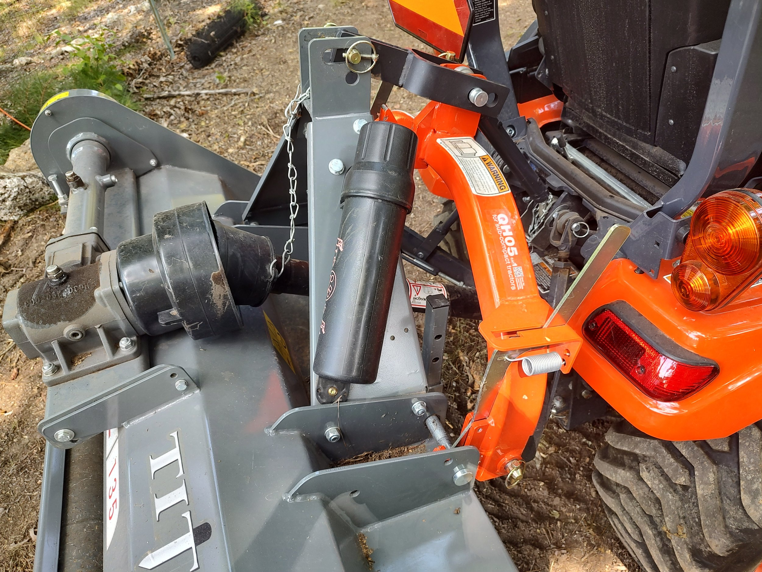

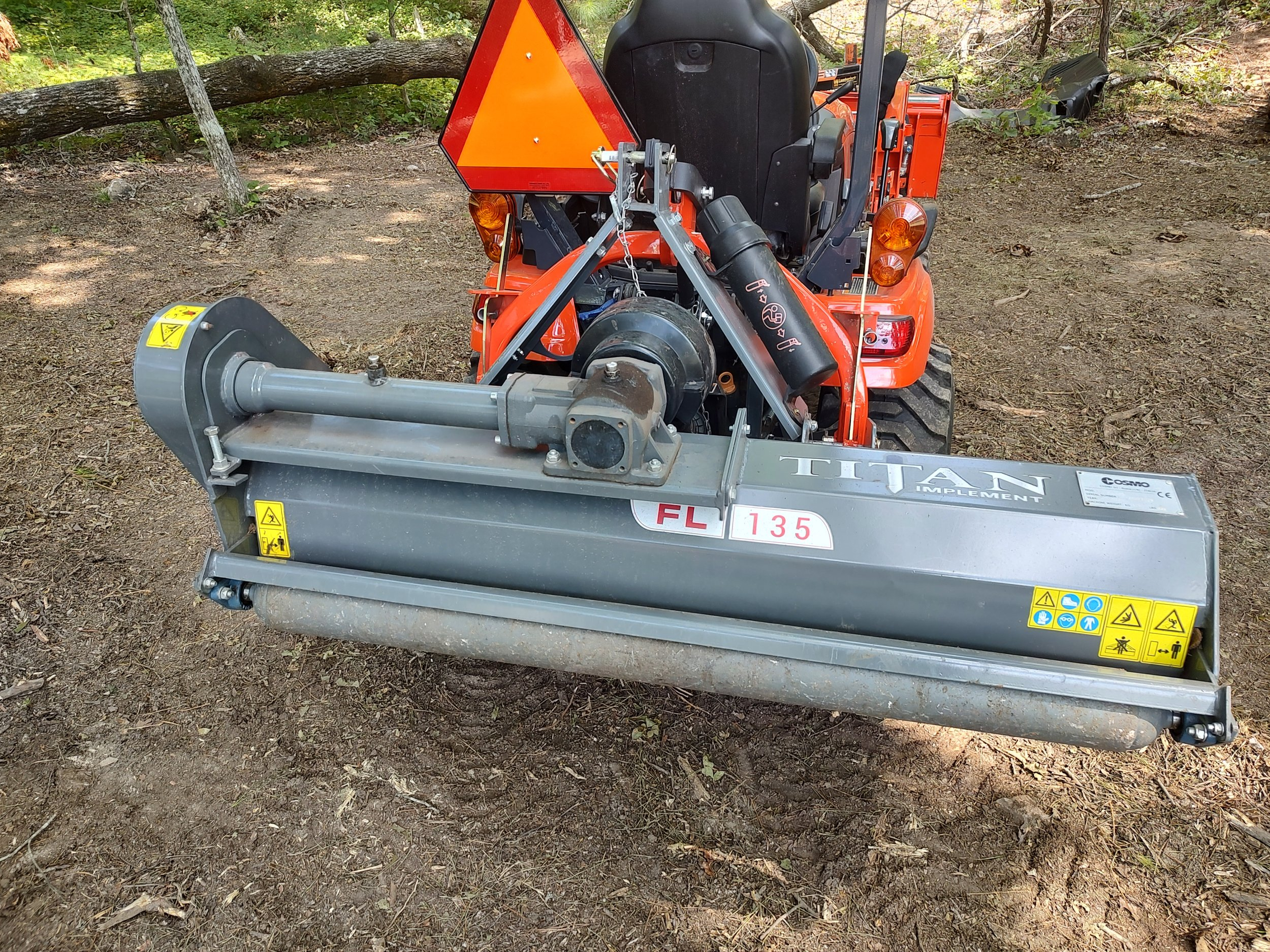

New tractor owner and first time poster here.
After reading a lot of this thread and some others, I settled on a flail mower instead of a brush hog.
I ended up getting this Titan FL135 from a dealer in my state. Apparently these are not very popular in Alabama and this dealer was the only one I found that stocked small flail mowers.
I haven't seen much info out there on this model, so I thought I would share.
This is an Italian mower made by Cosmo and imported by Titan Implements (not palletforks dot com). I paid $2000 for it at Dixie Horse and Mule Company. It came with hammers installed but also included the Y blades. I wouldn't say it's QH compatible but I was able to connect it to my QH.
My little Kubota BX has no problem at all running it and I have been abusing it quite hard clearing some woods. I have been very pleased so far.

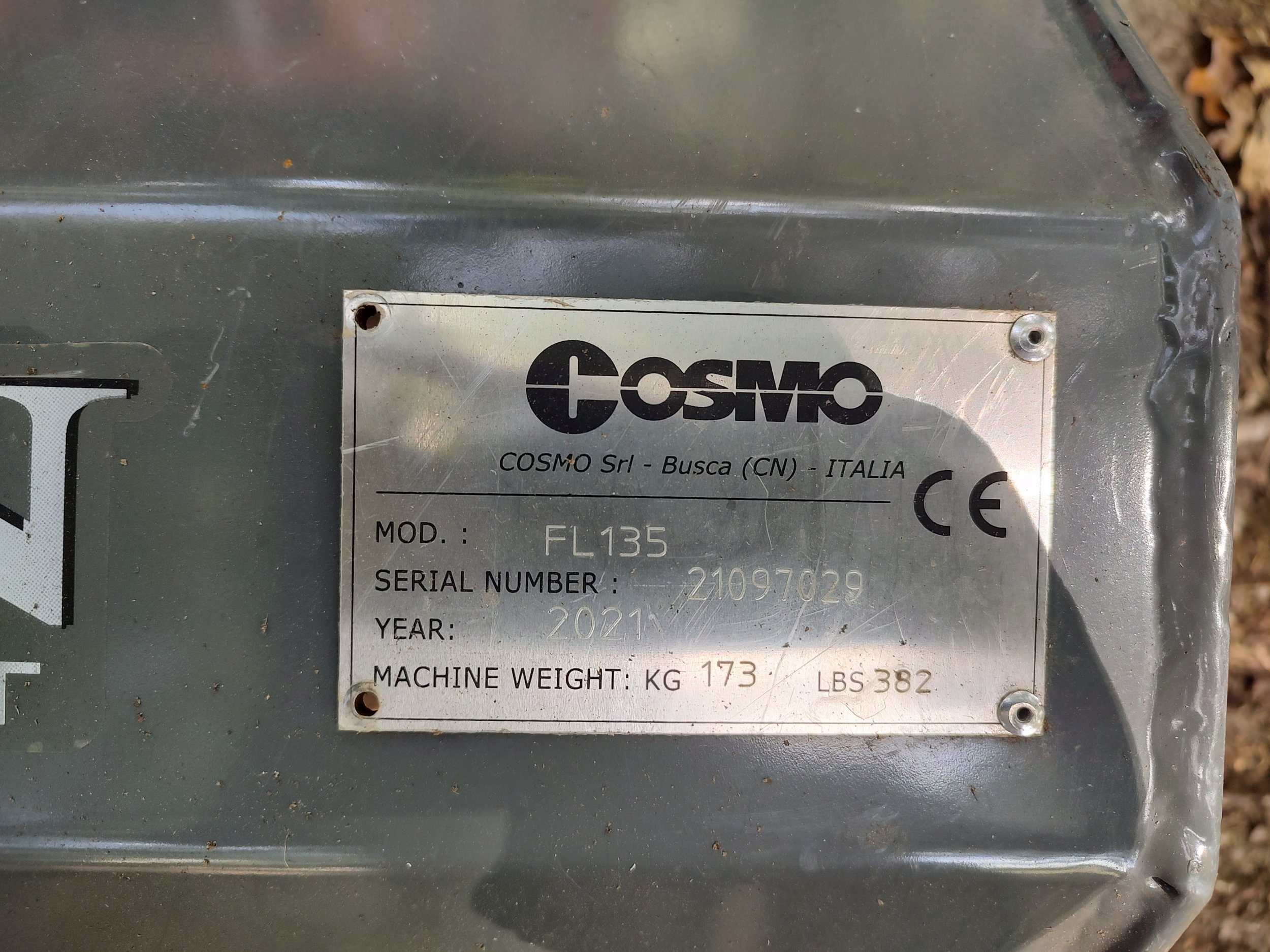

Hello and good afternoon Axelman,
I want to welcome you as the newest resident member of the "Flail Mower Nations"
from the Great State of Alabama.
You need to replace the two rivets on the mowers identification plate that are missing
with 2 small bolts and nylock nuts to hold it in place before you mow again.
You have a very well built flail shredder in you Cosmo flail shredder that was designed and built to the
European Union/CEMA farm equipment safety standards that will outlast your current mule and will provide
you with a high quality mowing and shredding finish.
Is the owners manual printed in a dual English/Italian language format?
