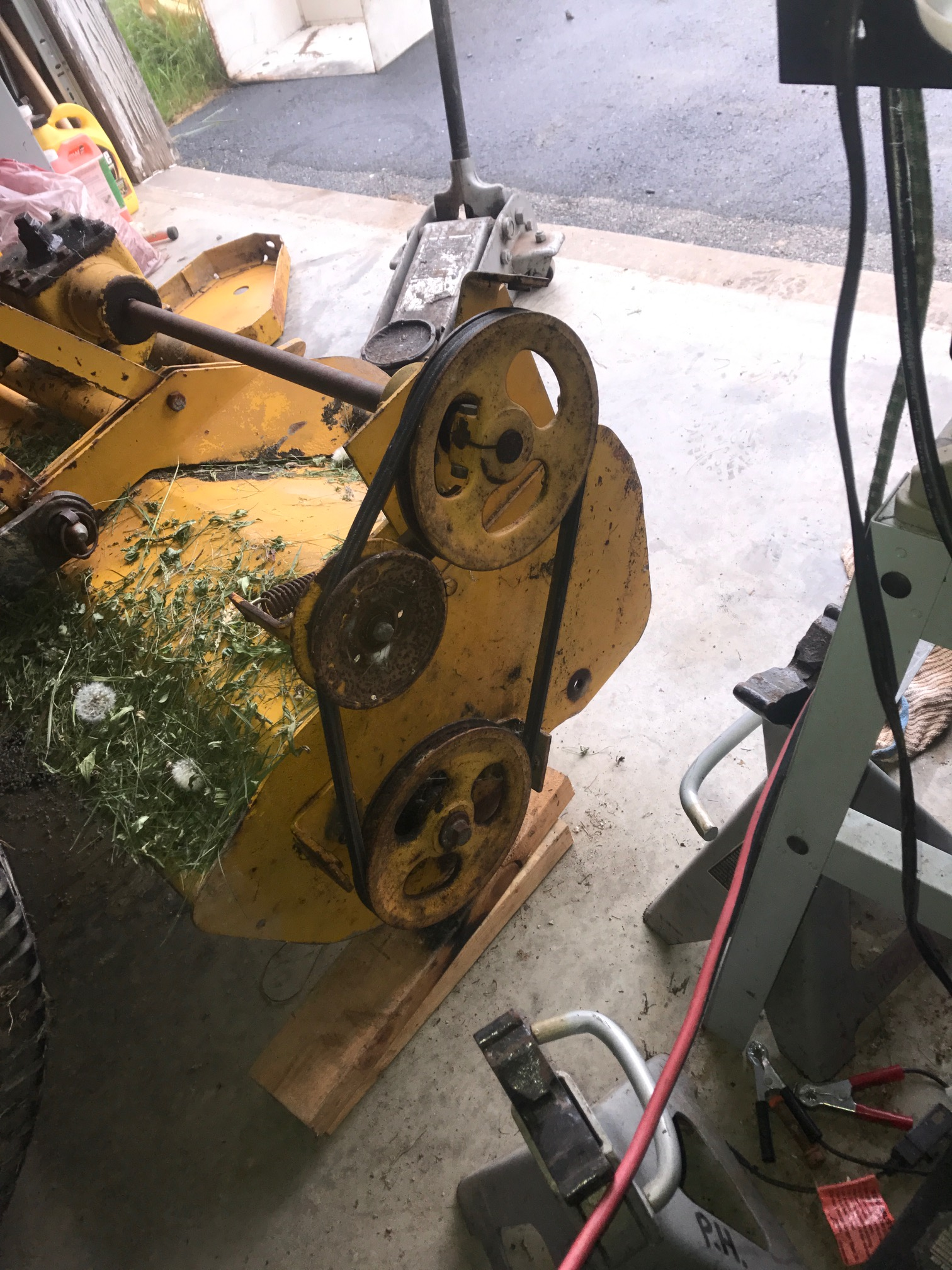

They did sell toe guards for the reverse rotation machines to keep that debris from hitting the back of the tractor. I doubt you'll find an OEM unit now, but you might be able to knock one out if you're decent at fabrication...
So yea, looks like the idler should be inside the belt on your unit. Still think that's a higher input RPM gearbox, but if it works for you otherwise, have at it once you get the belt on.

Thanks toolslinger. I think what you are saying makes good sense.
Thanks Xfaxman: agreed that the belt seems short. Thanks for the picture.
