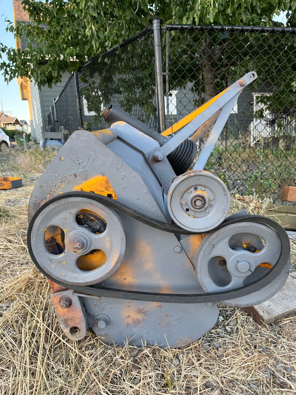

Curious if anyone knows how to replace the belt on a vintage Mott model 72? Is there a trick to making this fit? It is a factory belt but I couldn't find a green kevlar style belt. Thanks in advance

   / Let's talk flail mowers #7,593
The spring loaded idler pulley has to be pushed away (up) from the belt.
Turning the pulley will also help roll it into the groove of the pulley.
Then when you let it back down it will go on and let it will tension the belt.
   / Let's talk flail mowers #7,594
That idler looks odd compared to my Mott 72... Yours looks like a V-Groove pulley, and the idler, (both original, and replacement) on mine is just a flat face, without the deep V. I could see that being a pain to fit. That said, either pull it back, or disconnect the spring, and get the belt and pullies in place, then throw the spring back on if you must. I haven't been able to find a kevlar belt for mine either.

   / Let's talk flail mowers #7,596
dieselscou80 and toolslinger: thanks for the replies. the idler pulley does not move. It seems like it was fixed in a certain position. Perhaps welded along the base. I tried to remove the spring so the arm connected to the idler pulley could loosen. even with the idler pulley off the belt is too tight. Seems strange that it would be this tough. Thanks

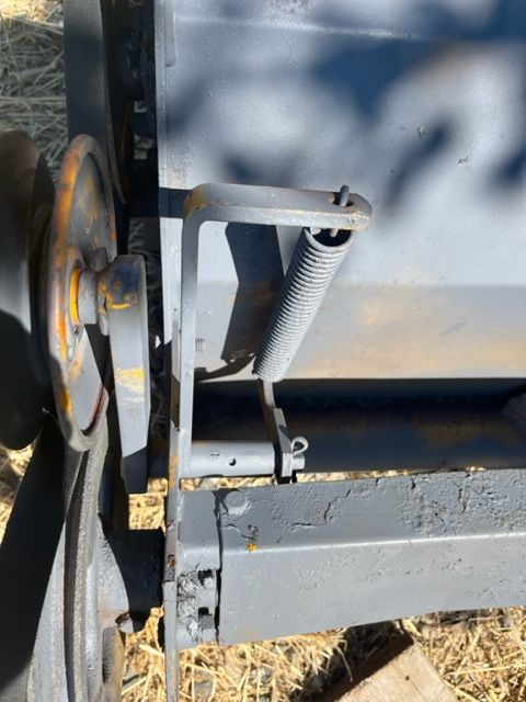

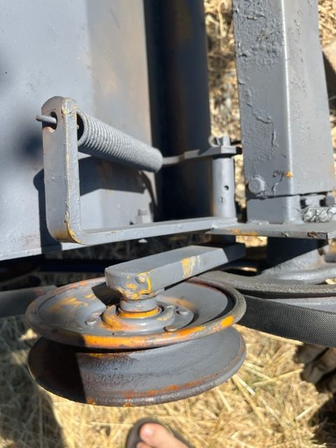

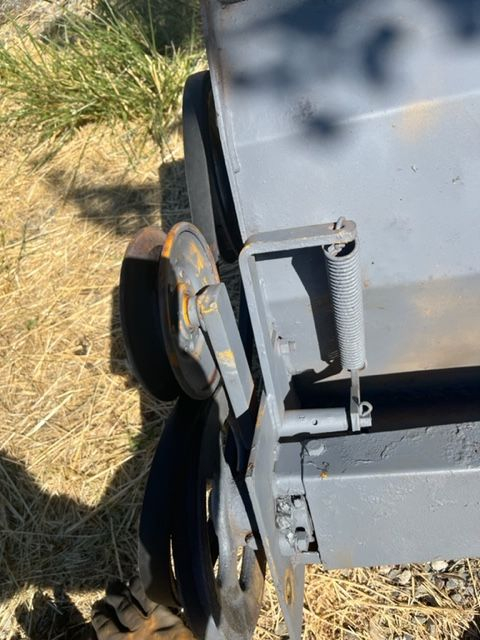

   / Let's talk flail mowers #7,597
Riddlewitz: That arm should move freely, and really has to, so you need to start there. It wasn't hard to take it off on mine, so unless they welded it for some reason, it is likely just bound up badly somehow. Could you take a photo of the arm that the spring is attached to? It kinda looks like it's on there backwards in the one photo. That would screw things up for you.
I also noticed that you've got the odd square gearbox on yours. I kinda recall that's for a higher input RPM than 540. Possibly a 1k unit? Don't know for sure, but it isn't a 540 gearbox.
   / Let's talk flail mowers #7,598
I wonder, since you've got a V pulley on the idler, and the tension spring looks backwards to me, is yours supposed to tension the belt from the inside, so it would make a triangle shape, rather than a kidney shape with the belt?
   / Let's talk flail mowers #7,599
Here are the pics. The irony is when it threw the belt it was working very well. I agree that this unit for sure has its quirks. It runs in reverse to my understanding. When I use it the grass clippings is thrown all over the back of the tractor. However I did put all new blades on the flail. It does chop the grass very well. If someone has this model and can post pics of their belt setup? thanks a ton guys.

   / Let's talk flail mowers #7,600
That means it is the wrong belt.
