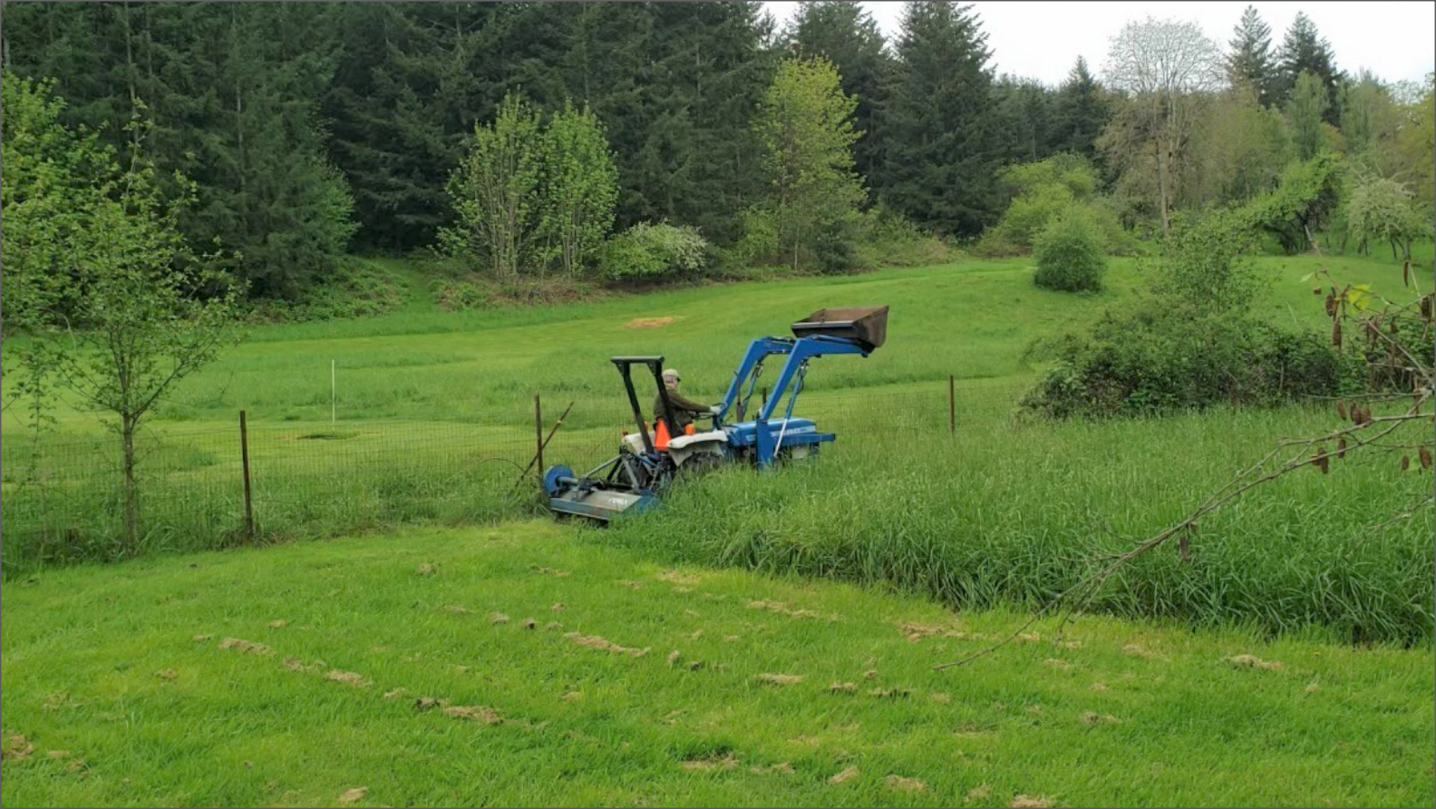

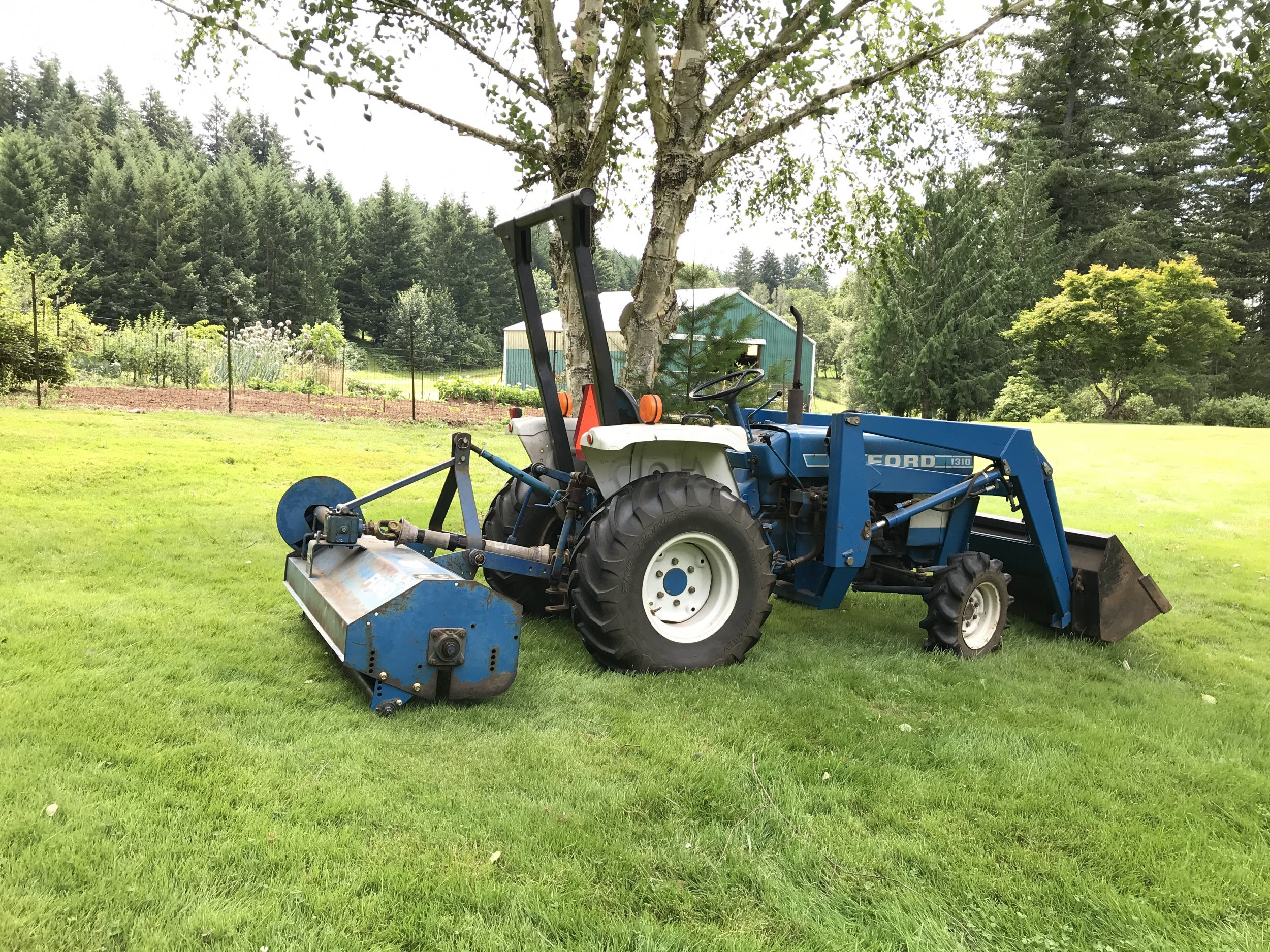

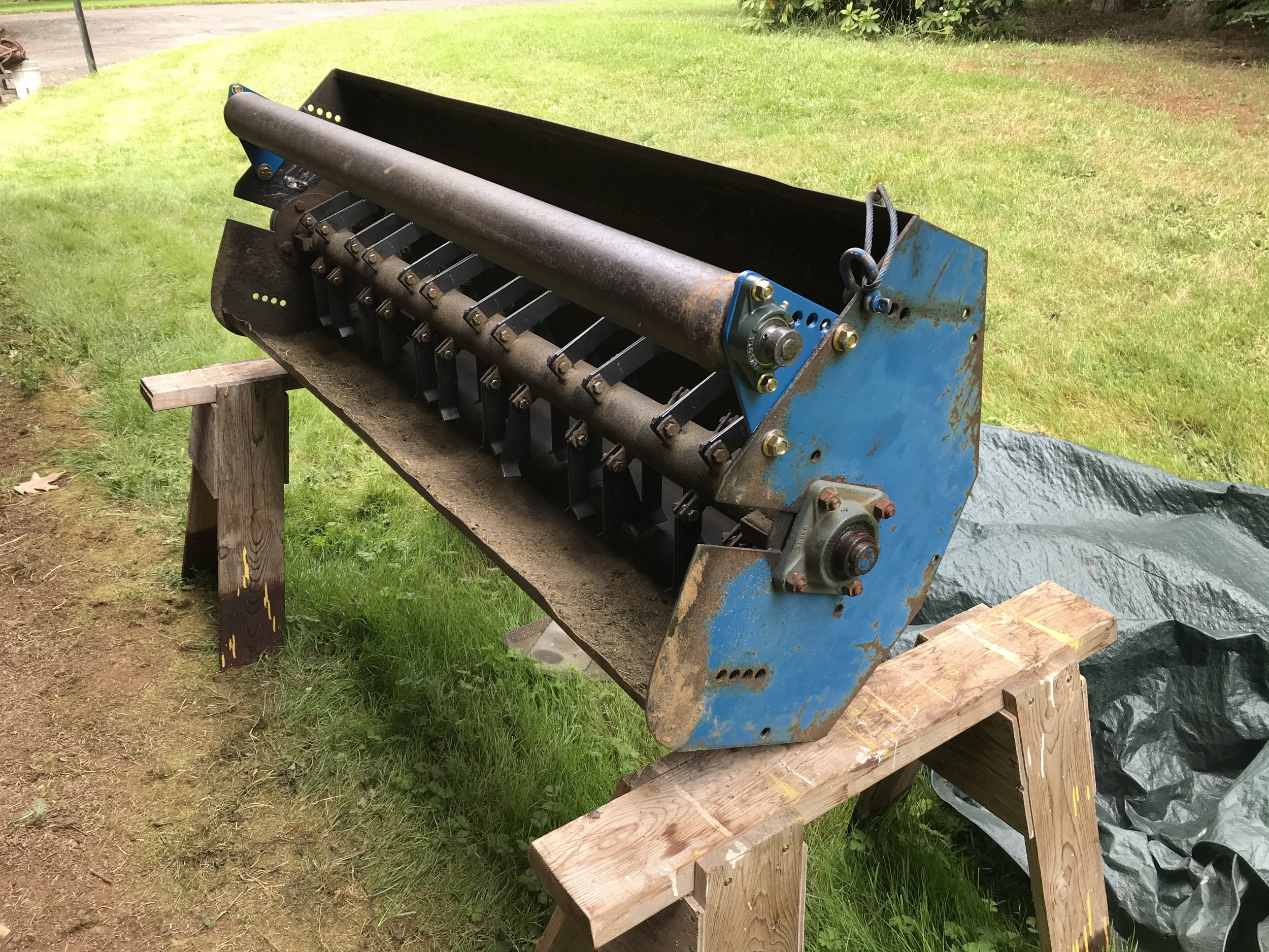

Maybe, maybe not - depends on type of flails, I think hammer VS. side slicer quite a different power usage.
Ford 1310 has 19 hp engine and is very capable running 5 ft Ford 917L flail mower with the 96 x side slicer flails it was designed for.
This mower was designed as a light duty model, to be used with side slicers only and it works well as intended.
May 2021 - pretty tall stuff due to wet spring.
Obviously need to mow more often for sure, but the ground had been way too wet previously.
View attachment 790732View attachment 790734View attachment 790735View attachment 790736

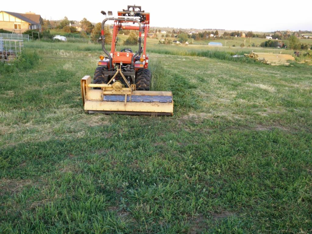

I upgraded from a 5' Land Pride Rotary cutter behind a 32hp Kubota L3200 HST. I got a $100 beat to hell 7' Ford 917. It was in rough shape, but when patched together did some work. I had to go way slower, but my hours per acre was roughly the same. My back was happy to be bouncing over fields at a lower speed.
My general thought is if you can lift it, you can spin it.
I currently have a Kubota L4060hstc. Much heavier & cabbed, but only 40hp. I'm now running a little over 7' Peruzzo flail that probably weighs double what the old Ford weighs. Minumum HP according to Peruzzo is 60 or so. No idea if thats engine or PTO, but at best im 2/3 of their recomendation. When hitting some 2" scrub oak at crawling speeds I'm hurting on HP but the flail is fine. Interestingly, heavy tall grass makes me go even slower. I should upgrade to more HP, but it does the job fine for my side hustle & is paid off. Again, going slow gets the job done. Much easier to do with a HST than geared machine, especially in varied conditions. It's drier here in Colorado, so less vegetation than places with rain. I'd bet I'd be gard pressed to run this setup in Oregon.

I get the raised tire tracks behind both the beat to hell Ford with side slicers & the Peruzzo with hammers.
The Ford sounds like a train wreck or a metal trash can rolling down a hill. That's mostly due to a slightly bent rotor & a hood that is nearly cracked in half. It's still a good backup though. With every penny of the $100 I paid for it & the $400 of parts I've put into it over the past 8+ years for my yard & side gig. Not worth fixing anymore, but good enough to keep as a backup.
The Peruzzo isn't silent or anything, but it's better than the Ford. Not hugely different than a rotary.
