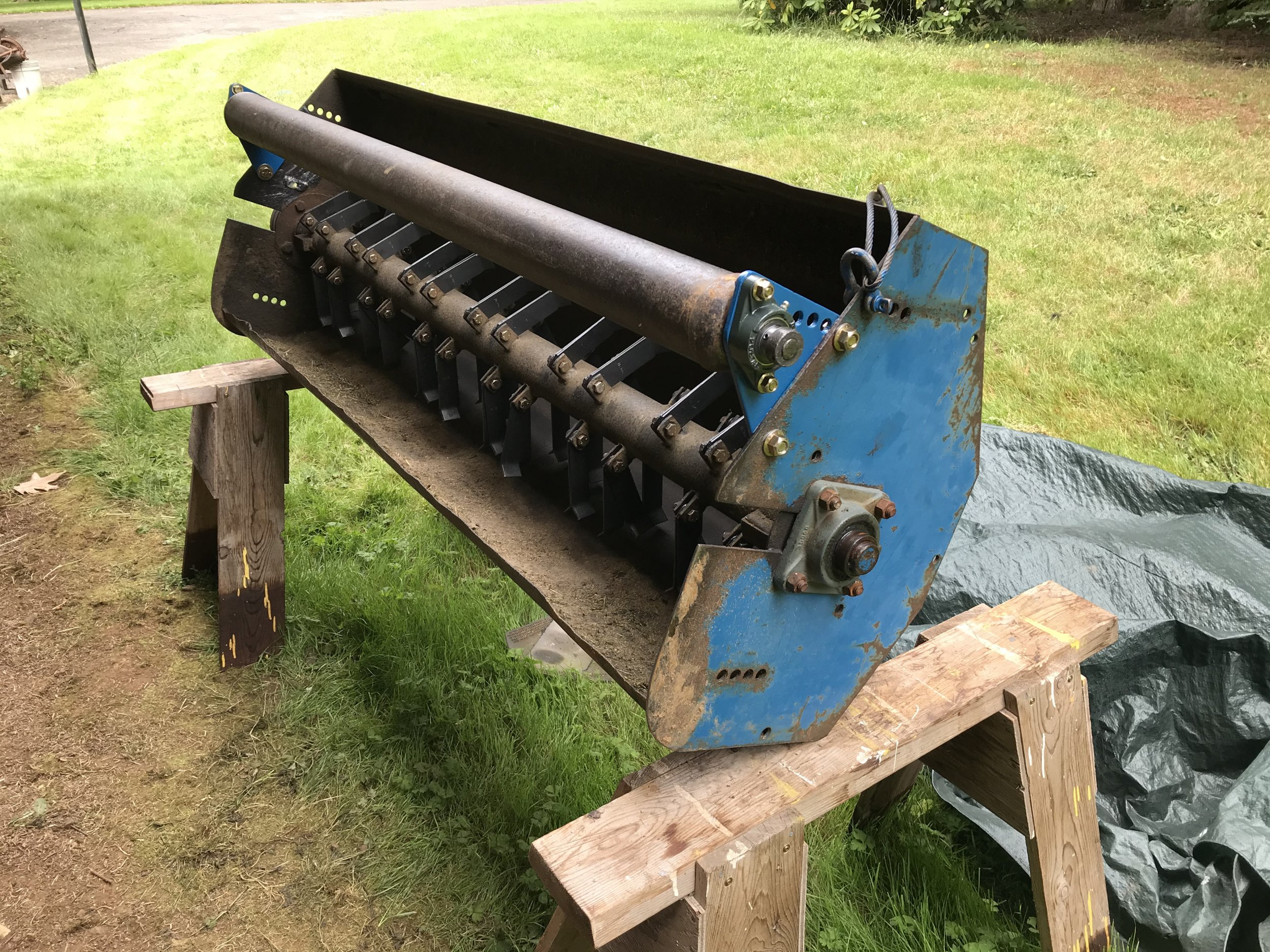

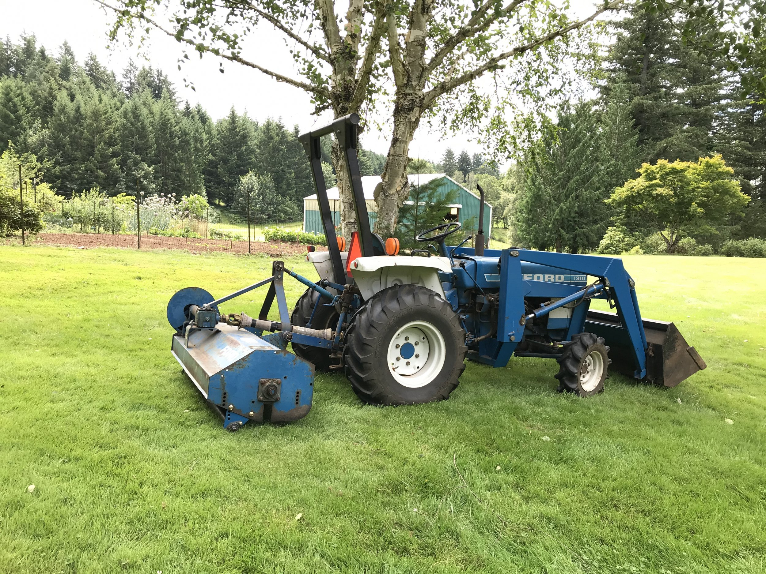

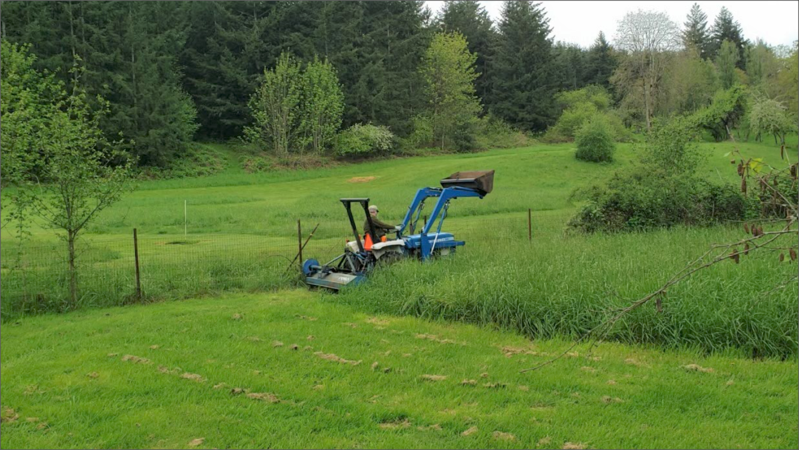

Maybe, maybe not - depends on type of flails, I think hammer VS. side slicer quite a different power usage.
Ford 1310 has 19 hp engine and is very capable running 5 ft Ford 917L flail mower with the 96 x side slicer flails it was designed for.
This mower was designed as a light duty model, to be used with side slicers only and it works well as intended.
May 2021 - pretty tall stuff due to wet spring.
Obviously need to mow more often for sure, but the ground had been way too wet previously.
Cheers
   / Let's talk flail mowers #7,749
View attachment 790732View attachment 790734View attachment 790735View attachment 790736
Cheers
Yup, as always it depends. Reclaiming overgrown stuff or tall green grass is the hardest and requires more HP, or smaller bites and slower speed. But if you are maintaining, you can run as big a flail as the tractor will lift. It is all about how much material you have to move through it.
