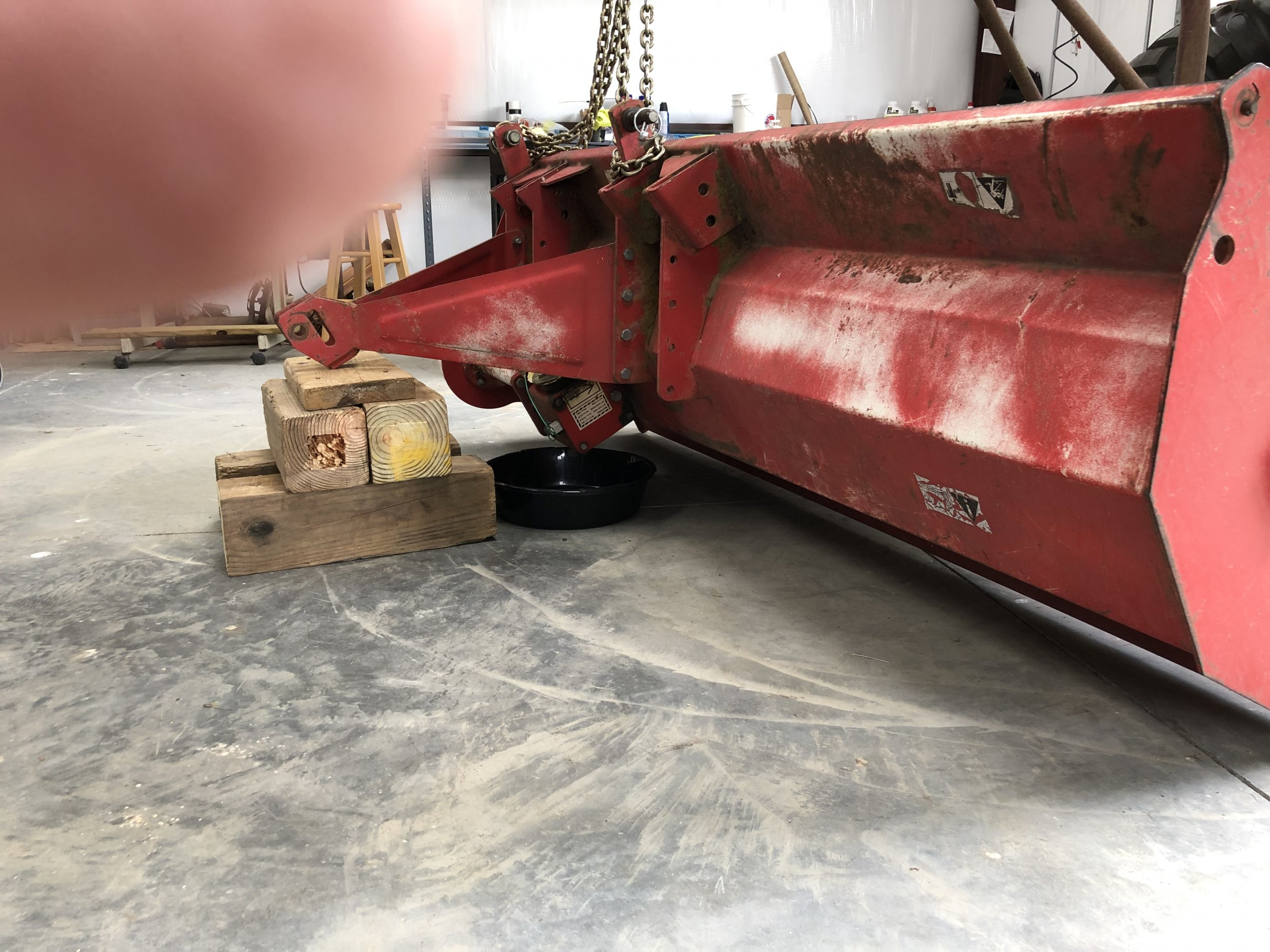

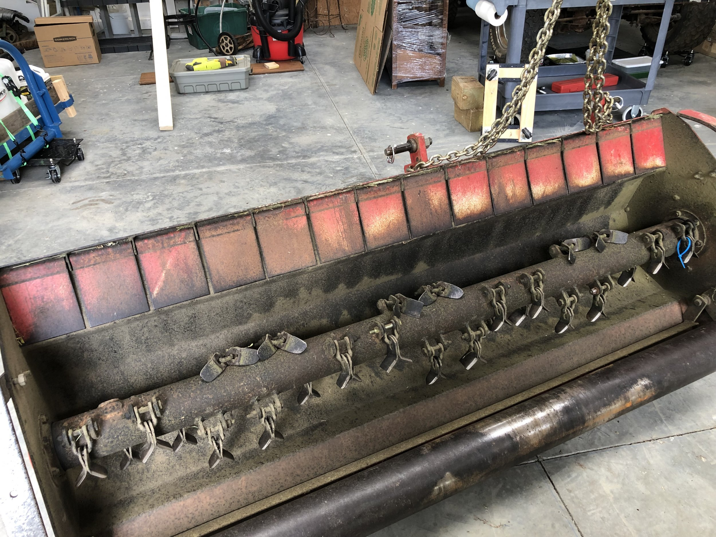

Time to sharpen all the hammers on my mower - Going to figure out an easy way to do this with lying on the ground. Initially thinking of lifting it with the bucket and a chain.
   / Let's talk flail mowers #7,736
Mine are due for a sharpening as well.
I raise the 3pt and shorten the hyd. top link. That gives me plenty of room to sharpen while sitting on a stool.
  • Good Post
Reactions: JWR
   / Let's talk flail mowers #7,737
When I replaced the blades on my Caroni last year I found rolling it over backwards on the ground worked really well. I did plug the gearbox breather plug first. That way I knew it was stable and wouldn’t squish me 😁
  • Good Post
Reactions: JWR
   / Let's talk flail mowers #7,738
Don't forget the jack stands!
