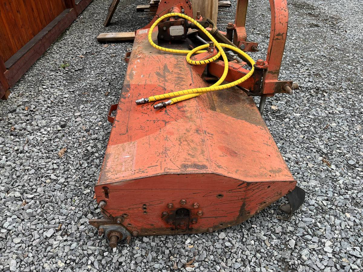

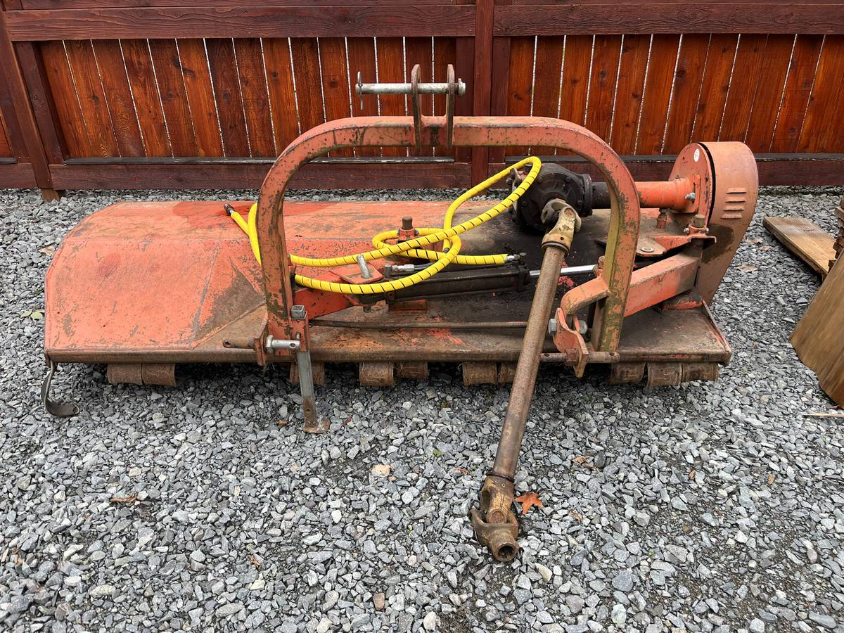

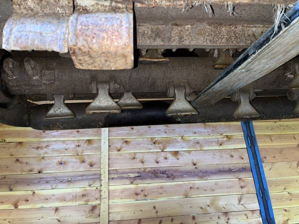

Good afternoon all,
I have a possible opportunity for what appears to be an older Seppi SMO 200, hydraulic offset flail mower. Images at bottom of post.
The ad copy indicates that it is a 6' cut, very heavy duty, and estimated it weighs 1000 lbs and runs it with a 60 HP case tractor. The ad description also indicates that the unit is functional, "but needs some love". It looks like the gearbox has a leaking seal or two. The hitch, frame and rear roller all look to be in straight condition.
My questions to the group:
1. I have a Kubota L48. The specs indicate a 880 lb max implement weight on the 3 point hitch. Can anyone confirm the weight of the Seppi SMO 200?
2. Can anyone confirm the HP requirements of the above referenced mower?
3. In light of what appears to be a somewhat older piece of equipment, can anyone give me any idea what parts availability might be like for a Seppi flail mower?
Thank you in advance for your time.
Doug

First of all, your max weight on your 3-point hitch is 3308 lbs. for your L48 hp is 48 . . . so you have plenty hp there to do the job. It's hard to judge from pictures . . . it looks like a little older model but built med duty ?

Hi Doug,
That looks like a pretty well built older mower but as you already know it will need some work.
I would pull out the belt cover and see how the tension is adjusted - IE. is there idler or not and condition of pulleys, do the best you can to check the bearing condition etc.
It looks like there is adjustment on the gearbox output shaft so there may not be any idler at all?

Mo,
Thanks for the reply. I saw the 3000+ lb spec listed on the page 10 table. But for the max implement weight (W1)/size, the page 10 table refers the reader to the table on page 11, where the 880 lbs is noted. The 880 seems rather light to me.
I guess the main question really is- what is the weight of the implement, which will be a little bit of a mystery to unravel.
Thanks again for your thoughts.
Doug

Arto,
It is good to hear from you. There does seem to be some sort of adjustment visible on the output shaft. I would like to see a manual for the mystery machine, but that may be just wishful thinking. When I get the chance to see the machine in person, I will keep your suggestions in mind.
Thanks you,
Doug

I have an SMO 250 that looks like this mower only it is a little larger. I have ran mine with a New Holland T-2410 55hp total. It would rum the mower no problems. I always thought the tractor a little lite for this mower. I now have a tym t-700 and am getting the mower ready to run on the more powerful, heavier tractor. I spoke with Flail Master and they are working on getting me new hammers, bolts, and nuts so I can be ready for mowing season. I am hoping someone else can chime in with parts info as well.

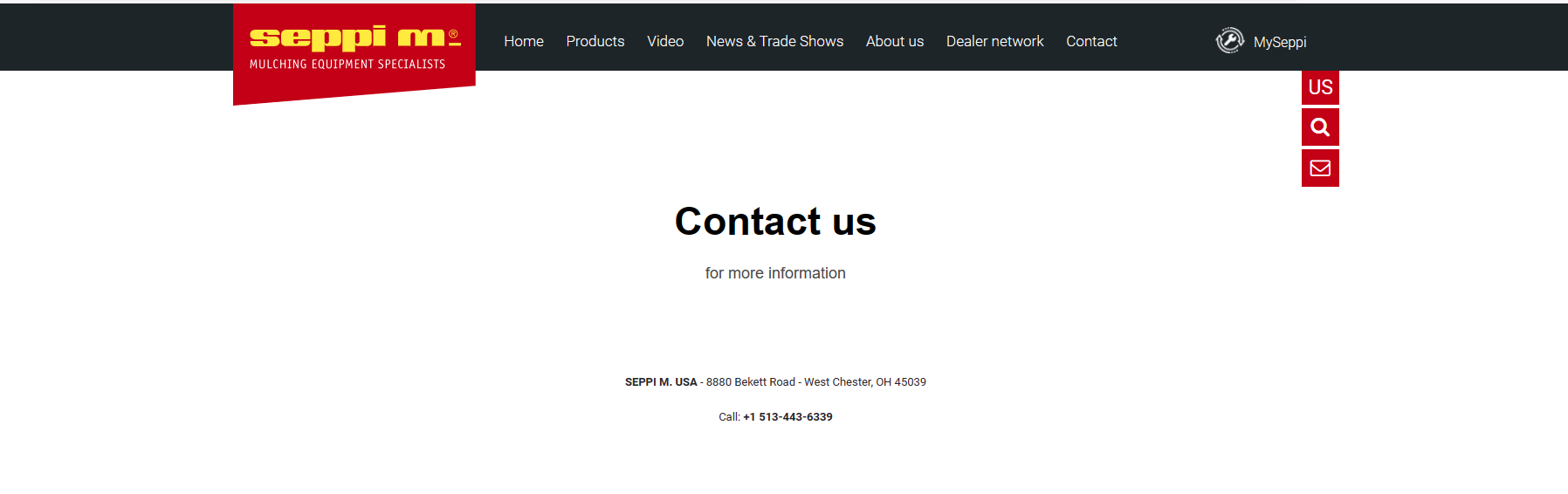

Here is a number for Seppi M in america---

I was able to learn some information on the mower today. I reached the regional distributor who was very helpful. He directed me to the local parts dealer, who was able to provide me with a PDF manual and give me an idea about parts availability and ball park costs. He also checked what the price for a new unit would be- approximately $12K.
Apparently, though it is an older unit, the SMO 200 is a current model. The working width is 79" and it weighs around 1,300 lbs. It sounds like my L48 might be a little light, though the horsepower is in the range (40-85), it is at the lower side of the range.
I am a little concerned about the overall weight. Kubota's specs on the weight are a little confusing the way the max weight on the end of the 3 point hitch arms is 3,748 lbs, but the max implement weight is 880 lbs. I guess I do not understand why there is such a huge disparity between the two spec numbers.
Anyhow, I am going to go look at the machine tomorrow morning, with my trailer. He will have the mower on his tractor to demo it for me, so I should be able to get a better feel for what the required capability might be. If there are any words of wisdom to share, I would be interested in hearing them.
Thanks again everyone for the input,
Doug

Are you going to be using the mower/tractor and different locations? If you are using it primarily in one location I wouldn't be too concerned about the weight. 95% of the time it will be setting on the ground being dragged by the tractor.
