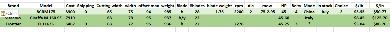

Does anyone have the John Deere Frontier FL11S series flail made by Maschio? I believe it's the Giraffa M series by Maschio.
