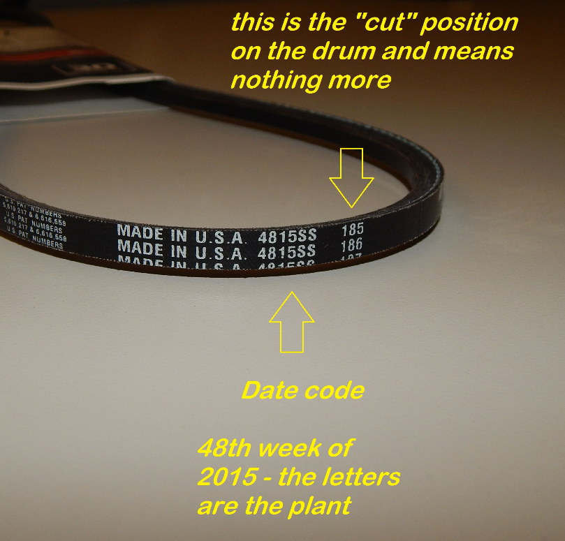

Manufacturers often provide a matching code on the belt’s label or packaging. This code indicates that the belts have been factory-matched to ensure "identical length" and performance. If available, using belts with the same matching code is the easiest and most reliable method to identify matched V-belts.
Any parts supplier not understanding or saying they do not do that anymore is shall we say miss informed. In a situation calling for matched belts if one is shorter than the others it will be the one doing all the work wearing it out more quickly.
You might want to check your sources before assuming that a parts supplier who claims they are no longer available is "misinformed".
A number of belt manufacturers no longer even offer matched length sets. Their manufacturing tolerances are tight enough on many of their offerings that they match within the original specification for what was once considered matched belts. This is the response I got from Gates corporation in response to an inquiry to their tech support about the availability of matched sets of belts.
Hello – we do not offer matched sets – as close as you could get would be two out of the same plant – please see below on how to determine this
Gates Corporation​
Gates General Inquiry​
You have received a new form submission from the Gates.com Contact Us General Inquiry Form. Please review the details and respond as necessary. For any questions on this form, please contact the Gates Digital Group
One recommendation I have seen is to adjust the tension so it is correct for the tighter of the two belts. Run it for a day or so, and then readjust the tension. The tighter of the two belts will have stretched more than the looser belt. (With aramid fiber belts, it's more important to be close to the same from the start, since they don't stretch much.)
