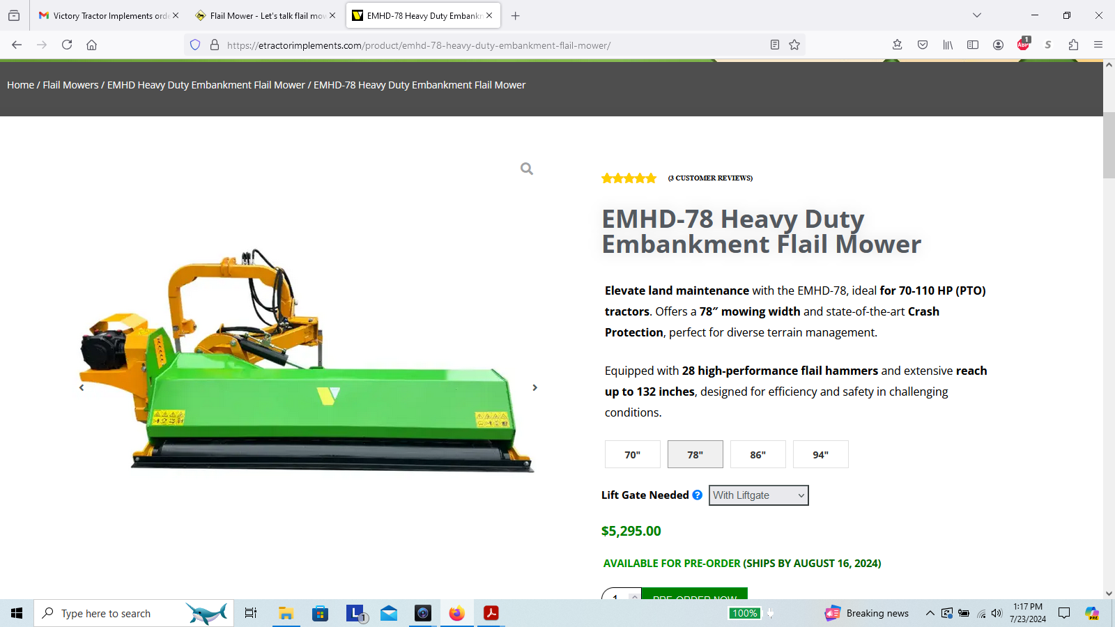

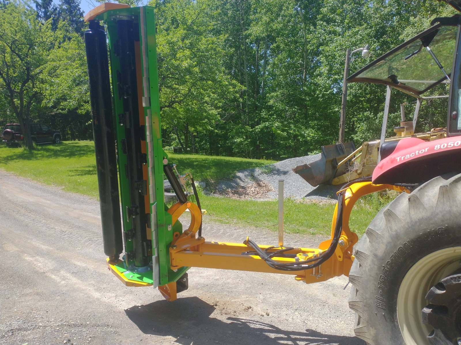

I'd also be interested in recommendations for a ditch bank mower for my M59 HST for cutting along field edges and fence lines to control weeds and brush. I have rocks and roots and fallen branches to deal with.

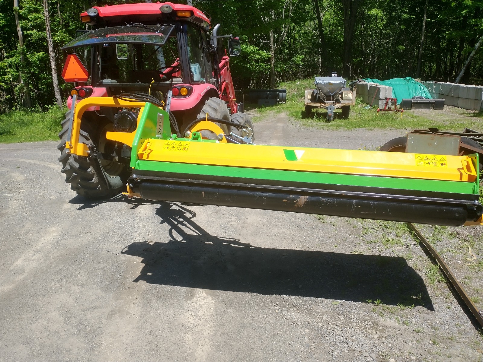

I have the chinnese version a Victory bank mower their heavy duty model in 78";

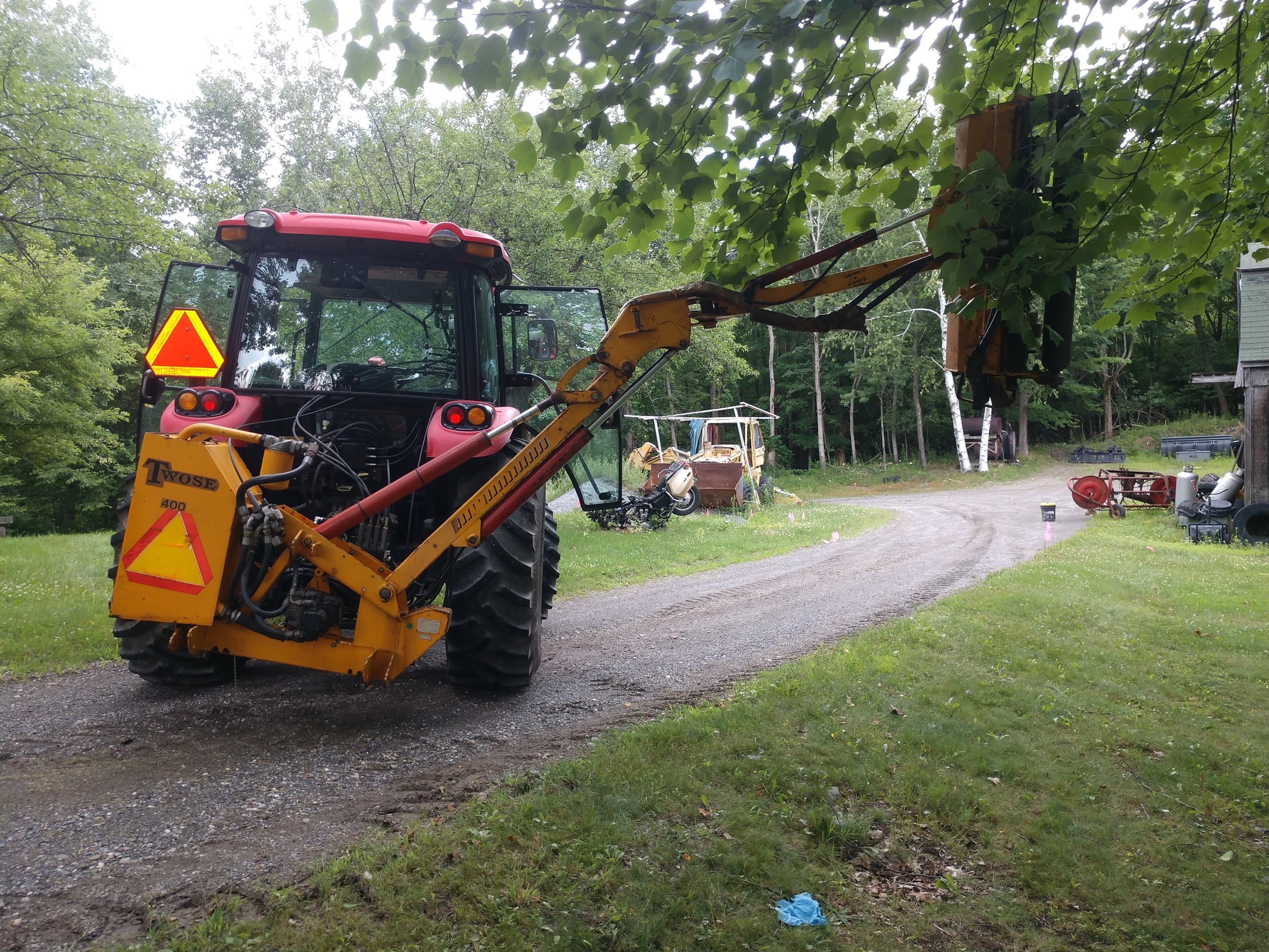

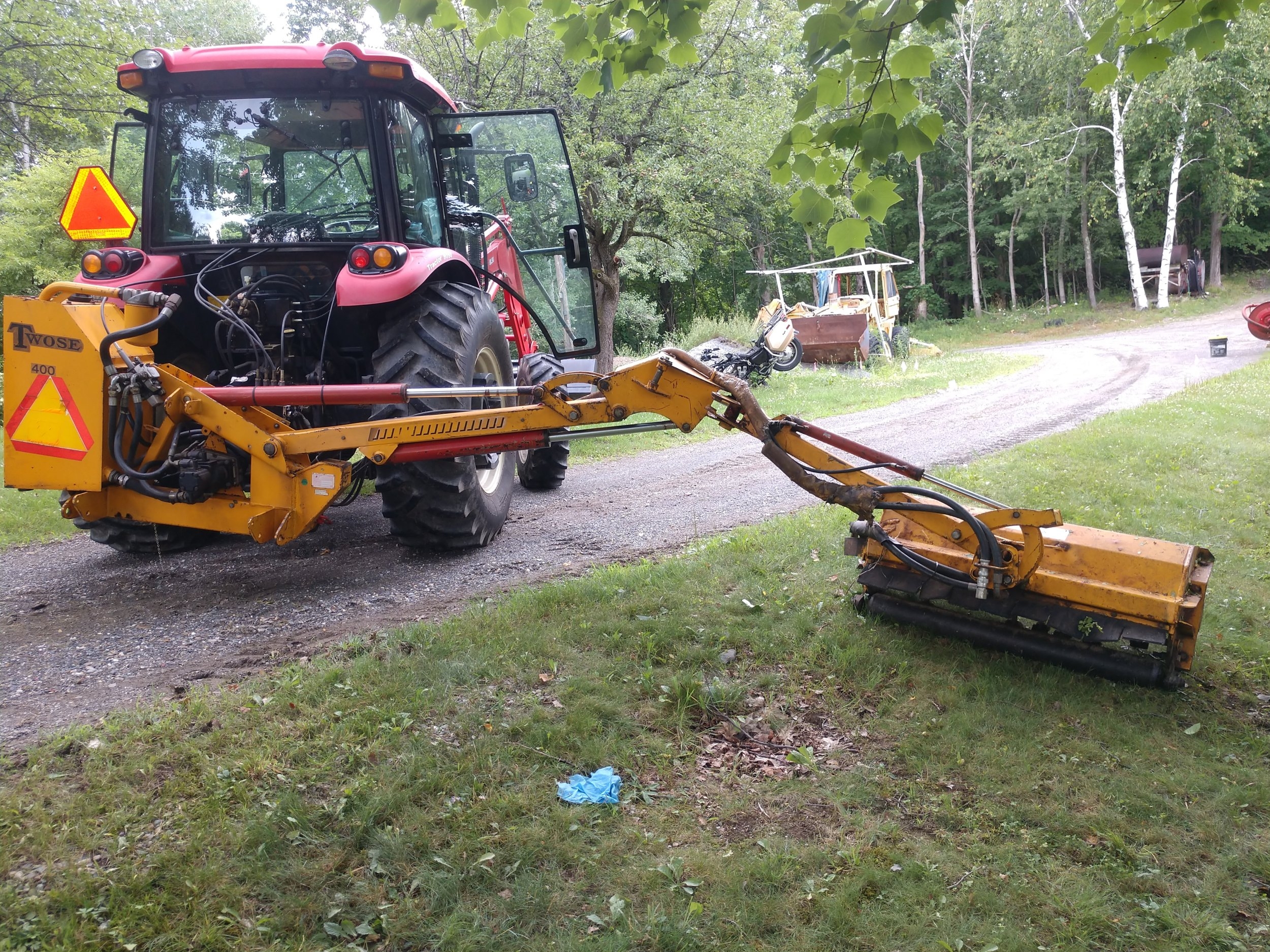

I also have a boom arm mower it's a Twose 400 hedge trimmer.
It is a heavy mower and it makes my Branson 8050 bounce around a wobble a bit especially when you get everything off camber. One of these days I'll mount it on my NH 8160 to see how much better it feels.
The ditch bank mower,

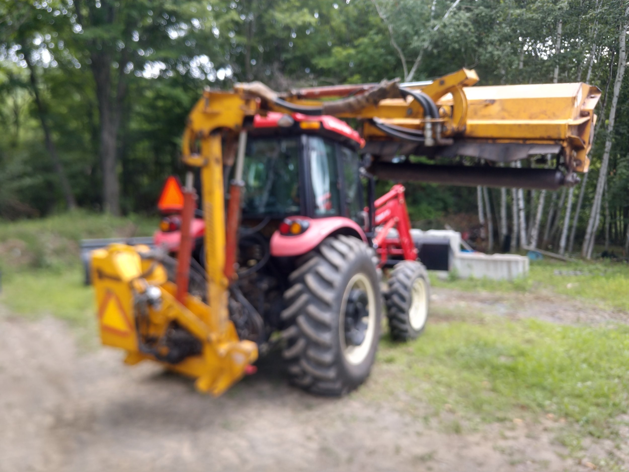

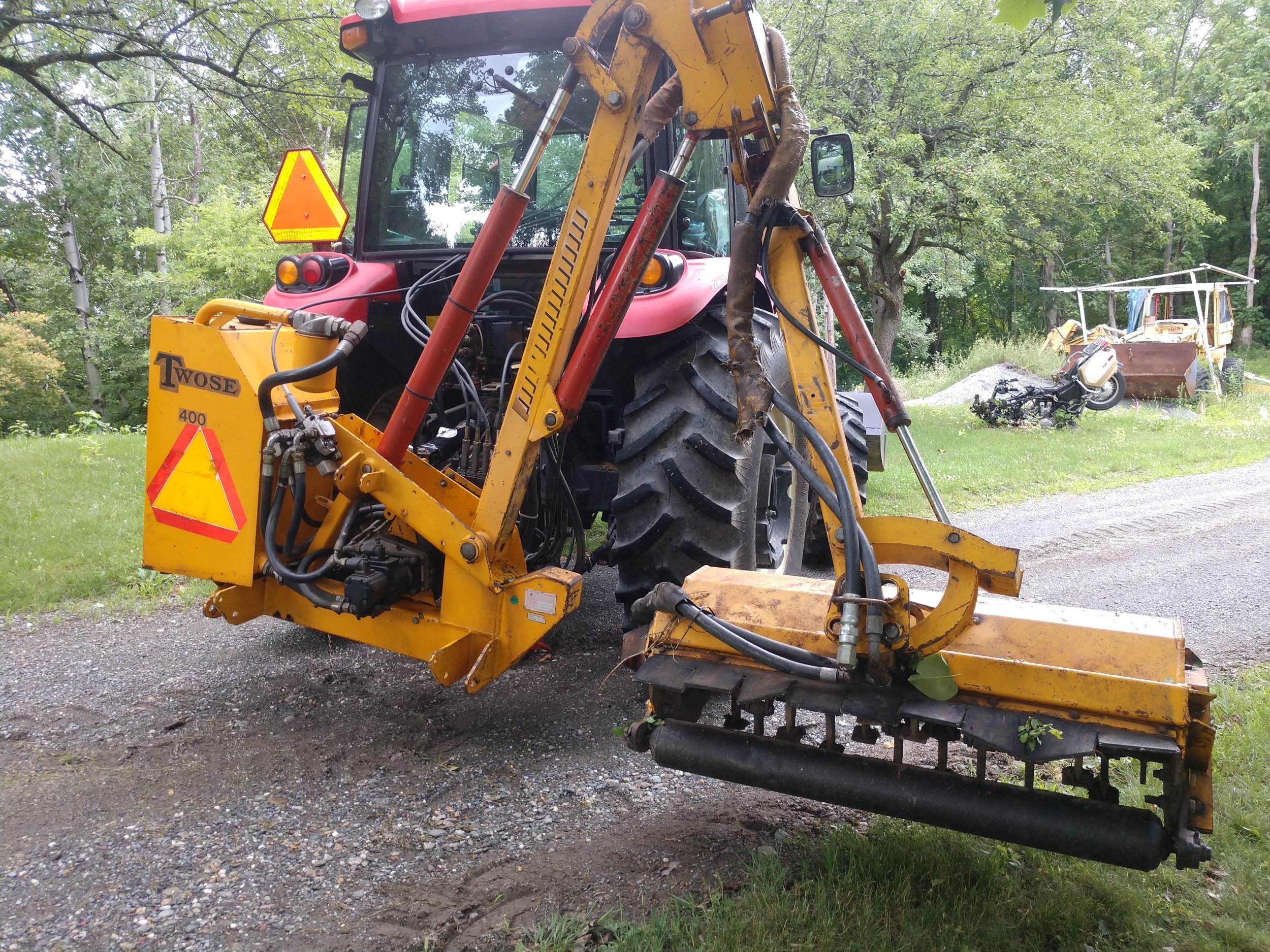

And this is the boom arm mower, it is also a handfull at times on a tractor that's tipping the scales at a bit over 11,000 pounds before the mowers.

Both mowers are very handy and do a good job, the ditch bank mower is faster to hookup and cuts a wider swath and is a bit easier to work with.
The boom arm mower is much more versatile and has more reach, it also takes much more attention while mowing as the terrain changes and obstacles get in the way.
They both have their place and I use them both at times along with a brush hog.
Both of them are equipped with "hammers" not the Y blades.

The county "mows" the side of the local road with one of those, varying ground as well as in a vertical position to shred the tree/shrubs as they grow back every few years to crowd the road.

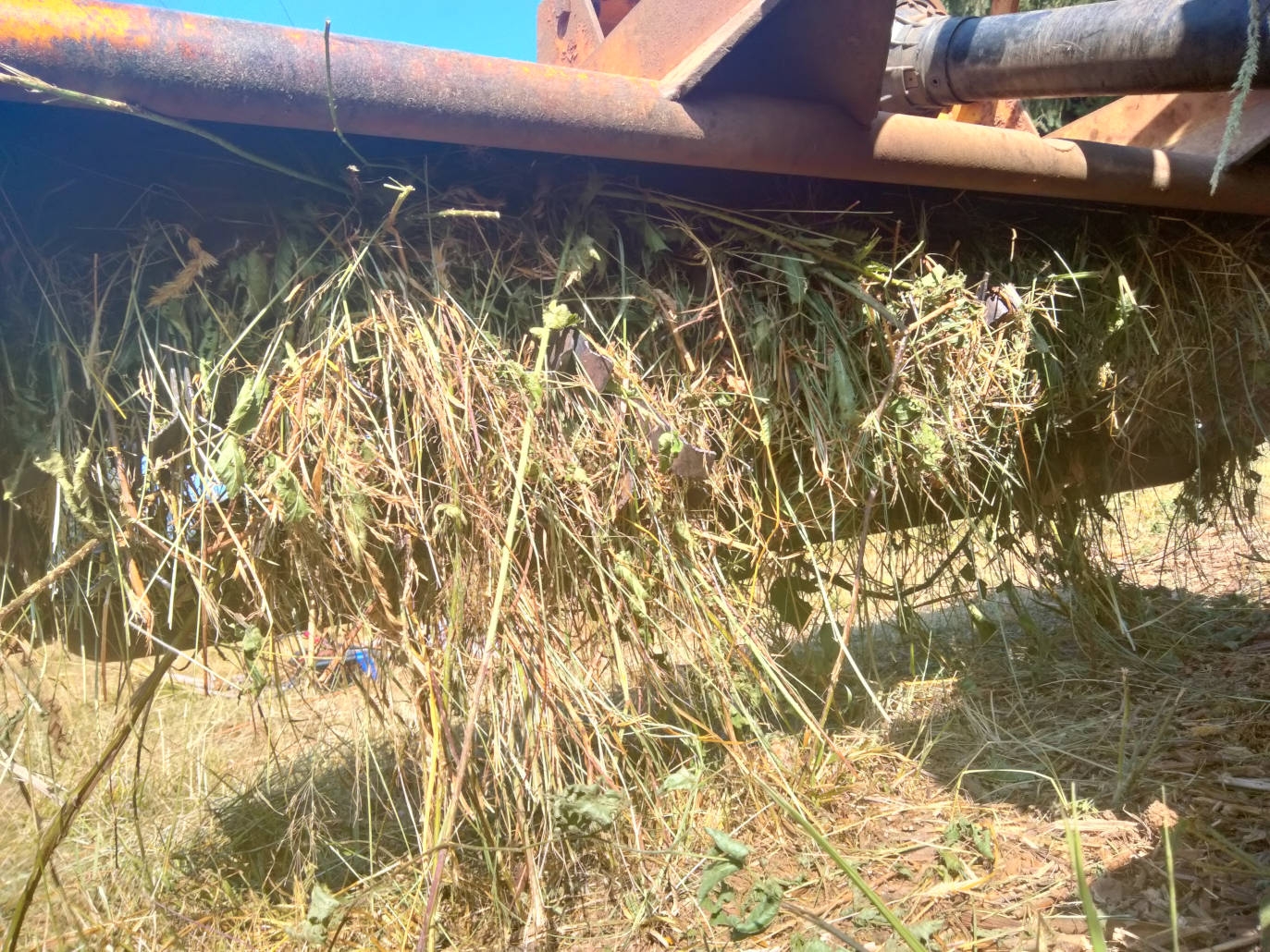

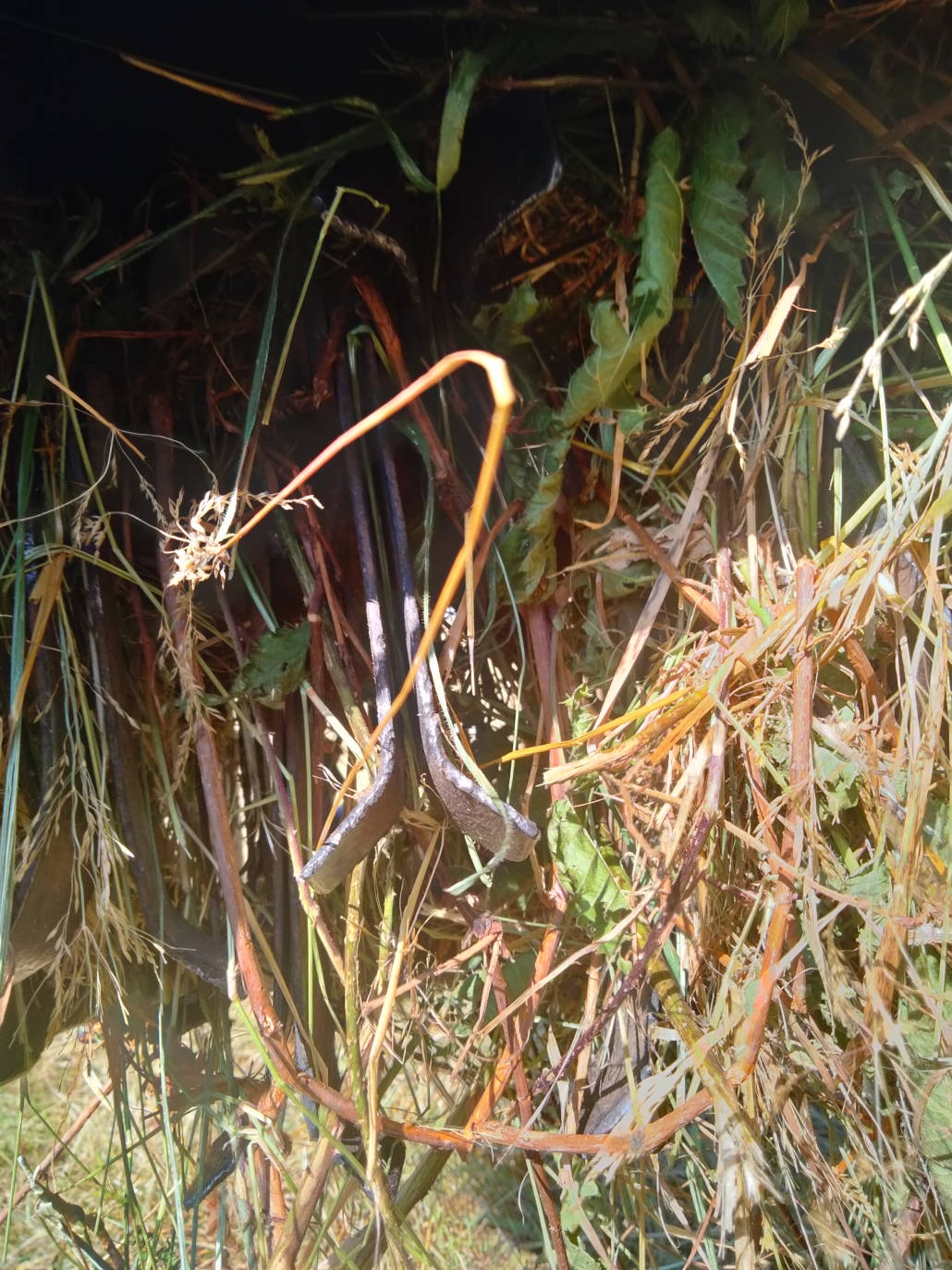

OOPS!!!!!
The blades seem to be holding up fairly well to some hard abuse. But I may start hunting for a new set, or try to make my own.
4130 Chromoly?

OOPS!!!!!
View attachment 883399View attachment 883400

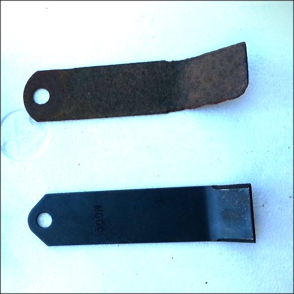

Wow what was that, was it just weeds or did it have some wire mixed in?
Couple of years ago I bought two new sets of 96 side slicers from Flailmaster at excellent price and they have stayed pretty sharp so far!
Not sure what kind of steel, but it's very hard.
Old Vs. new:
It was a mixture of grass and blackberries. I have a mixture of the larger Himalayan blackberries, and a local variety that my neighbor calls "mountain blackberries" with smaller berries, and a very tart taste, and they come about a month before the Himalayan berries. But those mountain berry vines are very stringy, and I had some of those balled up in it. No wire.
Still, with a few stickers, a mess to pull it all out.
