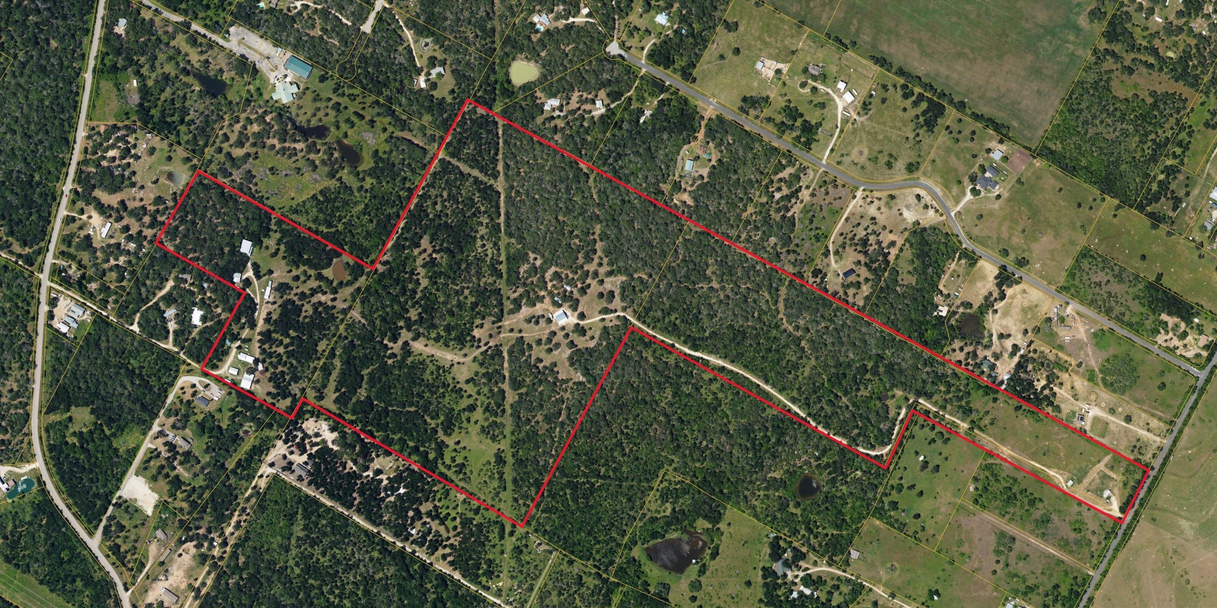

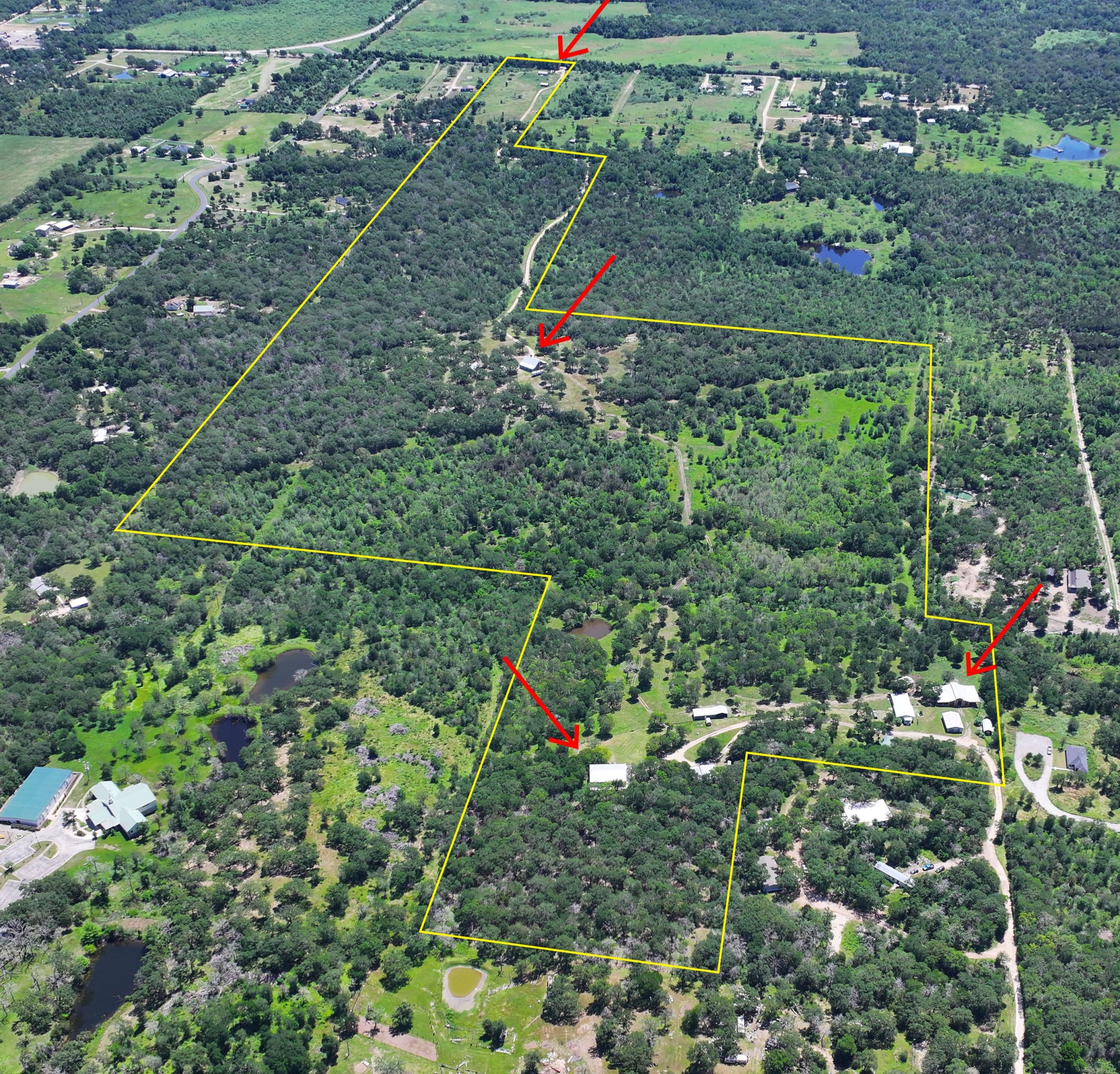

I am brand new to all of this and need a recommendation for a flail mower to pull behind our new JD 5090E: 90hp engine, 75hp PTO, 8000lbs, 92" wheelbase, cat 2 hitch.
A few weeks ago we closed on 92 acres just outside Austin, TX. Mostly flat with black clay soil. There are many unmaintained and overgrown acres that we want to clear and restore back to its natural Blackland Prairie state. The mower needs to be able to handle the heavy brush as well as provide good mulching (to help the native flora). We also plan to use the mower to keep some grassy areas and lawns cut and hopefully maintain some trails.
I figured a mower about the same width as the tractor would be a good balance between speed and maneuverability. Especially with the ability to side shift.
We need to start mowing very soon so availability will be a factor.
I have been looking at the following models:
  1. Maschio CORAZZA 210S/230S
  2. Del Morino FARM 214
  3. Peruzzo Bull 2200
  4. WoodMaxx FM-96H
  5. Nova MXZ-220
The WoodMaxx and Nova are nearly 1/2 the price of the others, which makes me worry about their performance and reliability - but I know price does not always equal quality. I like high quality tools and am a buy-once-cry-once kind of guy, but obviously don't want to waste money for no reason.
They are all "heavy-duty" mowers, which I am not sure if we need, but the point may be moot as the HP of our tractor exceeds most of the light and medium duty mowers I have seen.
Is there any objective basis to the marketed max material diameter cut capacity? The Maschio CORAZZA claims 4" and the Peruzzo Bull claims 4-5" which seems crazy big while the WoodMax FM-96H describes it's hammers as for "clearing saplings 1in diameter or less" which seems quite small. The Del Morino doesn't make any claim at all. Are we talking 4" of fir, oak, or mesquite here?
Appreciate any and all advice. Thanks!

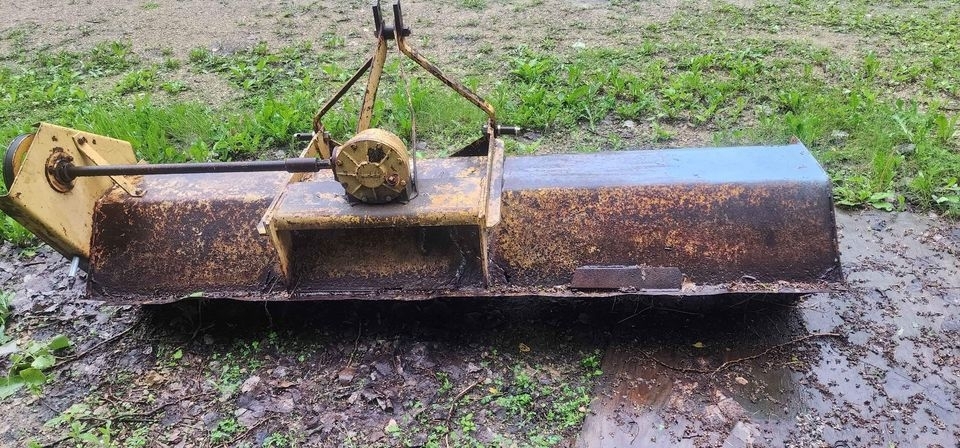

Need help identifying this flail mower that I am planning on buying ... I know it need some knives and ? Thanks for your help.

Does it have a roller in the rear (don't see one in your photo)?
