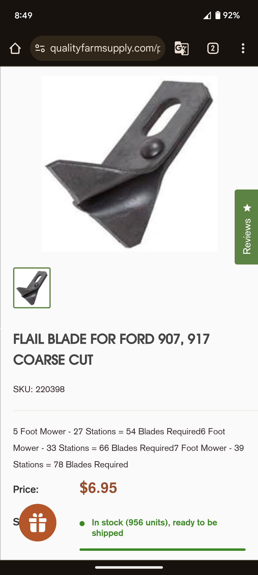

If you are in need of flail mower blades for the Ford 907 or 917 mower the ones from Quality Farm Supply have been excellent. Have had them on my flail now for 4 years cutting 10 acres multiple times and year and still look pretty darn good. The blades are $6.95 per blade currently I ended up ordering multiple extras thinking I may break some with rocks but so far haven't but boy have I seen some sparks from a large rock wedging up in the mower. Only thing is my mower is the older manual tensioning type so have to keep the belt right, but I bought it for $100 so can't really complain.

Can you post a picture of the blades you are using?
