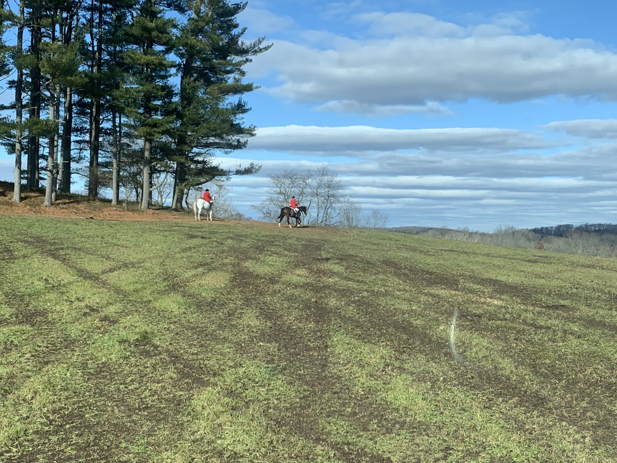

I just began working a field that’s new to me. The alfalfa and grass are in decent shape, but the previous owner allowed livestock and vehicles in the field when the ground was wet. As a result the ground is very uneven in a lot of places which makes me go a lot slower than usual.
Is there a good way to somewhat level the ground without damaging the existing stand?

The soil is clay loam.
The damage is widespread, at least a third of the field.
I was thinking of a chain or spike harrow to loosen and knock down the high spots, but I’m not sure it will be very effective, even if I add weight.

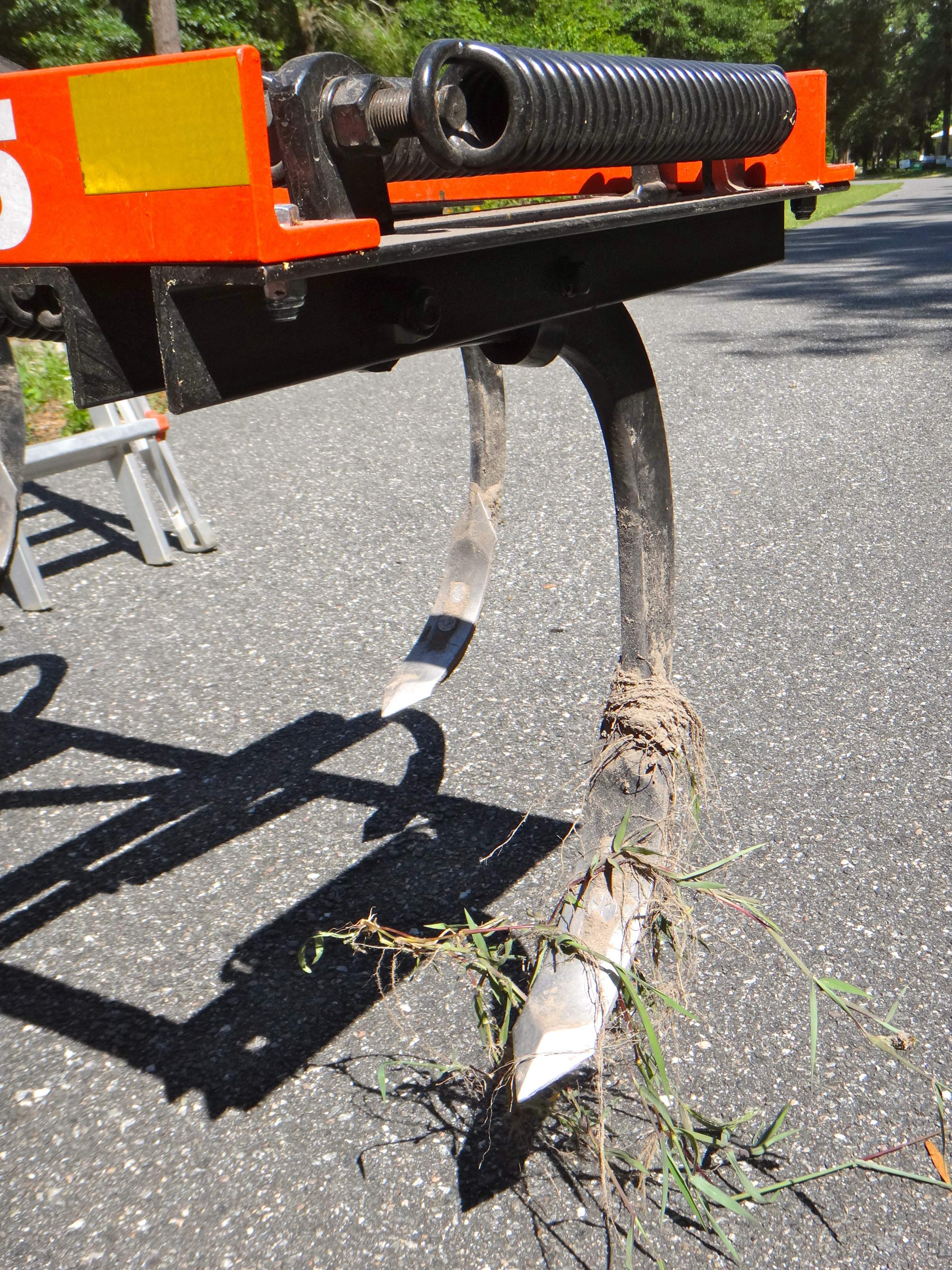

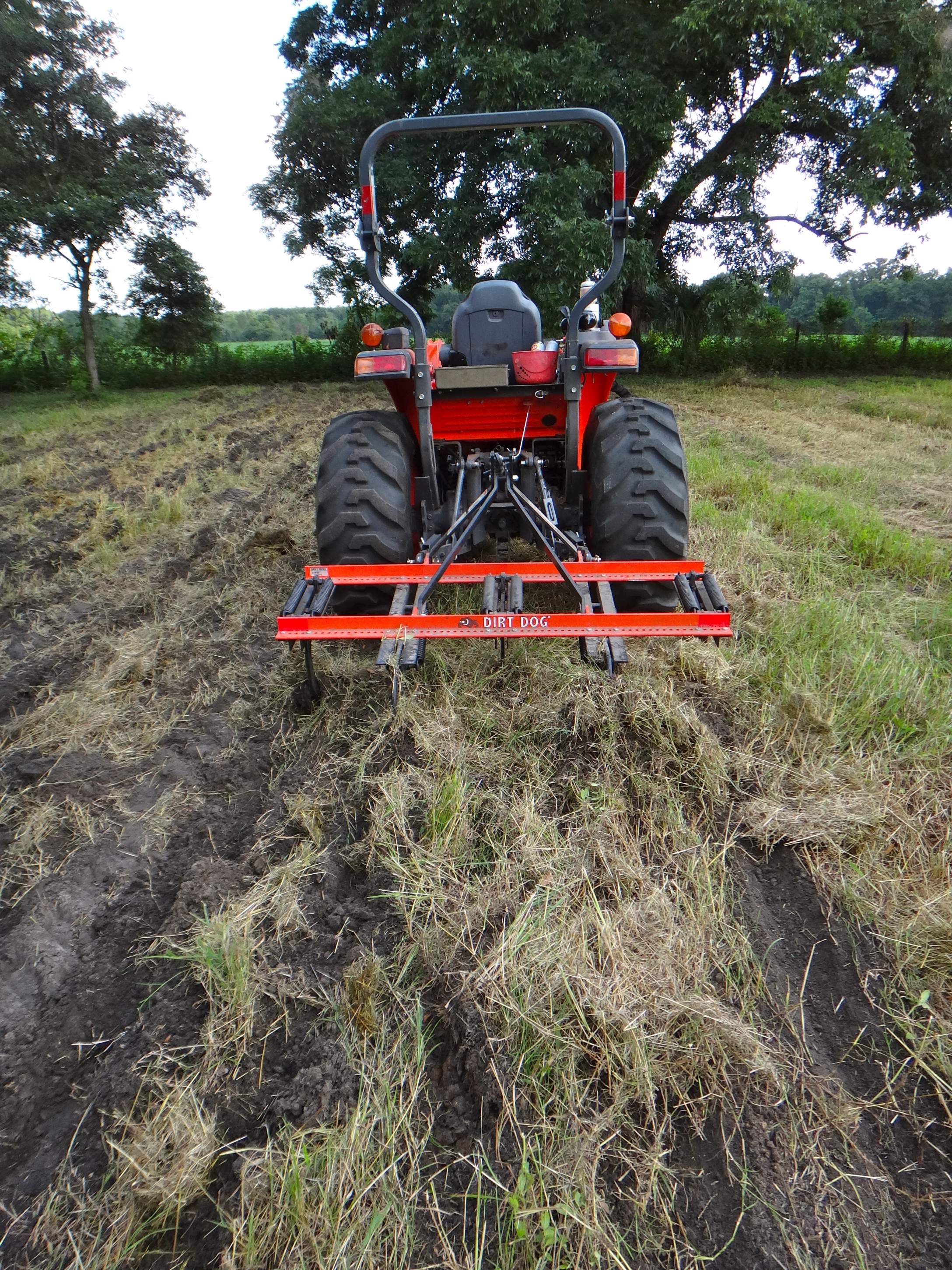

Your light Kioti CK25 can pull a three (3) shank All Purpose Plow 10"-14" deep through any but the rockiest field. APP is a rake with widely spaced tines. It will even the field with several passes and aerate the livestock and vehicle compacted soil. You pasture grass will love the aeration.
Dirt Dog, Fred Cain and Bush Hog all offer APPs identical except for brand decals.
I speculate Dirt Dog produces all of them.
You cannot pull a Disk Harrow with enough weight to level your field behind a light Kioti CK25. Your tractor will stall.

If the rear tires on your ((NEW)) Kioti CK35 are filled with liquid
it should have enough weight to pull a five (5) shank All Purpose Plow 10"-14" deep through any but the rockiest field. APP is a rake with widely spaced tines. APP will even the field with several passes and aerate the livestock and vehicle compacted soil. You pasture grass will love the aeration.
If your rear tires are inflated with air you MAY have to drop off one easily removed tine, leaving four.
