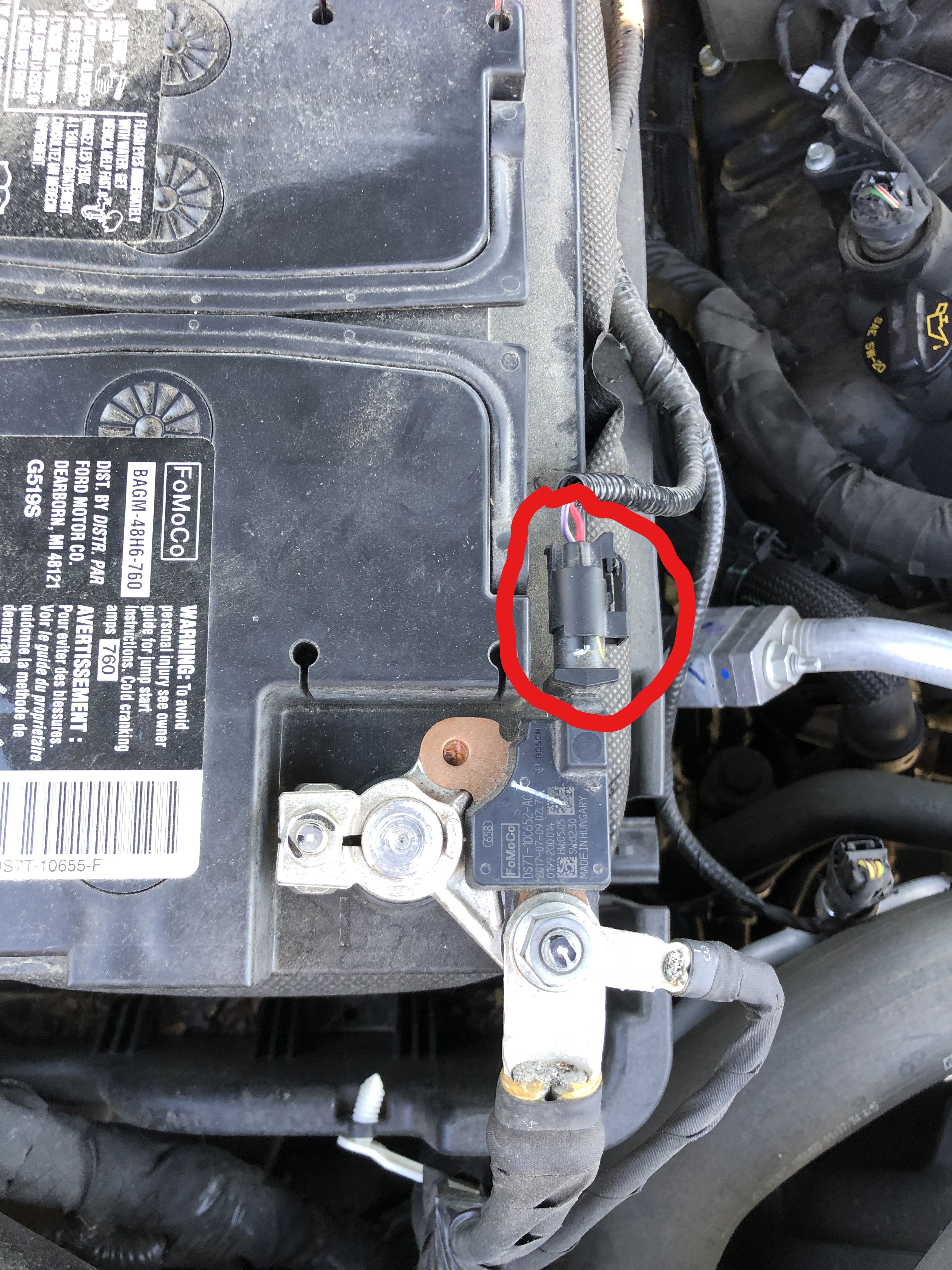

I have tried to adapt to the auto start/stop in this truck but find myself turning it off most of the time. I finally decided to find a way to permanently turn it off. I saw where people were taking their dash apart and putting a jumper wire on the switch. I didn't much like that idea. Next, I saw where some people where buying a bluetooth OBDII adapter and using Forescan software to disable it. I was considering doing that when I ran across "the fix" in a forum.
Disconnect the current sensing cable from the battery. This prevents the auto stop from working since it thinks the battery is charging.
This has worked great for me. Everything else in the truck works normal. No lights, bells or indications that anything is different. I even was able to do the same thing to my wife's VW Atlas. I am happy now!
Hey that looks slick. Have a friend that hares the auto shut off feature. Simple!
   / Life Long GM Guy....New Ford #46
Boy am I glad to read this post. That is the only feature that I absolutely hate about my F-150. Thank you so much for posting this.

Someone explain this feature to me please? Thanks.
   / Life Long GM Guy....New Ford #48
It shuts the engine off when you are stopped with your foot on the brake (such as at a traffic light), thus burning less fuel.
Aaron Z
   / Life Long GM Guy....New Ford #49
While vehicle is in drive and you come to a stop, with brake applied for "x" seconds, the engine shuts off. The instant you lift your foot to apply accelerator the engine restarts and you move on. Much like a golf cart. I thought I would HATE it but for the most part it works pretty smooth. If you have a short stop, it does not shut off.

The mechanic in me calls BS in regards to savings. Every engine starts rich. If the shutdown is 30 seconds or less you'll actually burn more fuel. Then factor in the wear and tear of startup and the "carbon footprint" will increase.
