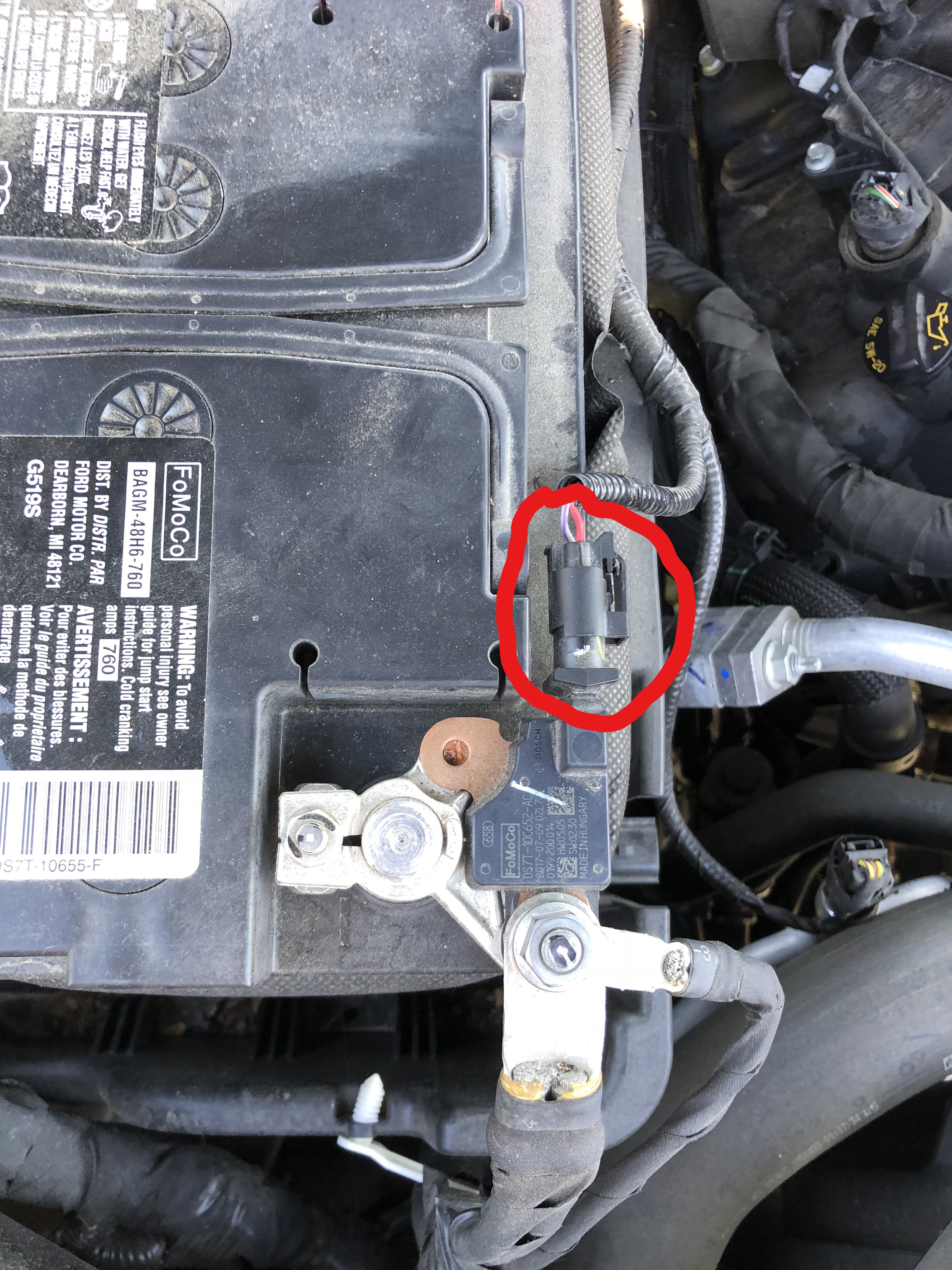

I have tried to adapt to the auto start/stop in this truck but find myself turning it off most of the time. I finally decided to find a way to permanently turn it off. I saw where people were taking their dash apart and putting a jumper wire on the switch. I didn't much like that idea. Next, I saw where some people where buying a bluetooth OBDII adapter and using Forescan software to disable it. I was considering doing that when I ran across "the fix" in a forum.
Disconnect the current sensing cable from the battery. This prevents the auto stop from working since it thinks the battery is charging.
This has worked great for me. Everything else in the truck works normal. No lights, bells or indications that anything is different. I even was able to do the same thing to my wife's VW Atlas. I am happy now!
Except you've now taken away your ability to quickly choose when to use it, while driving. Not sure what's so hard about pushing a button. :confused:
Didn't know that was offered.
First time I saw such a thing was 1985 in Seoul Korea. All the cab drivers did that at the stoplights. But they did it manually. :)
The mechanic in me calls BS in regards to savings. Every engine starts rich. If the shutdown is 30 seconds or less you'll actually burn more fuel. Then factor in the wear and tear of startup and the "carbon footprint" will increase.
But it sounds good in the commercials and brochures.

I have evaluated the feature for almost a year and decided that I do not like it and wanted it permanently disabled without the nuisance button. Its just a personal choice. If I ever want to use the feature again, all I have to do is plug the connector back in.

I don't care for the feature either. The bonus is they come with a super heavy duty starter. By disabling the auto start stop the starter should last a very very long time.
