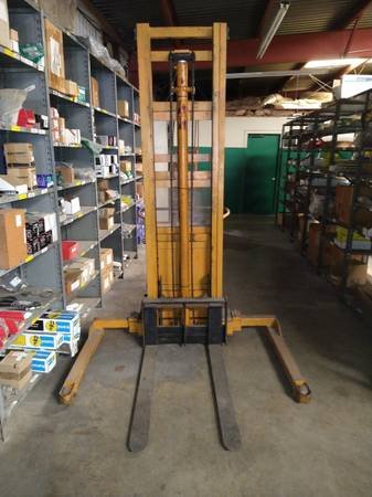

Save yourself some trouble and buy this walk behind forklift: Rol-Lift Manual Stacker 2lbs 2 to choose from - tools - by owner...
That has almost everything you need together, you will need to add a platform, an automatic battery tender (or just use the charger) and either replace the hand valve with a electric one, or run a pair of ropes to move the handle up or down.
I would build a "back" on your platform if you are going to ride on it to keep you from accidentally sticking important body parts into the forklift mast.
For the stairs in your house, find a used stairchair, should be available for under $500 for a basic one for straight stairs if you can wait.
