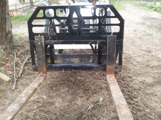

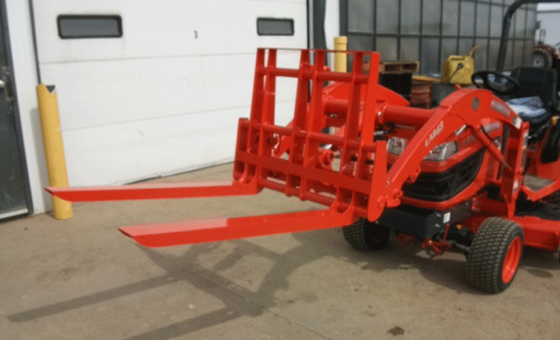

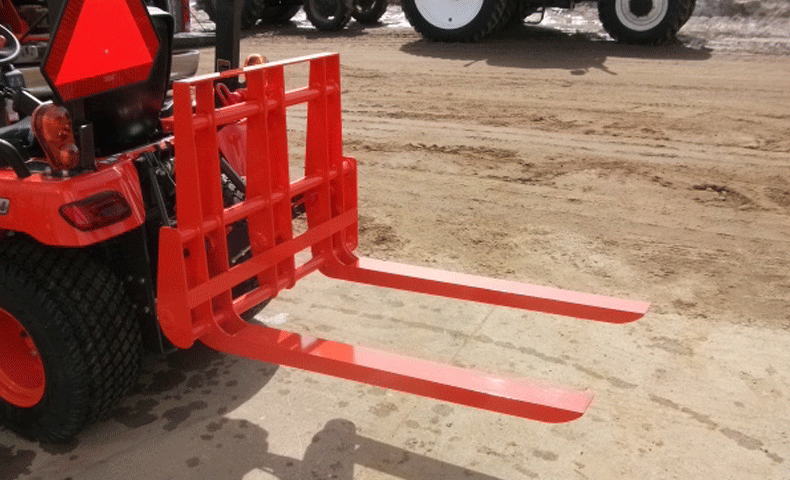

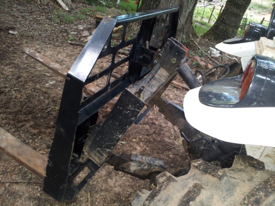

/ Lifting pallets #10
Will this style that fit front and rear, fit your BX? DUAL PURPOSE FORKS
Or make your own: http://www.tractorbynet.com/forums/customization/286916-combination-ssqa-pallet-fork-qh.html

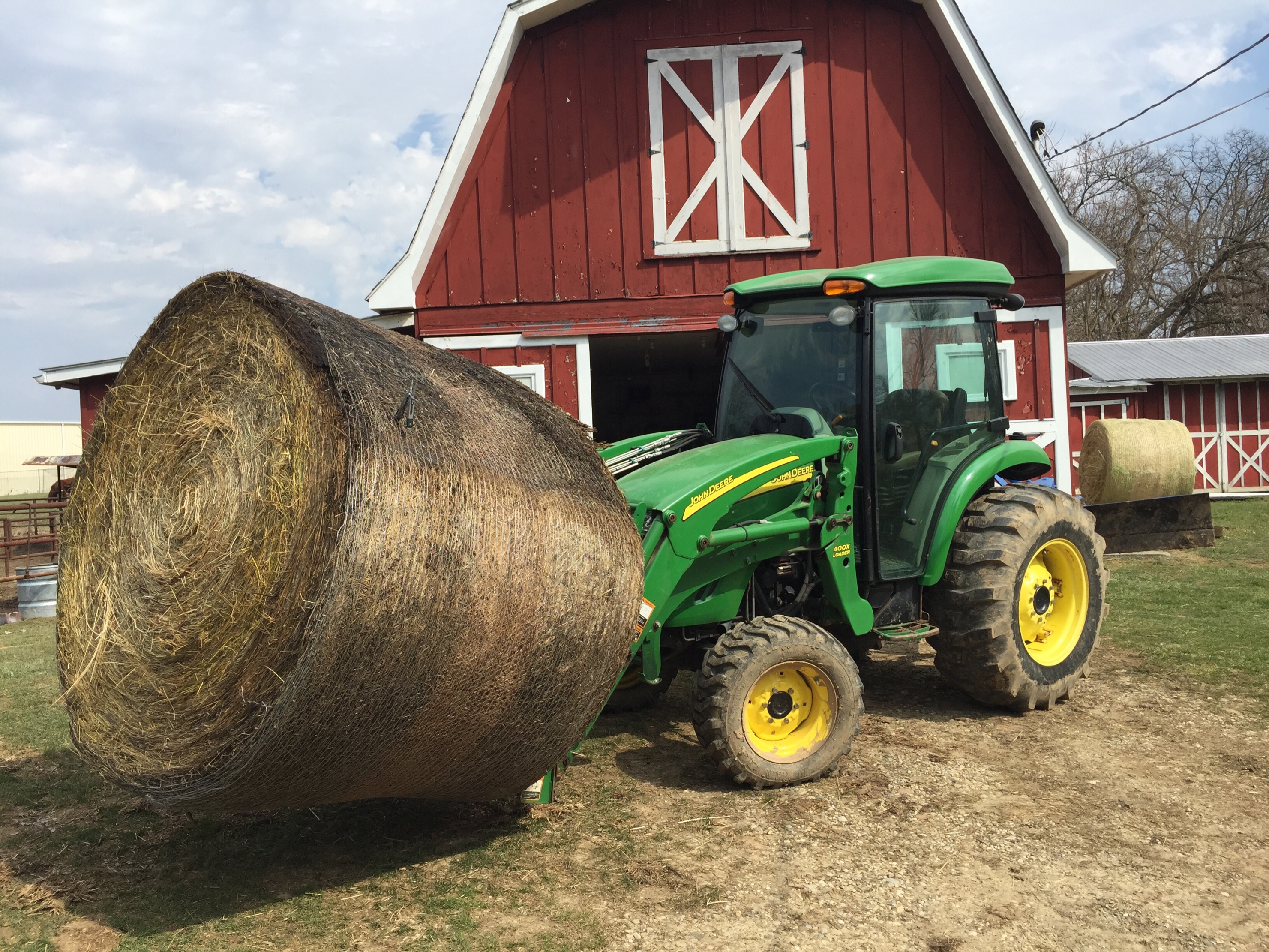

3pt forks are good for moving pallets ext a few feet off the ground to another location and setting it down. Normally the 3pt has a much heavier lift capacity than the FEL. That being said weight close to the pin in critical, the round bale I picked up yesterday with my FEL was a bit over 1000lbs, no more than 1200lbs I would say but the loader wouldn't fully curl it at ground level, I had to pick the bale up 3-4ft before it would fully curl it even know the loader is rated at almost 2k lbs.
IMG_7251.JPG.
Also you may lose lift capacity if your bucket and add on forks weigh for example 300lbs, the forks may be 200lbs so not only is the load closer to the pins, the loader has 100lbs less weight to lift. Something else to keep in mind, more you add like SSQA and stuff more weight the loader has to lift.
