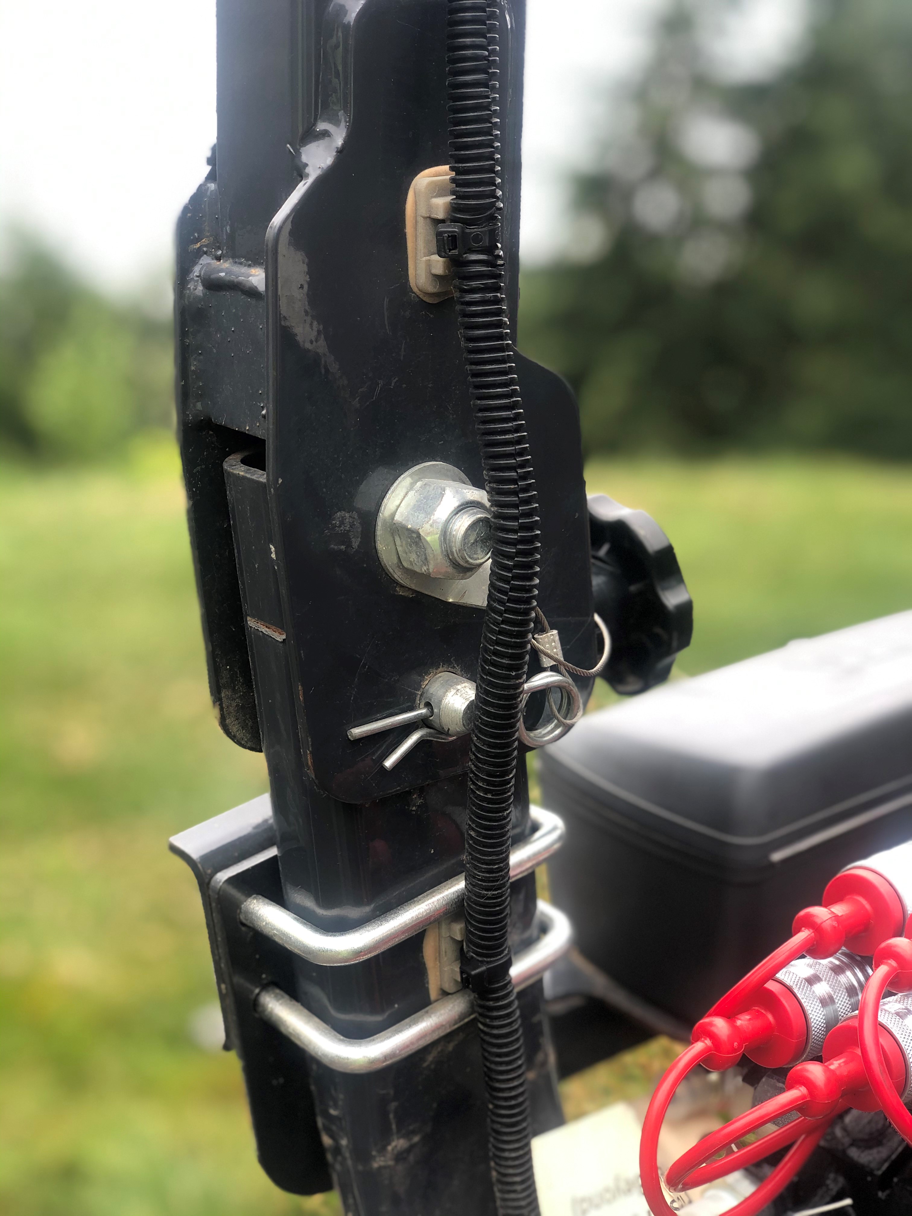

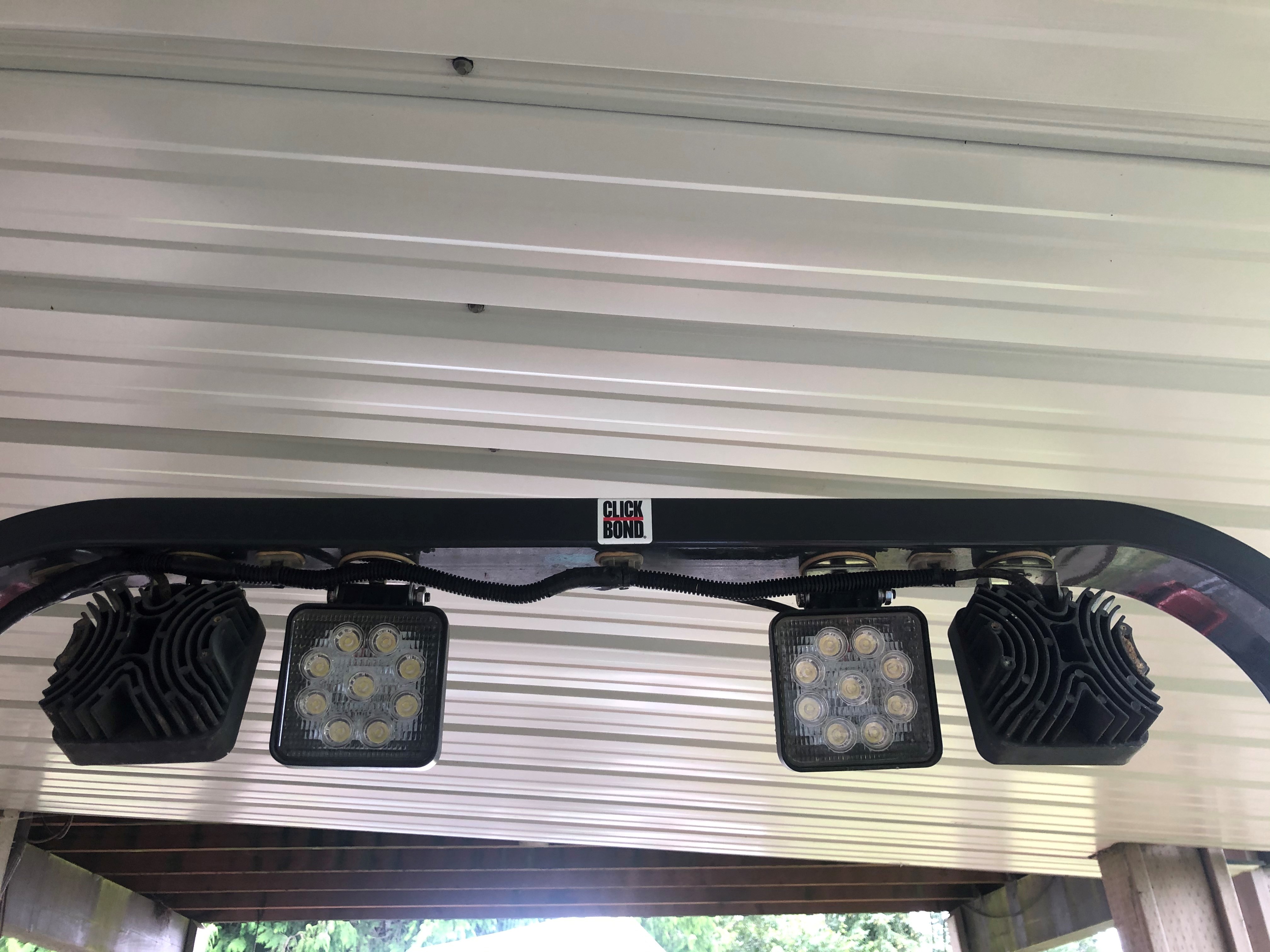

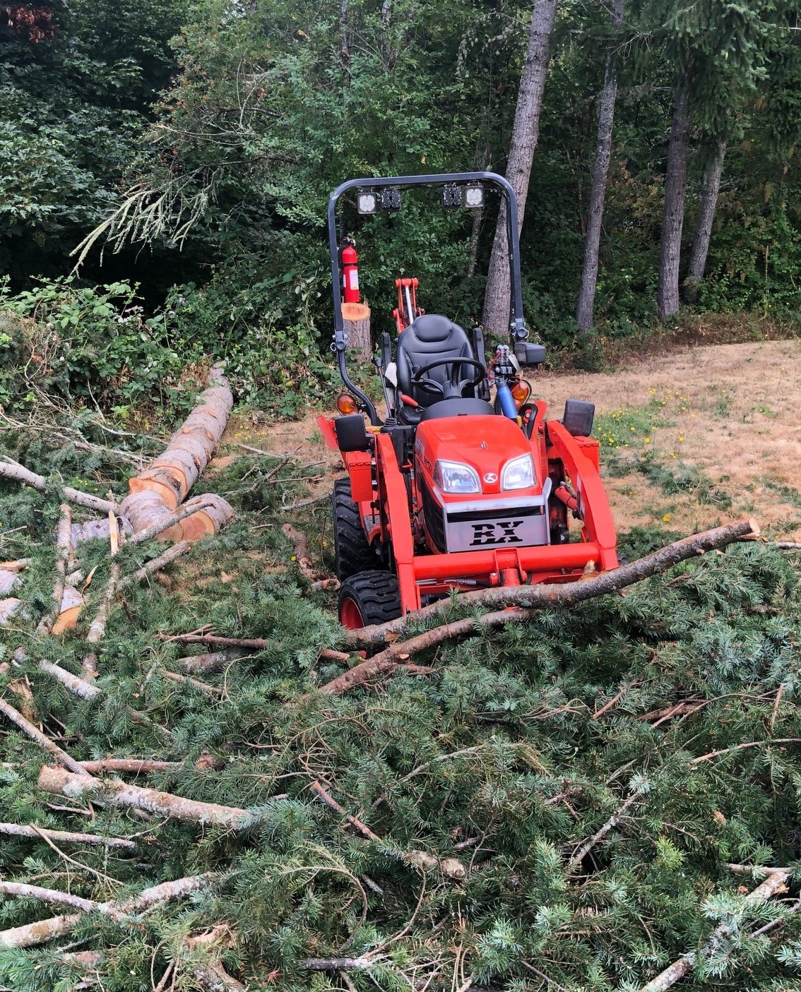

I like mine under the ROPS because I have alot of branches to contend with. I'm tall and the lights cast just fine. Folding ROPS hasn't been an issue. I used protective split spiral wrap to help with wire routing.
