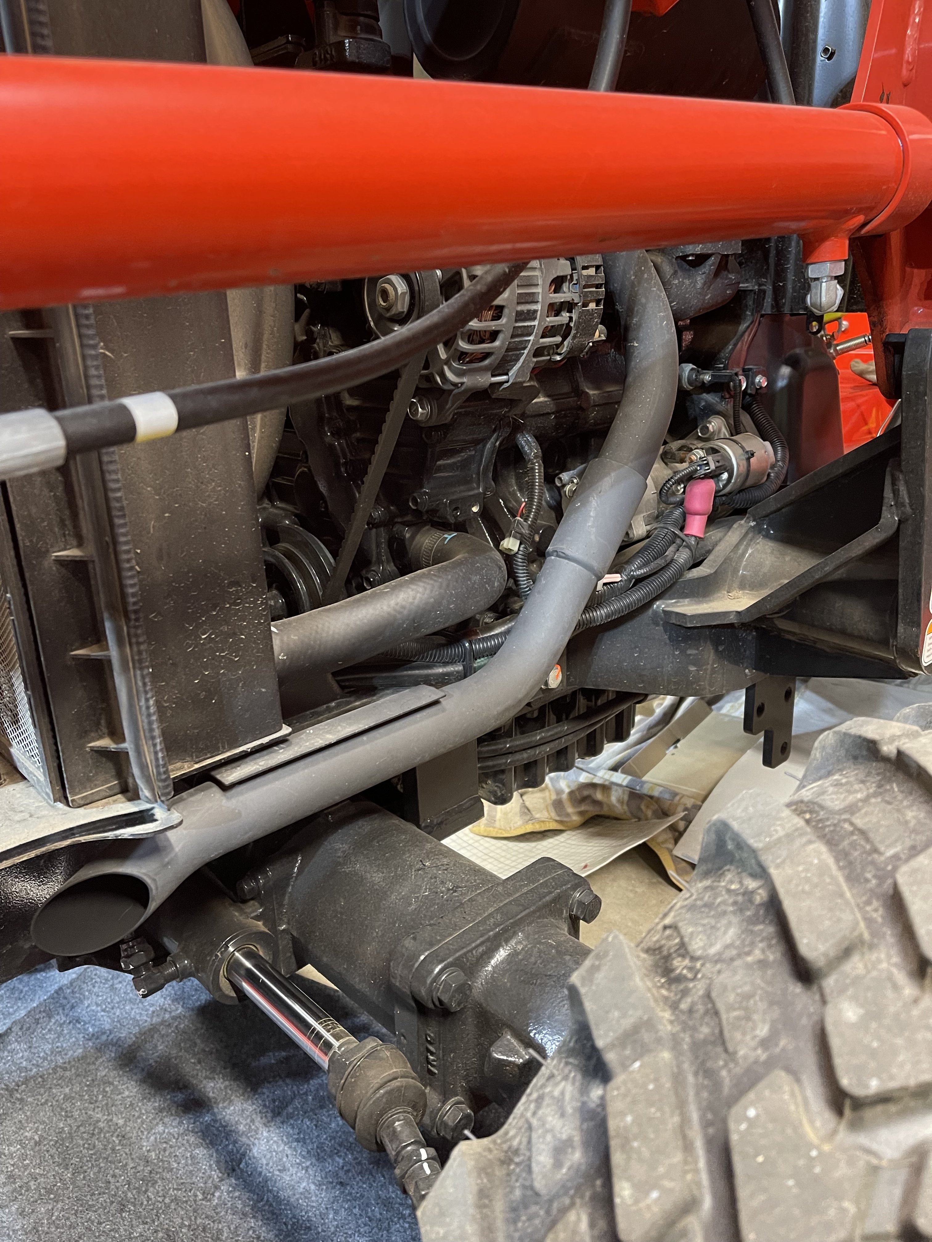

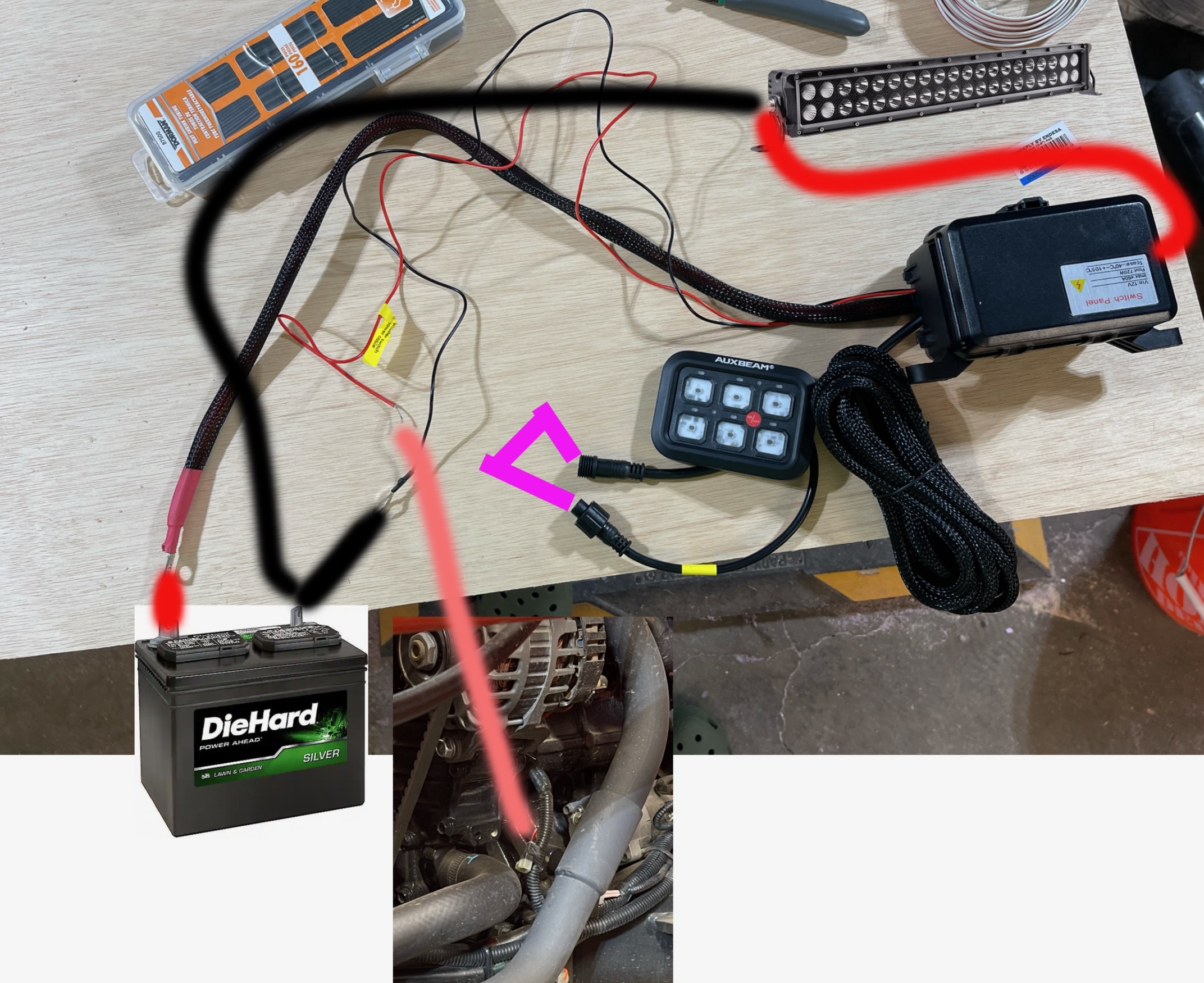

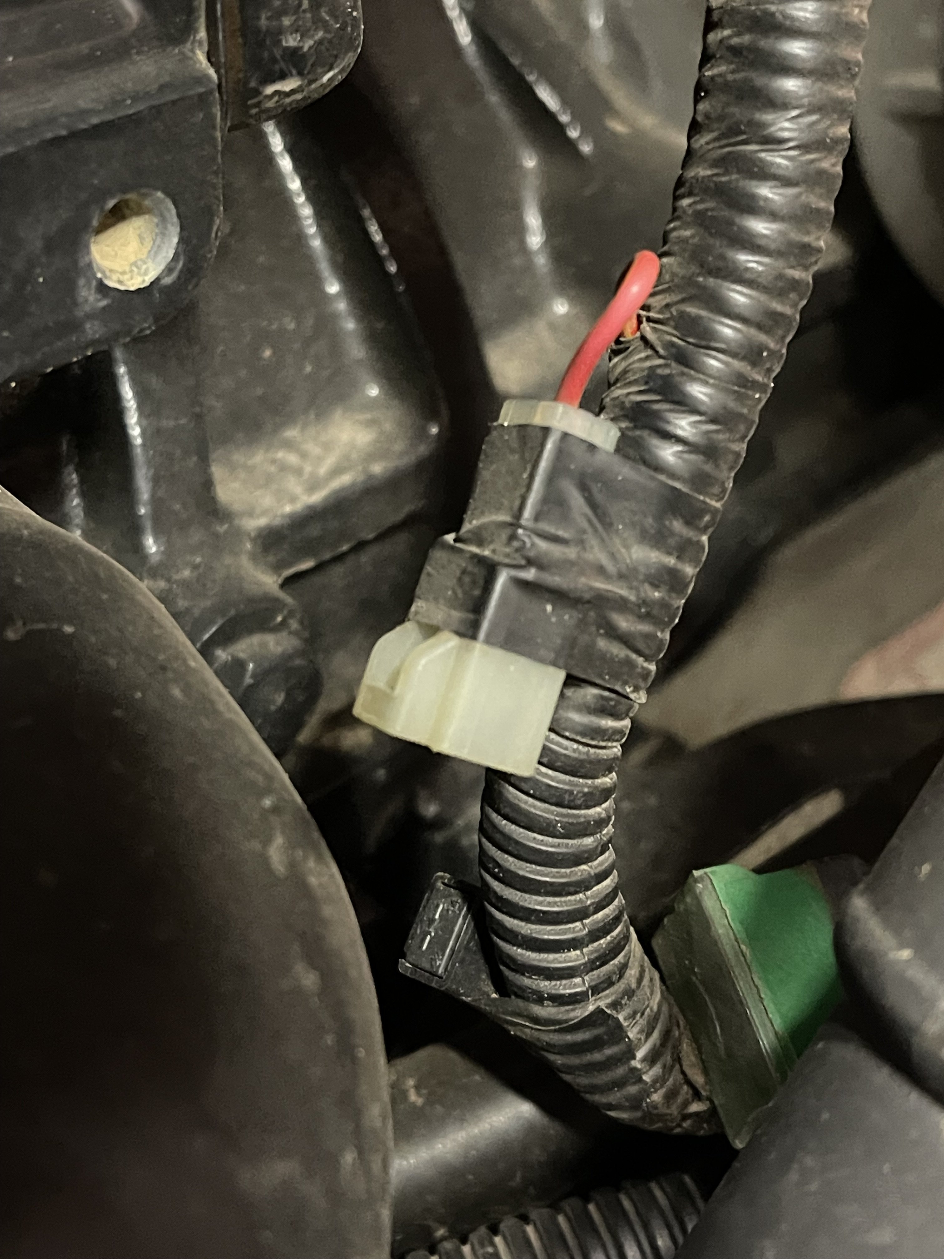

I was recycling some old parts pods I never got around to installing on my SxS and light bars that I have since upgraded.
I was digging around for a hot wire to tap into for the accessory for my fuse panel. And I found this wire on the front left side (if you’re sitting in the seat). Anyone have any idea what this is for? It’s only hot when the key is in accessory but didn’t want to cause any issues or blow the fuse with overloading it. I may add a 3rd function down the line and wasn’t sure if this is a power supply for that but looked like the videos online pull somewhere on the other side closer to the loader control.
ROUGH Lighting diagram at attached for reference.

What model is your tractor? The CS2220/2520's have a pair of bullet connectors taped up under the fenders on each side for the factory light kits.

CK2610. I have the factory bullet connectors but I need a hot wire to plug the switch panel accessory wire into that’s keyed. Maybe I need to ditch the 6 panel switch but thought it would be nice.

On the CS the factory front work light switch plugs into a pigtail underneath the floorboard and controls the left side fender bullet plugs. I couldn't find anything on the CK though.

I think the wire I found on the front left (if you’re in the seat) might be for a 3rd function power? Not quite sure.
Maybe I’ll just go to basic rocket switches and ditch the 6 panel switch.
