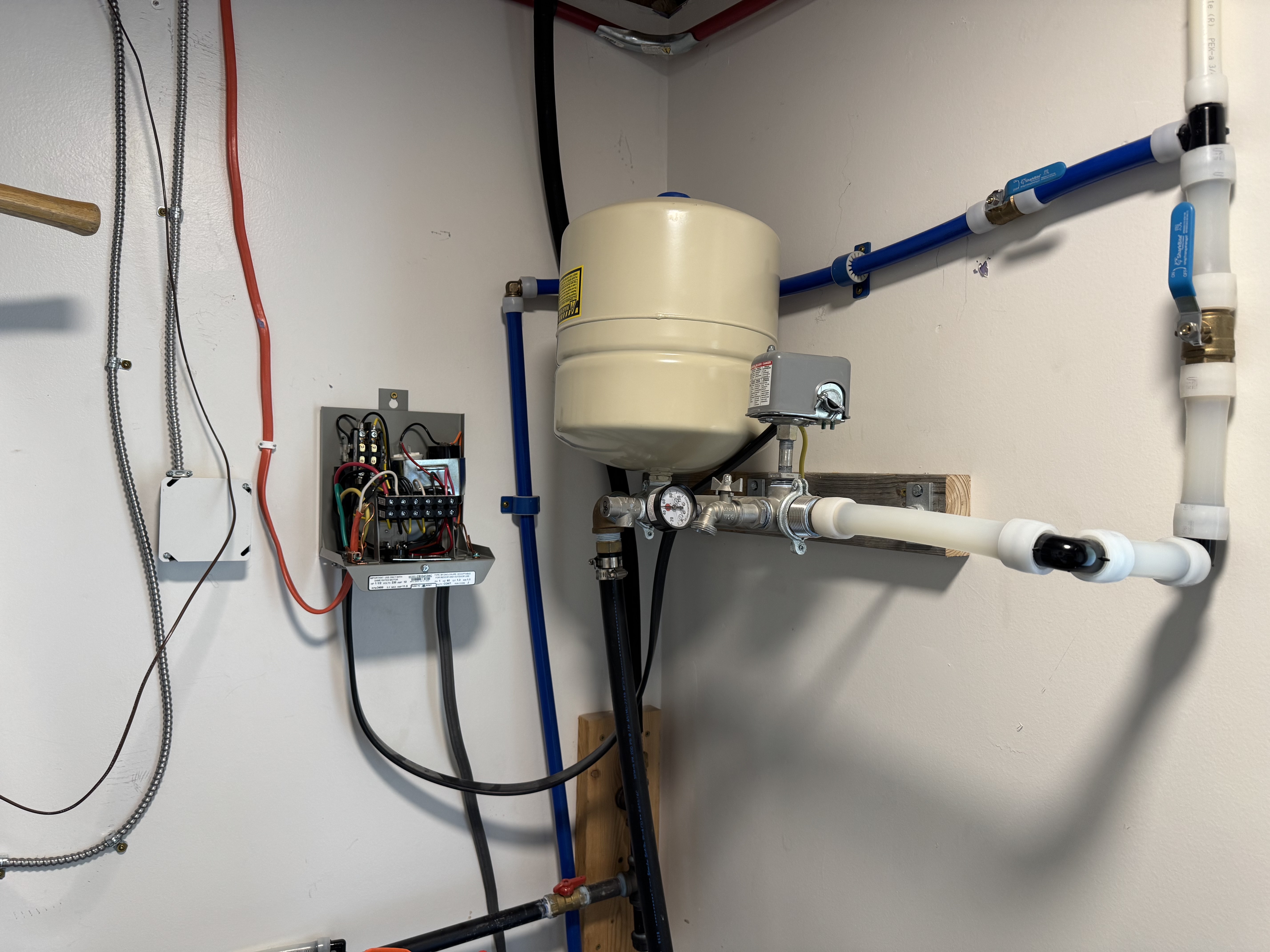

A few start cap's laying around is always a good idea. We lose them more often on our HVAC systens (we have several) than anything else, but also the air compressor and well pump. Nailing the "uF" or "MFD" value isn't critical for an emergency stop-gap when something dies on a Sunday, as long as the voltage rating is sufficiently high, but you'll want to replace it with the proper value for permanent replacement.
Between all of our HVAC outdoor and indoor units, air compressor, and a few big machines in the shop with cap start motors, I'd bet I replace at least one start capacitor on something every year.
Note, many HVAC outdoor units can have 3-terminal dual capacitors, but they can be easily replaced by two singles, if you have them.
