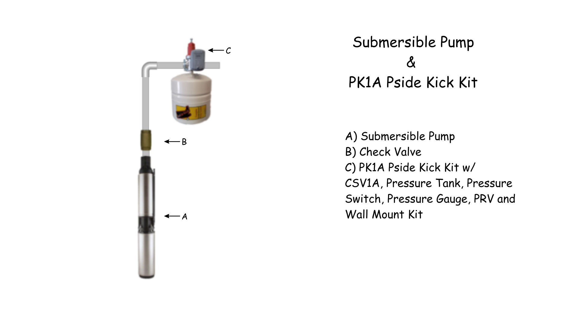

We have an hour of near-constant usage every morning, through which our well pump cycles several times 10 - 12 times. It has never been a problem, our last well pump lasted more than 20 years (maybe even 30 years?), and the present one is still doing fine at 15 years. But now we have teens taking long showers, which only adds to the cycling.
So while no dire emergency, the CSV does appear to be an easy install from which we could probably benefit. But what's not clear from the explanation on the web site or the PBS video, is how you control pressure in the ABS line dropped into the well casing. I'd guess there's probably a bypass in the pump itself, but given my line is probably 50 years old and has never seen over 60 PSI topside (=125 PSI at 150 ft depth), I'm not sure I want to subject it to whatever the bypass pressure is set at, or the possibility of a single point configuration. In a normal system, the primary pressure switch located at the bladder ensures the line never exceeds that pressure plus vertical rise.

I don't think they are field adjustable. If I was going to use them, I think it would be in the well, not in the house. I worry about the excessive back pressure they put on the trench line.
The back pressure from a CSV is completely dependent on how much pressure the pump can build, less the depth to the static water level. Many years ago I would occasionally see 100# poly pipe in the trench line. Some really old houses may still have that. But 160# or higher is the pressure rating for most underground pipe. Even then, the burst pressure of pipe is 2-5 times the rated pressure. There is also a limit to how much back pressure the CSV can handle. With the in well CSV125 the limit is 150 PSI. With the CSV1A the limit is 400 PSI. But if the pump builds more back pressure than about 150 PSI, the pump itself is WAY oversized. Sometimes a pump made for 600' deep will be incorrectly installed in a well with a water level of say 50'. That is why we like to know the pump size so we can check the back pressure.
Back pressure up to about 150 PSI is rarely a bad thing for the trench line. As a matter of fact a 150 PSI back pressure from a CSV can be easier on the trench line than a system without a CSV cycling between just 40 and 60 PSI. The water hammer that happens when a pump is started or stopped can put many times more pressure on the entire system, especially the trench line, than the pump is even capable of building. Any extra check valves other than the one on the pump can further accentuate the pressure spikes from water hammer. A pump with a max pressure of120-150 PSI, which is common, can cause water hammer spikes in pressure over 300 PSI when the system is cycling on and off between 40 and 60 PSI.
A system controlled by a CSV has no water hammer. The CSV can provide a mechanical soft start and soft stop, making the pump start and stop at 1 GPM, not full pump flow rate. A 150 PSI back pressure from a CSV can be more gentle on the trench line than a system without a CSV working between 40 and 60 PSI.
Just like a pump, sizing and installing a CSV correctly is important. Back pressure is about the only concern. Making sure the back pressure from the pump cannot exceed the pressure rating of the pipe in the trench line, means the CSV can be safely installed in the house instead of the well. In the 30 something years I have been installing Cycle Stop Valves I have seen fewer water line breaks than I can count with one hand. All of those line breaks were because of faulty piping that already needed repair, the CSV just pointed out where the weak point was.
The concern about back pressure from a CSV is over sensitized by the pump manufacturers. After Blacklisting the CSV as a disruptive product in 1994 because it "makes pumps last longer and uses smaller pressure tanks", pump manufacturers propagandize that back pressure is a bad thing. That is really all they got. There are absolutely no flies in the ointment of a Cycle Stop Valve, including back pressure on the trench line, so they try to manufacture one. At any open house or trade show you will hear over and over, "CSV bad, VFD good". I do not blame pump manufacturers for disparaging the CSV at every opportunity. If there was a CSV controlling every pump, it could cut replacement pump sales by 90% and they know it.

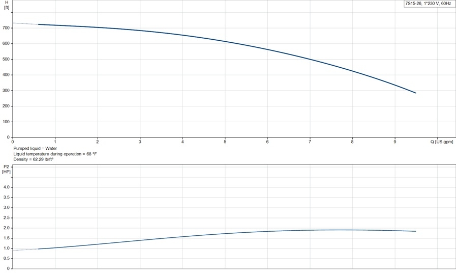

Yeah, you don't get much amp drop from most 5-7 GPM pumps. But it also depends on the brand of pump. This one drops from 1.9HP to 1HP at 1 GPM flow. Even with a 7 GPM pump the amps will drop nearly 50%. Shut off head on this pump is about 720' or 311 PSI. Deduct the 50' or 22 PSI for the 50' lift from the static level and the back pressure from a CSV would be 289 PSI. Yes, 289 PSI is more than the trench line can handle and more than one CSV1A valve can handle. But it isn't enough back pressure to overload the thrust bearing. Adding two CSV1A valves at the well head could stair step the pressure down from 289 PSI to the 50 PSI needed when using a 40/60 switch. The first CSV1A sees the 289 PSI coming in and is set to deliver 150 PSI out. The second CSV1A sees the 150 PSI coming in and reduces it to the 50 PSI needed and neither CSV sees more pressure differential than it can handle.
While constant pressure, soft stop, and running cooler at reduced amps from a CSV are good things. It is not hard to add a large enough pressure tank to a 5 or 7 GPM pump to reduce the cycling and not use a CSV. If the well is for house use only a CSV may not be that useful other than to deliver constant pressure. But if the well is used for irrigation, heat pump, or any long term uses of water the CSV, or two if needed, can be just as important for a 7 GPM pump as a 70 or 700 GPM pump.

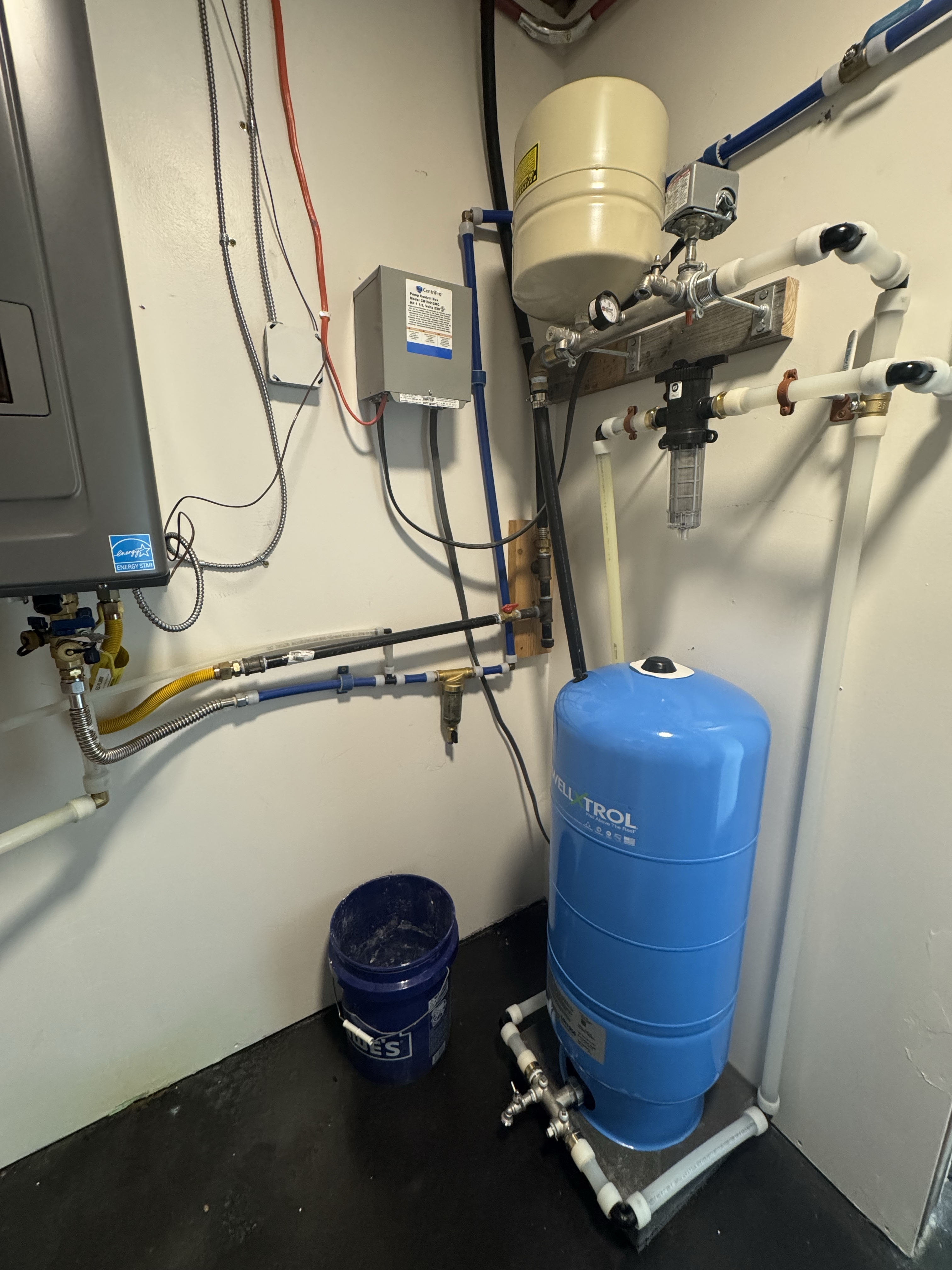

I finally got everything together and today, I installed the pressure tank.
I used a twist2clean debris filter and put in another ball valve to isolate the new tank, if I need to work on it. No leaks and flushing the toilet went from 4-5 pump cycles to 1. Part of that issue was debris getting into the lines and gumming up the toilet mechanics. I suspect frequent cycles caused the pump to twist a bit on the line and bang into the wall of the well, stirring
up sand, etc. I am pleased with the outcome.

So your new blue Welltrol tank is basically in parallel with the old beige tank. You just added more storage capacity and now it is working like you want it to? I'm still thinking about adding a CSV to my system and I'm thinking I'm just going to use the existing tank. As long as I can get the misses to quit bit%^&ing about the variable water pressure when she is showering.
