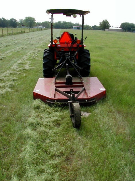

Don't know how yours looked after the guy cut it, but here is an attachment to show how mine looks after cutting with an inexpensive (~$550) rotary cutter. Not quite like a front lawn but not bad. Like Bird, I just lower it about as low as it will go.

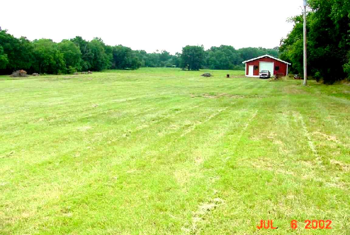

Here's an old picture of my pasture. I had the front of the mower barely off the ground and the rear one notch higher.

You can do a pretty good job with a rotary cutter if it's set up correctly and the blades are kept sharp. Whether using a RC or a RFM, the key is to not let the grass grow too long between cuttings. Don't misread me, a RC will never do as pretty of a job as a RFM... at least not up close. However, if you stand back a bit, it's nearly impossible to tell the difference. /forums/images/graemlins/smile.gif
As others have said, RC's are a lot cheaper, require less maintenance, and are a lot more durable. Unless you figure you would never be happy with the job a good sharp RC will do, I would go that route.
