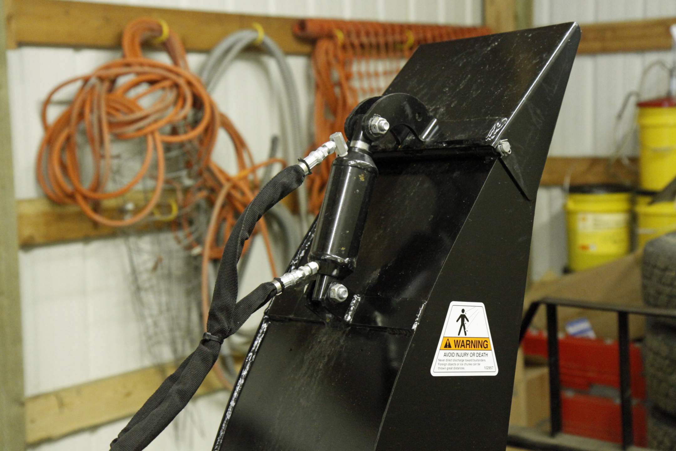

mine uses a small hydraulic cyllinder on the deflector, but i have no idea how much force is beilg applied to it from the snow while its blowing. Considering the tonnage of snow blown out the thing, it could be quite alot. They have a pretty beefy cyllinder on mine.
/ Linear Actuator #8
I incorrectly in my read the orginal posters question. So I looked at the last posters picture of his chute deflectors hydraulic cylinder. So if we were to guess at a 30 LBS thrust at the tip of the chute and the chute is 9 " from the pivot point. The cylinders pivot point might be 3 " from its pivot point . This would create a 3 times mechaincal load on the actuator. So in guessing the actuator might have to push a 30 X 3 = 90 LBS thrust. ( more or less )
