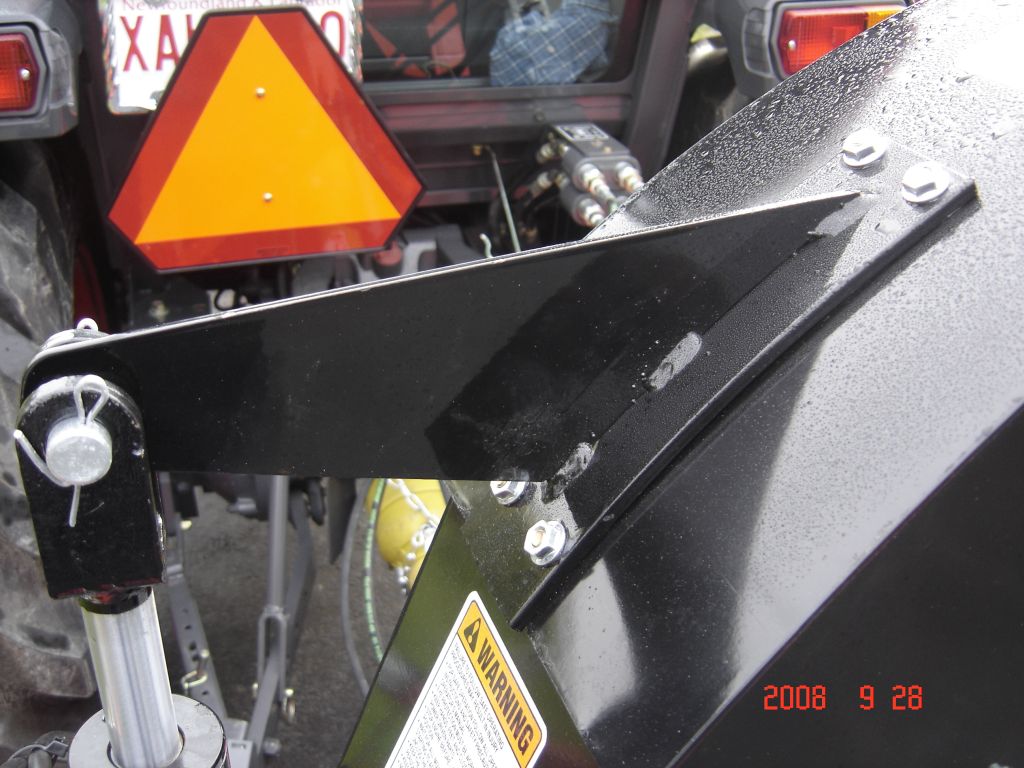

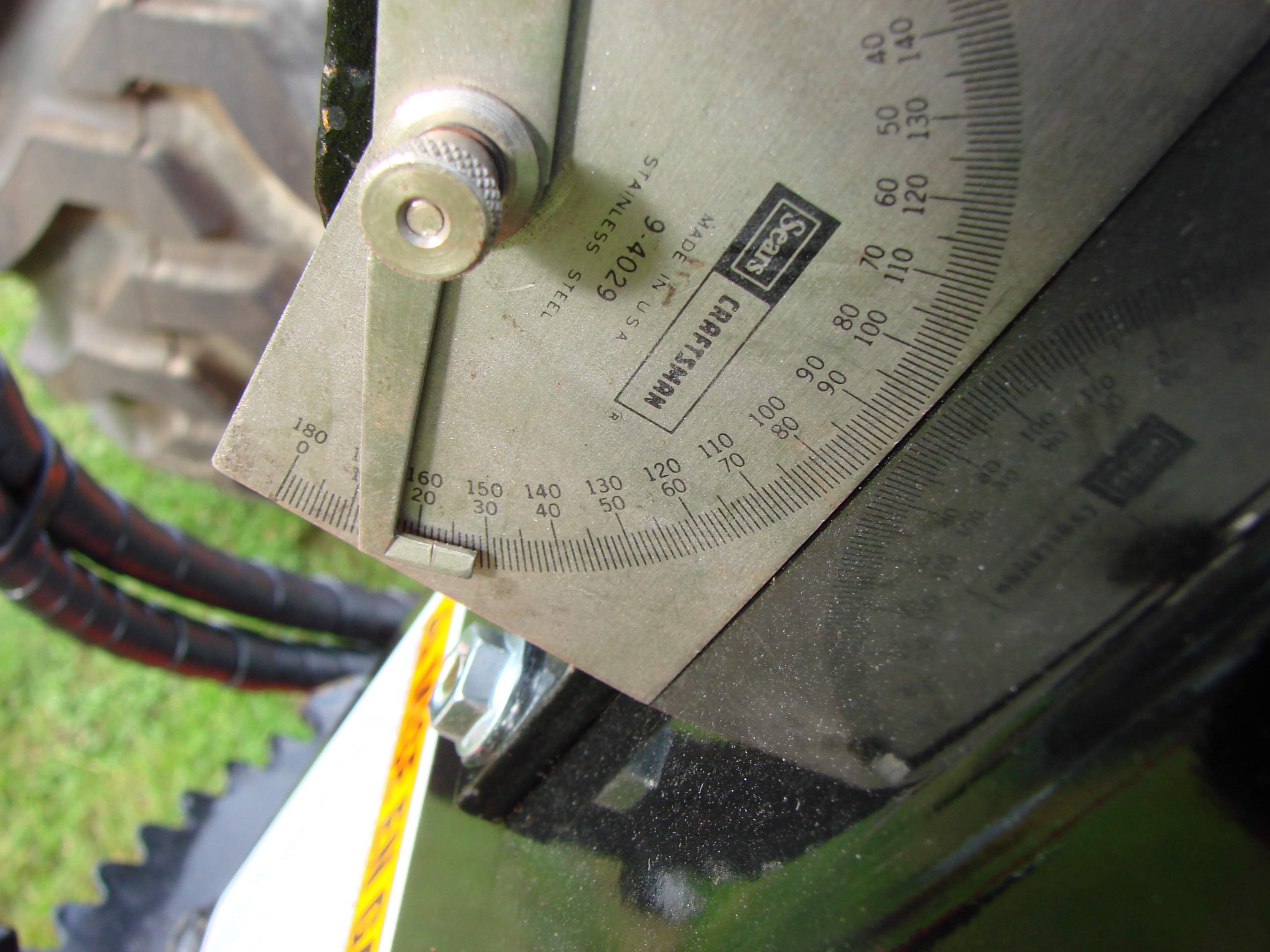

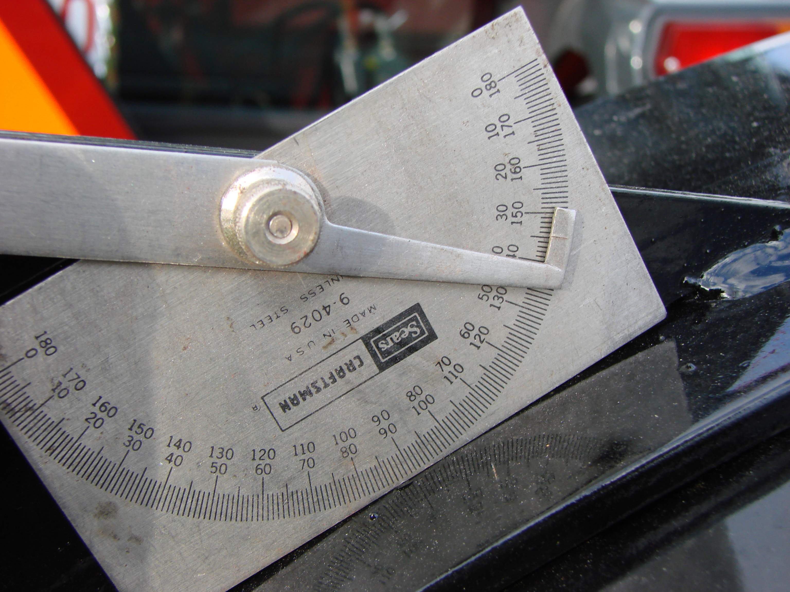

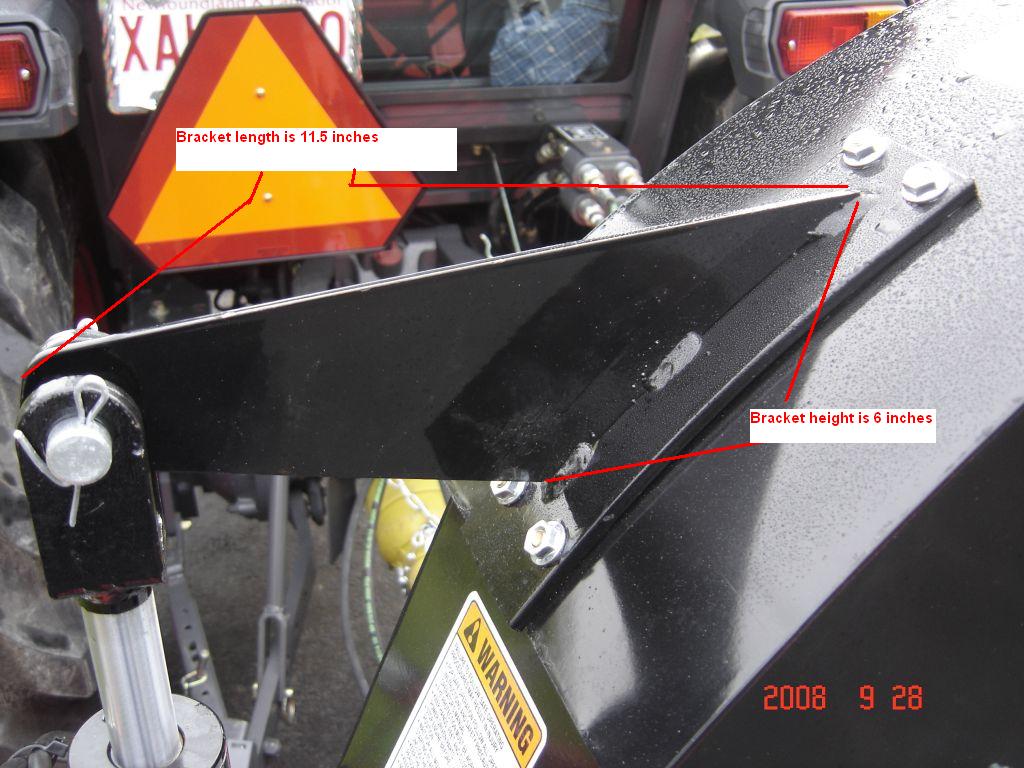

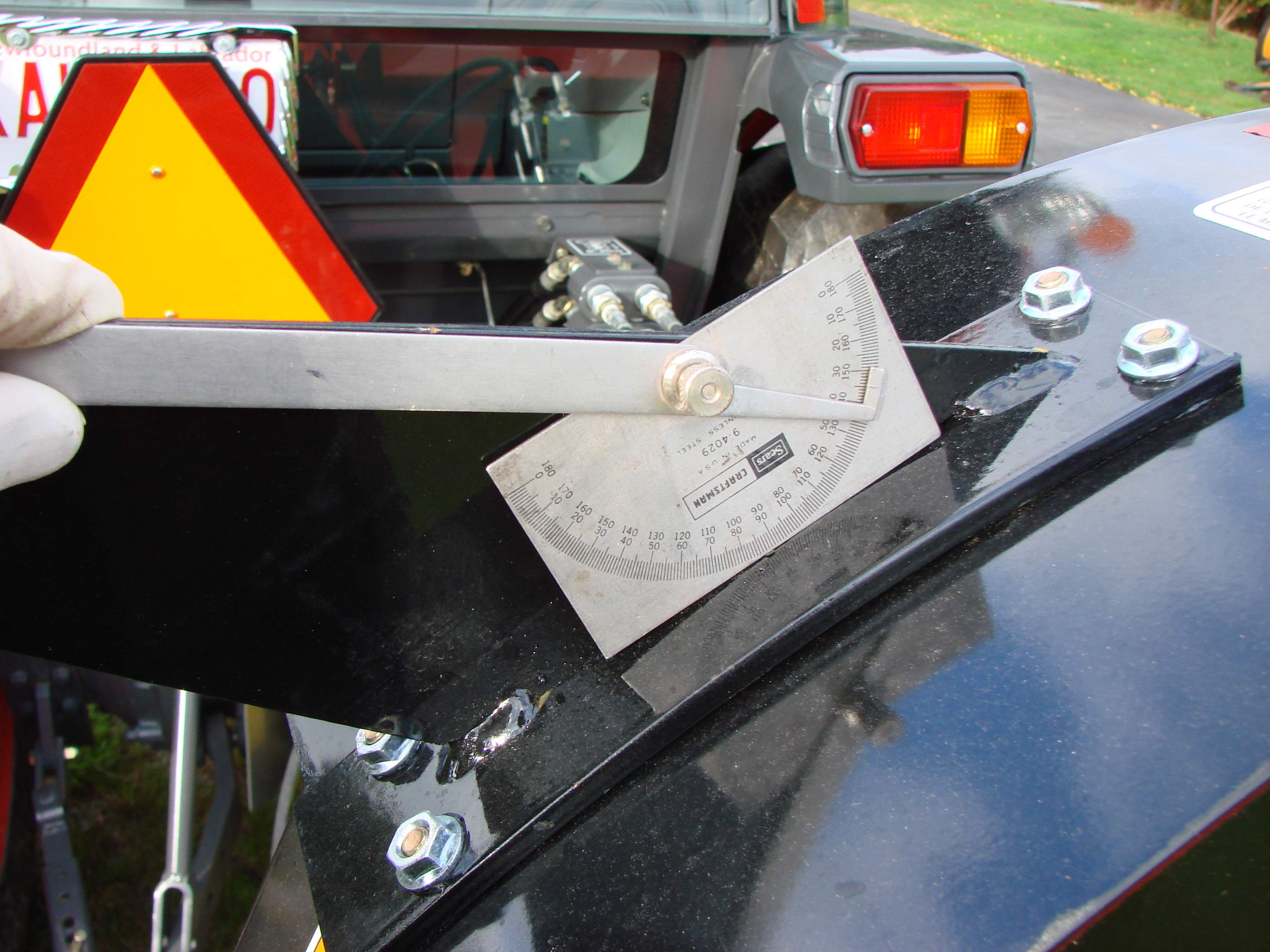

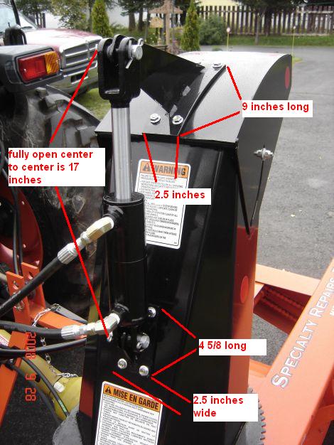

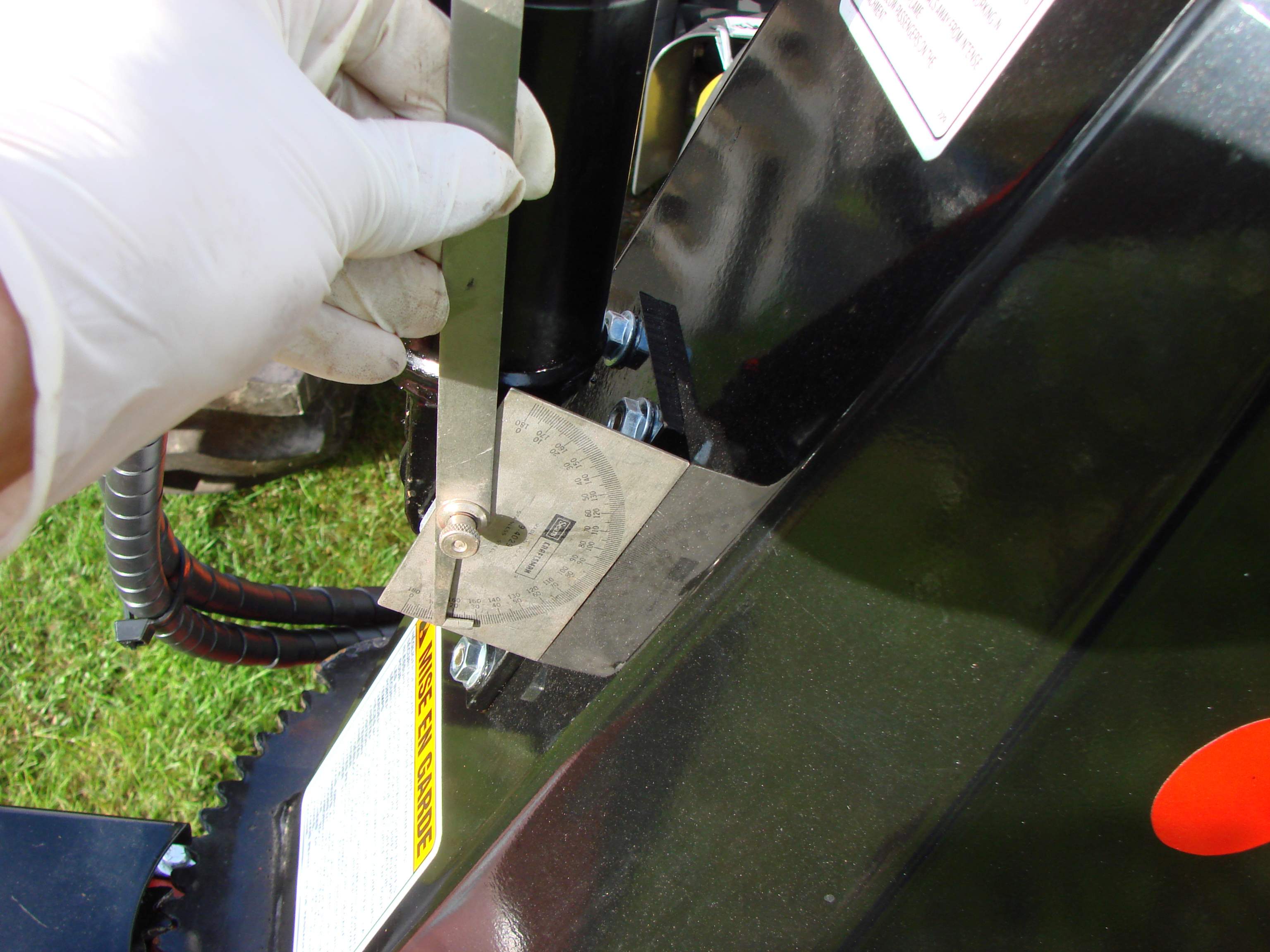

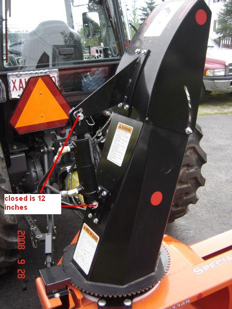

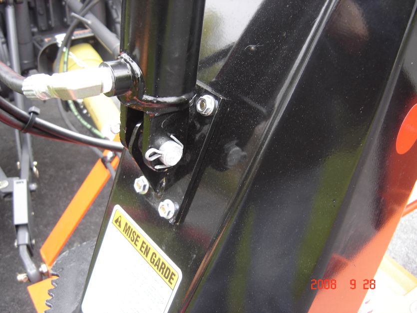

Here are the pictures originally provided to me by Paul? Repair Specialties
I have obviously adapted to fit my application but you will get the main plans

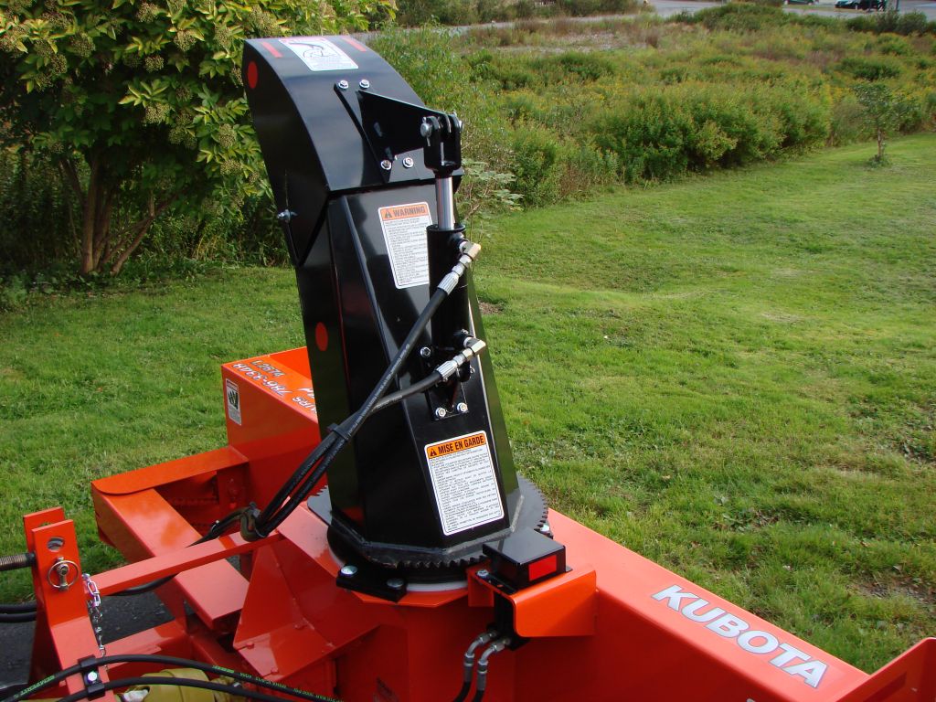

mine uses a small hydraulic cyllinder on the deflector, but i have no idea how much force is beilg applied to it from the snow while its blowing. Considering the tonnage of snow blown out the thing, it could be quite alot. They have a pretty beefy cyllinder on mine.
Your chute is a lot different than mine. Mine is two pieces.

Great pictures and measurements, they helped alot.
Now I have to decide which way to set it up, on the side or on top.
Been doing some measurements and either wat I need a 4"stroke.
Have to decide on the force pounds also. I can get a 35 pound push/pull actuator with a 200 pound static force but it is a high speed unit or I can get a 150 pound push/pull with a 522 pound static sorce, which is a slower speed.
I am leaning towards the normal speed because of the high static force with a heavy wet snow in mind.
