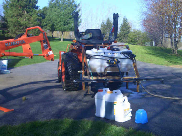

#38
Made a temporary 3-pt platform for the first application, I'll finish up the fancy carryall later. Ended up mixing 32oz each of 2,4-D and liquid fert. (1oz/1000sf), plus 8oz surfactant for each 30gal. tank fill, and put down about 4 tanks total.

#39
After doing a bunch of calibration runs up and down the driveway with different tips, I was thinking the TeeJet TP8003 tips worked best. The neighbor, however, wasn't quite sure why I was watering my blacktop and came over to check it out.

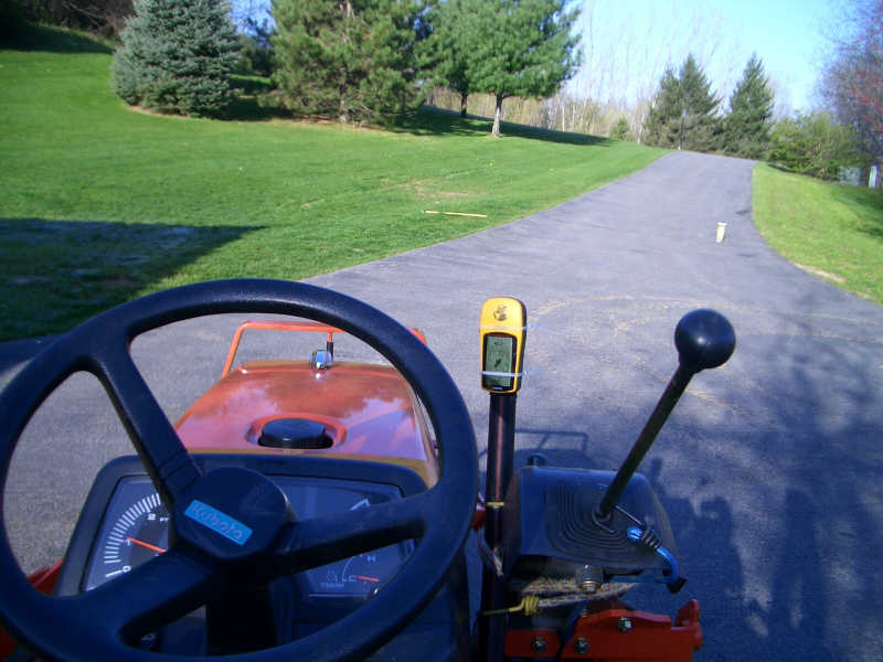

#40
Ended up mounting my little GPS to control calibrated ground speed of 2.75-3 mph. Seems to have made for an effective kill, the little yellow dandies are shriveling up. The first time is the hardest, should go a bit smoother next time. Thanks for the help.
