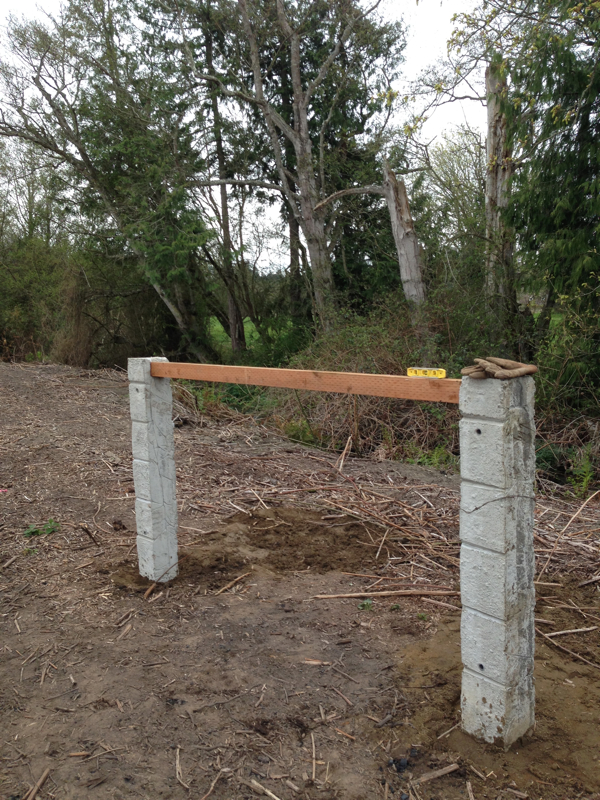

Oh Wow. What about putting the post in concrete. That is what I have had to do here, bucause of all the clay drying out and shrinking. Then the post becomes loose.
hugs, Brandi

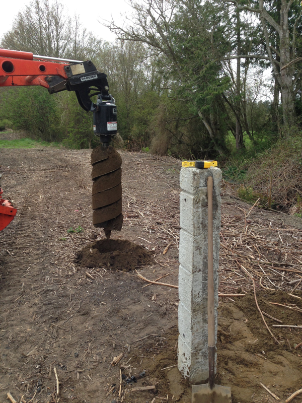

No, the post still rots out and leave a chunk of concrete with a hole in it. I replace 20 to 30 posts a year on the corners and ends and my cost per post including rebar and tubes for the X brace wires to go through is about $25 each. RR Ties run up to $20 for the real good ones, so it works out.

I like the back hoe mount, very nice. Plus you could add a extension to dig deeper holes if need be.
