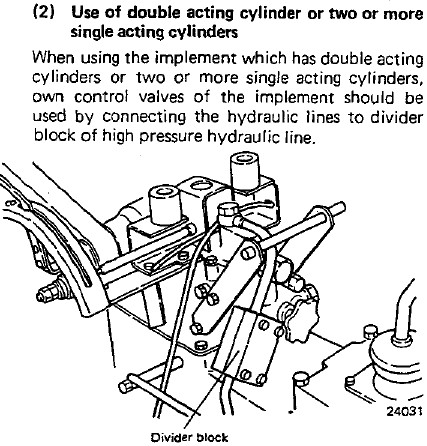

Just for further conversation on some differences in our machines and for posterity. I am posting pics of my 3pt block and like I said these ports may be the correct way to plumb an auxiliary attachment?
It may have the return built in the block to dump into the trans case I have no idea so anybody have an idea please feel free to say it.
Found the answer if anyone else has this same 3pt valve! :thumbsup:
I was looking in my 336 manual for a pressure test port the procedure and specs etc and on page 270-10-11 and 270-15-2 found the auxiliary valve for loader and how it works etc.
The lower port is pres out and the upper port is in return. I clamped a clear plastic hose into the fittings to verify it flowed and which direction and it does.
I did try raising the 3pt (it was down doing the flows test) and noticed the hose swelling so I quit that yikes.
So am hoping the 3pt will not need to be clear down for the aux valve to work for rear remotes. I plan on running my splitter on those ports as long as there is enough pressure to do the job and want to be able to raise it to where it doesn't kill my back time will tell on that.

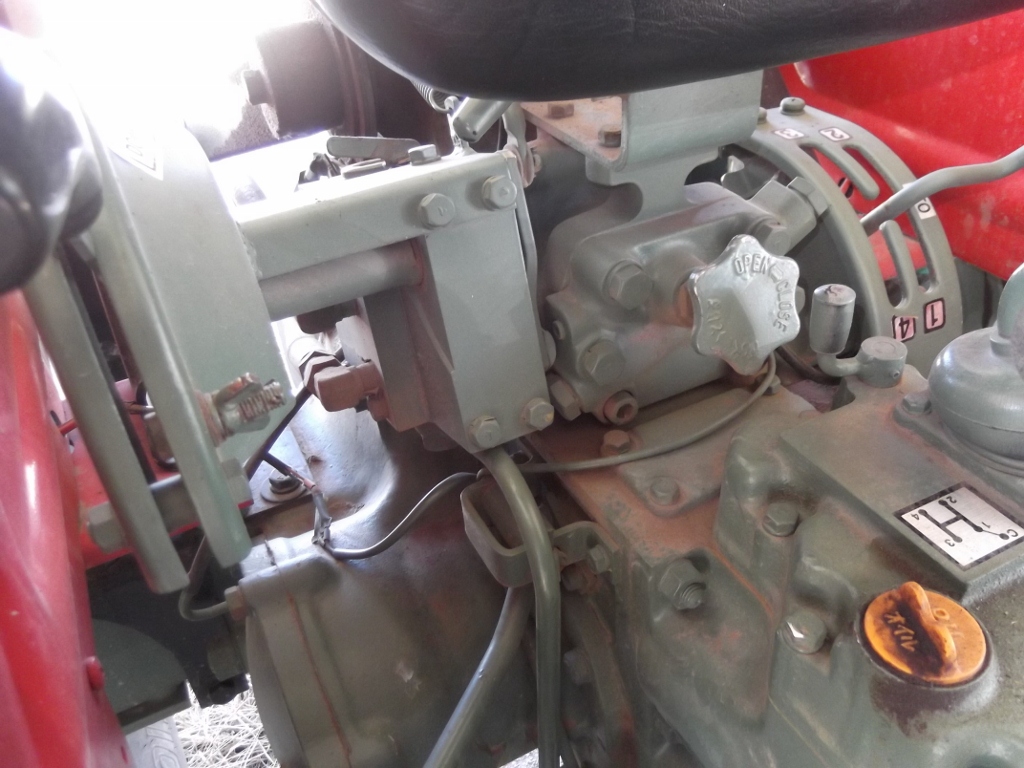

I just got my pb sleeve from Koyker so I will be re-plumbing the loader and my soon to be newly installed rear remotes. :thumbsup:
I am in the process of converting my splitter over to 3pt and am using the tractor hydraulics on it so far and my 3pt block has the in and out ports I posted the pics of earlier.
I plan on only using the pressure out and return both the loader and the remotes to the top plate on the trans case like kenmac did his as long as the 3pt block doesn't have some modification that would not allow me to plug one port off time will tell on that.
I dont want to return the remotes thru the 3 pt block either like the loader is is my reasoning on that. Right now its working returning thru the block but it kicks the 3pt every time I operate the splitter so I dont know whats up with that something isn't jiving.

Now - my loader valve is plumbed from the pump directly and back to the return - see the pictures:
Now my 3pt looks like this and has a hose that loops back on itself:
I mentioned in an earlier post that I am not getting any strength when trying to curl the loader when the 3 pt is in the up position. I have not tried to adjust that yet but is my loader etc plumbed correctly?
And....so if I wanted to add rear remotes, what would be the best way?
