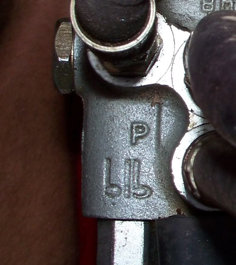

I will have to look to see if there are any manufacturer markings. I don't have any instructions
   / Loader plumbing #52
You will have to contact manufacture for the for the part to convert it to PB if , that's where the sleeve goes & probably any instructions / spec sheet for the valve would be great
   / Loader plumbing #53
anyone recognize what manufacturer this is?
   / Loader plumbing #54
Not sure, Looks like perhaps a marking meaning open /close circuit, Have you tried looking under the lever boot for a manufactures name? I don't suppose there is a metal tag riveted to it somewhere?/ Like mine has:D

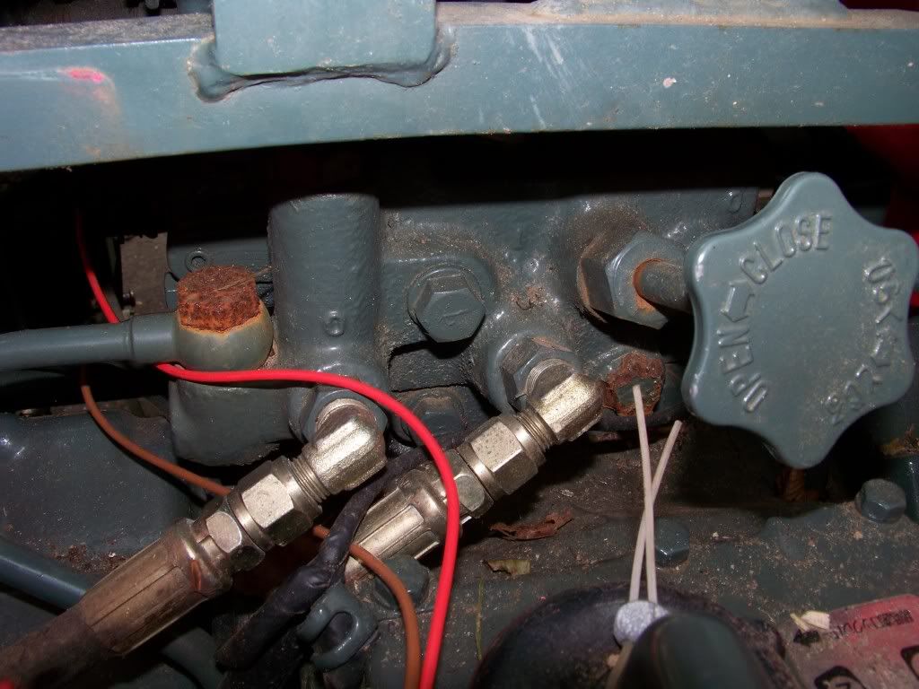

I just got my pb sleeve from Koyker so I will be re-plumbing the loader and my soon to be newly installed rear remotes. :thumbsup:
I am in the process of converting my splitter over to 3pt and am using the tractor hydraulics on it so far and my 3pt block has the in and out ports I posted the pics of earlier.
I plan on only using the pressure out and return both the loader and the remotes to the top plate on the trans case like kenmac did his as long as the 3pt block doesn't have some modification that would not allow me to plug one port off time will tell on that.
I dont want to return the remotes thru the 3 pt block either like the loader is is my reasoning on that. Right now its working returning thru the block but it kicks the 3pt every time I operate the splitter so I dont know whats up with that something isn't jiving.
....Scotty Dive....
I feel like such an idiot:ashamed: I got to looking through some notes I had made back when I installed my loader and found I have the same name manufacture as indicated on your control valve,
The "blb" stands for Blb hydraulic - Products - Catalog - BM40 I have the BM40
perhaps now you can ID your control valve and find out it's specs,:eek:
   / Loader plumbing #58
Thanks...I found out that too, except I didn't know the model number. I asked the US distributor for some info like if it has a PBY and float? I will share what I find. Do you have a manual?

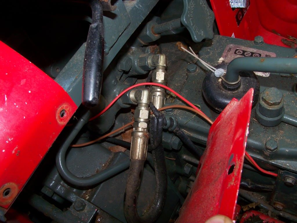

So....first let me say I am just gathering info at this time but at some point would like to add remote hydraulics so I can run a log splitter.
The valve I have is a BLB from Italy and is a BM 40 which does have the option to add a PBY sleeve. This runs about $15.
Here is a link to the BLB website: Blb hydraulic - Products - Catalog - BM40
Now - my loader valve is plumbed from the pump directly and back to the return - see the pictures:
Now my 3pt looks like this and has a hose that loops back on itself:
I mentioned in an earlier post that I am not getting any strength when trying to curl the loader when the 3 pt is in the up position. I have not tried to adjust that yet but is my loader etc plumbed correctly?
And....so if I wanted to add rear remotes, what would be the best way?
