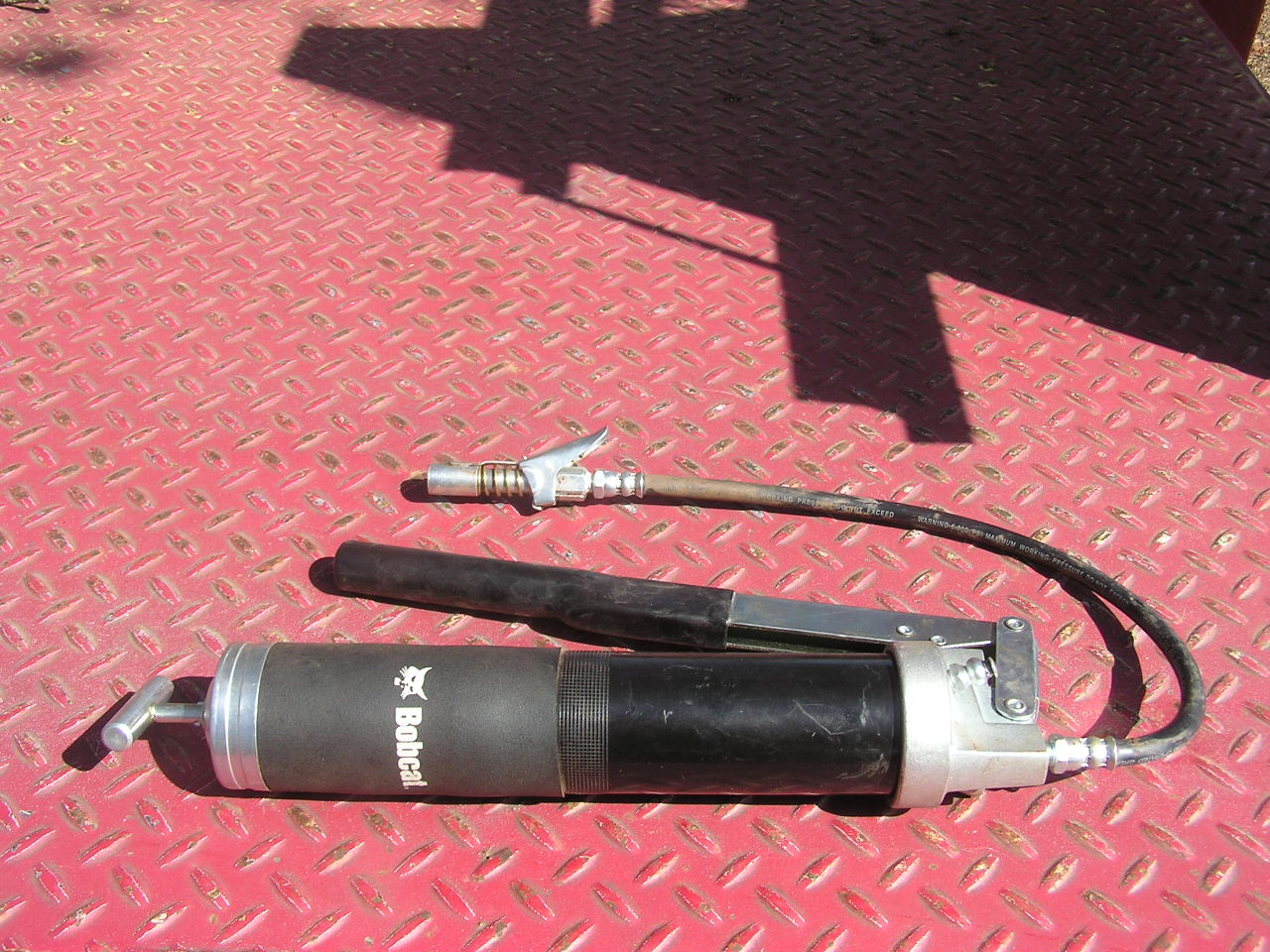

I am real happy with my LockNLube Grease Coupler.
I put it on the lever action, removed the steel tube and used a hose.
You normally don't have a hose on a lever style, because it would require 3 hands to use it. This way I have more flexibility and only need two hands.

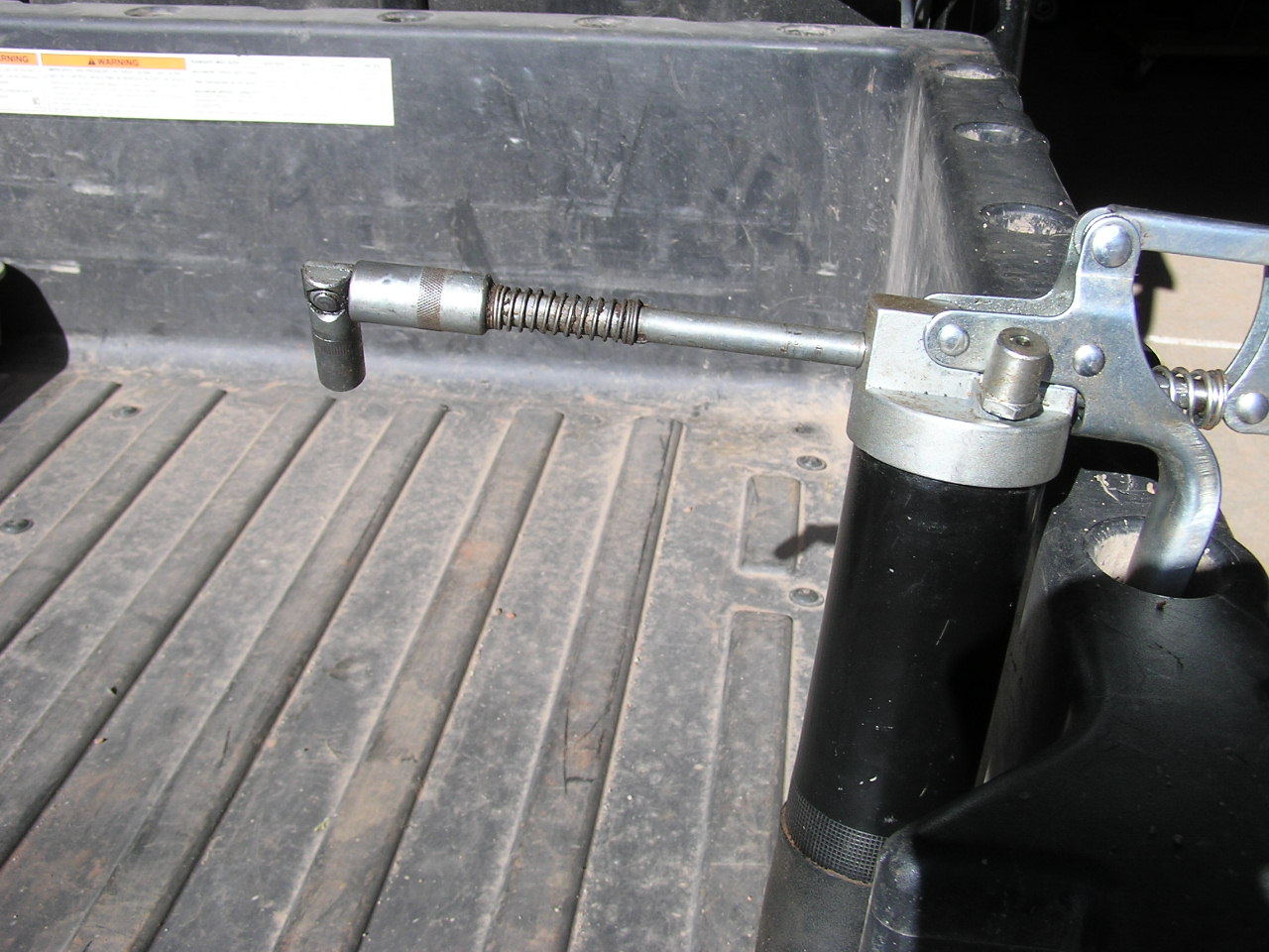

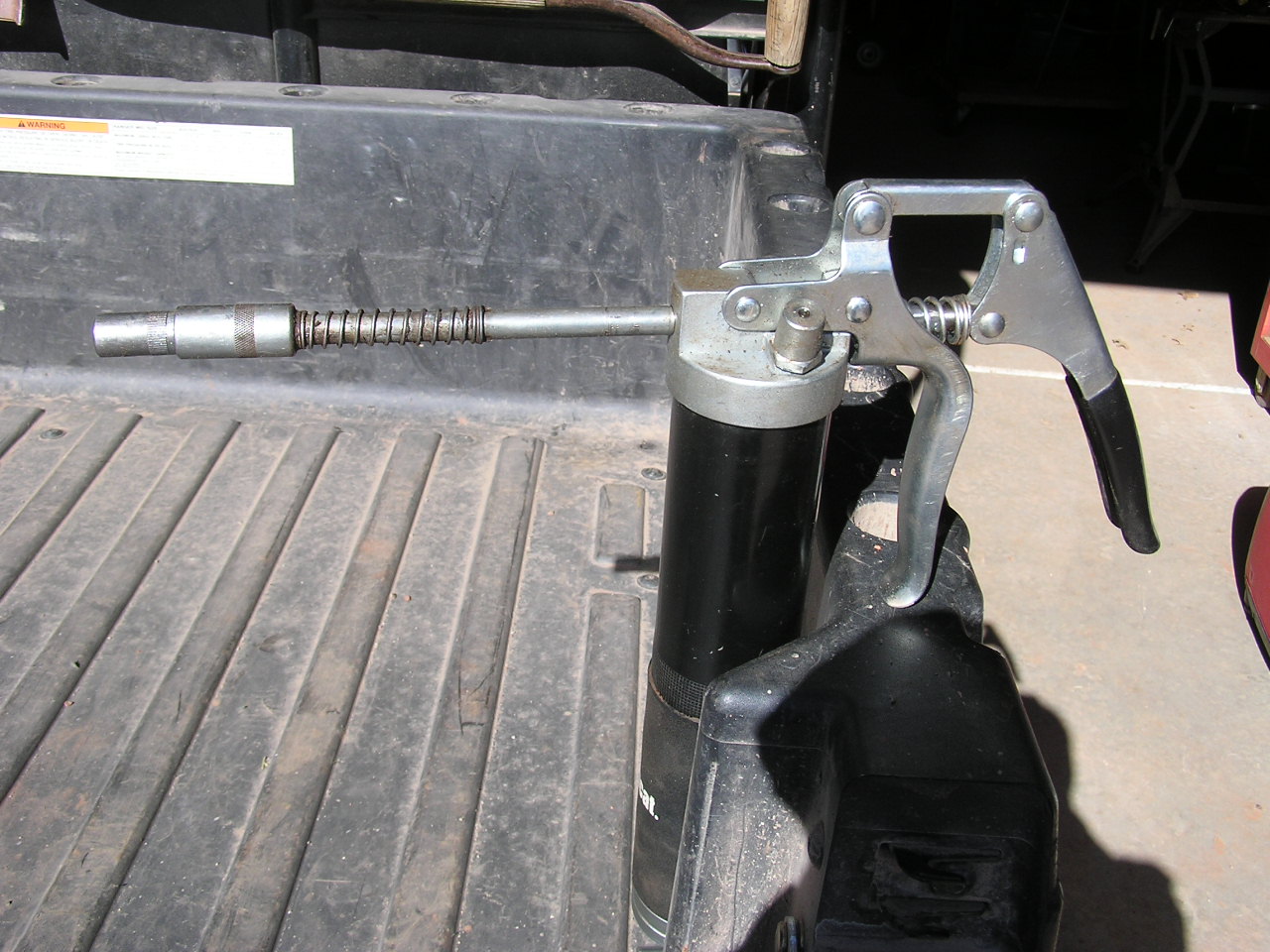

The hose that I used on the lever gun, was removed from this pistol grip gun.
So I put the angle adapter on it. :thumbsup:

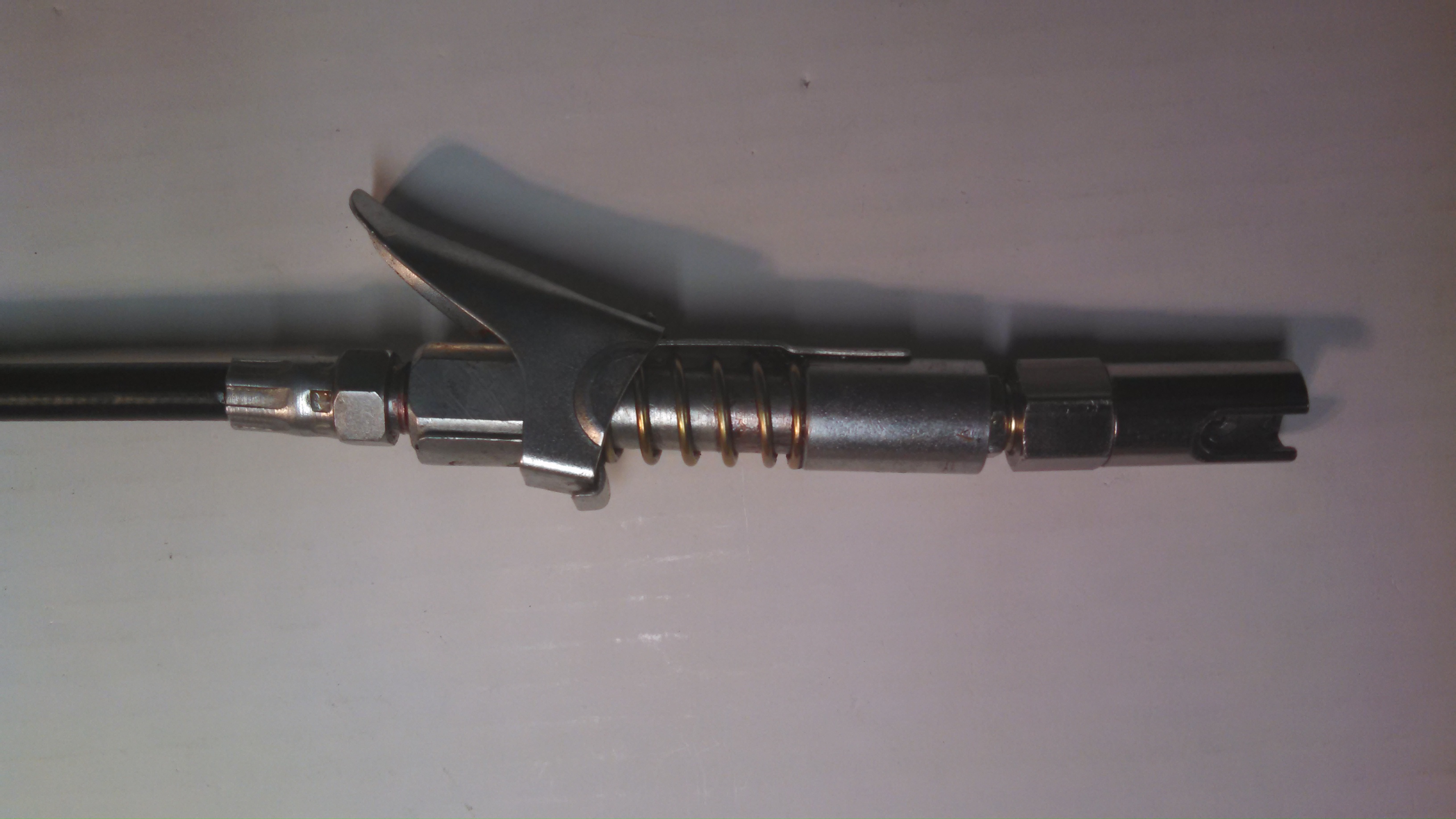

Here is the 90 degree adaptor I made to easily clip on to the LNL so I could get those two fittings under the floorboards of the Kioti
