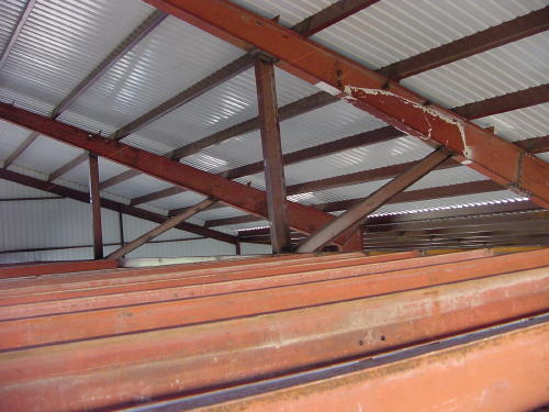

Here's a better shot of the truss idea for the support of the floor across the span. We've taken the weight from a down force to a cross force at a thicker part of the web. Instead of pulling down we're pulling together. /forums/images/graemlins/blush.gif At least I hope so, if not I'm out of politics forever...... /forums/images/graemlins/grin.gif /forums/images/graemlins/grin.gif /forums/images/graemlins/grin.gif

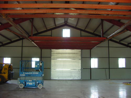

Yup, that's a gap in the Jr beams. We needed twenty seven of them puppies, had only twenty, seven new ones coming in tomorrow, also the decking, and the railing material. We should have this project at the point where all we need to do is find the fork lift mast that is going to retire to a life as an elevator. /forums/images/graemlins/grin.gif
