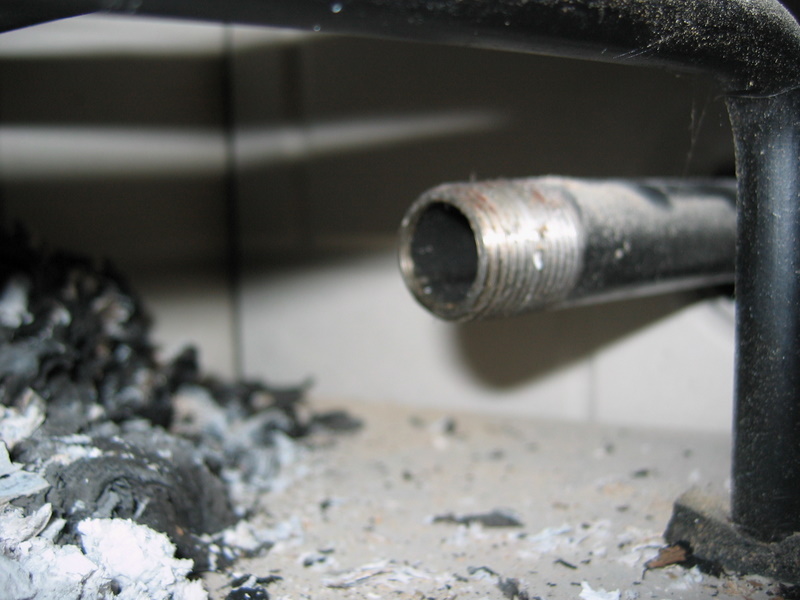

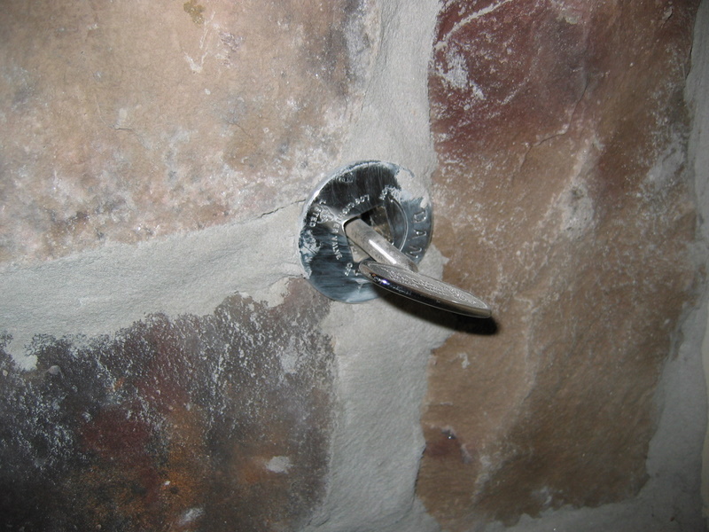

In my new house I had a line run to my indoor fireplace from the propane tank, not for gas logs but for starting wood logs.
There is a valve cutoff sticking out of the rock and inside the firebox is a stubbed out pipe with threads, probably 1/2".
I know I need a log lighter bar, but it is unclear if I need just the pipe (which appears to be open on the end which seems strange) or a kit, which includes the valve (which I already have). Any ideas on what I need?
Also, there is no electricity hooked to the fireplace. How do I light the thing? Use a match?

For some reason the LP version of this device is outlawed by some codes, apparently not in mine (or the plumber would not have run the line for the LP gas).
I certainly don't want something dangerous in my house, but since I was running propane for the tankless water heater and outside grill anyway, I figured it would be nice to have a gas lighter for the fireplace.
Seems like some kind of pilot setup would just burn up in the wood fire.

prppane (like nat gas ) has odorant added. I've never seen propane used for log lighters. Propane is heavier than nat gas & air. it doesn't tend to rise ,but stay low to the ground. This is what makes propane so much more dangerous to use. So, be real careful if you use it in this way. I have made log lighters out of 1/2 pipe by drilling holes along the pipe & capping the end

Alan that set up scares the beJezzuz out of me.
It appears your plumber ran the line figuring you'd have a professional install a gas log fire in your fire place.
What I'd do right now, this morning, would be to cap that pipe. If I was going to consider using the propane source for a lighter I'd immediately install an explosive gas meter as close as practical to the fireplace. And I'd sure as heck remove that key and put in a place where an inquisitive child or adult wouldn't be tempted.
All it would take for a disaster would be an accidental contact with the key and then a spark some time later.

Removing the key is a great idea. My plumber definitely knew what I had in mind, and never said anything about the danger.
I guess I still don't see where the danger is, although Harv just brought up a biggee and that is having a grandchile turn the gas on. I will remove the key.
Is it possible for the propane to be leaking while the fire is lit? If not, whats the difference in danger level from a hot water heater or furnace. Is it just the pilot light?
Added later: The key is out. Thanks for the great advice!

Alan, I have replaced those valves B-4 . Over time they will leak a small amount of gas ( just from being turned on & off ) A gas water heater or gas furnace ( these days ) have soo many safety devices installed that, whlie it does happen it's rare
