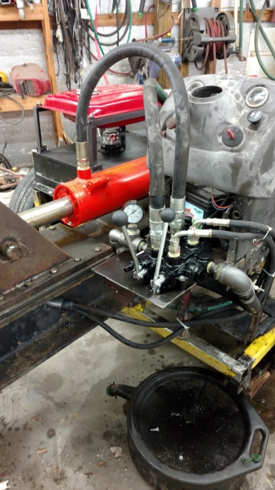

That would work but obviously you lose the auto cycle. Most people who want the autocycle and lift/four way cylinders end up using two rd25xx prince valves.
Here's mine
The pump supplies the lift/four way valve on the left first. And then the PB from that valve feeds the auto cycle. Each valve has a return to the tank.
And here's how I did the dump valve.

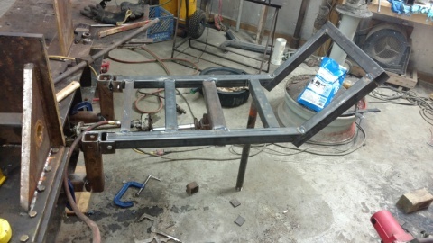

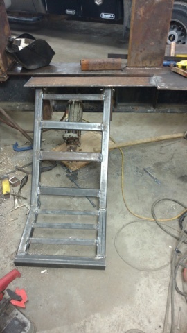

   / LOG SPLITER BUILD
#44

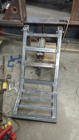

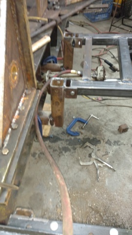

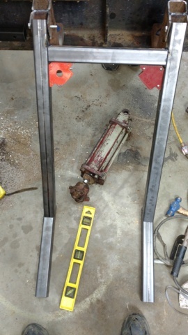

1456358655919.jpg1456358667150.jpg1456358676229.jpg1456358685866.jpg1456358695910.jpg1456358721129.jpg
Finally got the log lift built. Used 2x2 1/8" thick for the frame. 3" bore cylinder 8" stroke
   / LOG SPLITER BUILD #45
Nice work.

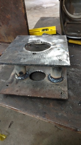

Got the pump mounted today.
   / LOG SPLITER BUILD #47
Nice job on the mounting plate and getting things lined up

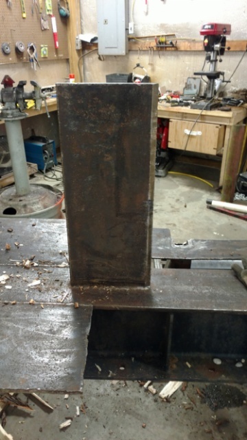

So I got it all together had a few leaks to fix but not too bad. The log lift has just the right speed 3/8 hose.
I'm not sure about the wedge I put a big piece of wet maple 2' diameter had to turn the pressure up to 3000psi and it popped right through.
My question is should I cut some of the top of the wedge out so it will start the the split on bottom first ?
   / LOG SPLITER BUILD #49
No on the wedge mod. If anything, do the opposite so it splits top first. That way the piece don't ride up.
