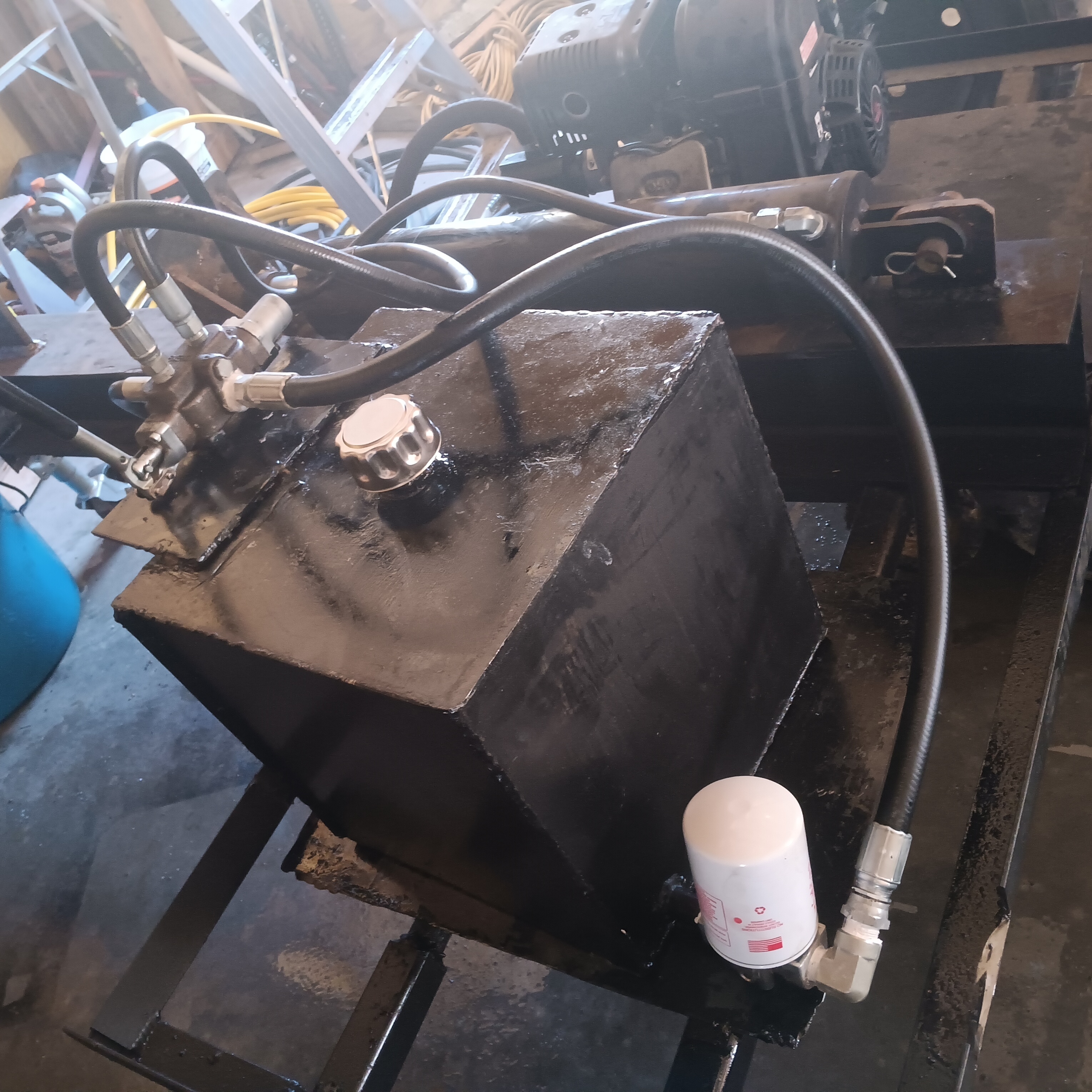

Well now the spliter is running and no mess on the floor! The new filter body I put on is working good. It's a good thing I bought a 3/4 " hyd. line because lines are jumping when the spliter is on.

There are hard (semi-flexible) clear plastic tubings, such as polyethelene tubing that has a pressure rating of 190 psi at 72F and a max working temperature of 180F, but this is still incredibly low for a hydraulic system. This essentially translates to a blown line anytime someone is a little lax on their filter change routine
And that's why I just use hyd hose on every part of the system.

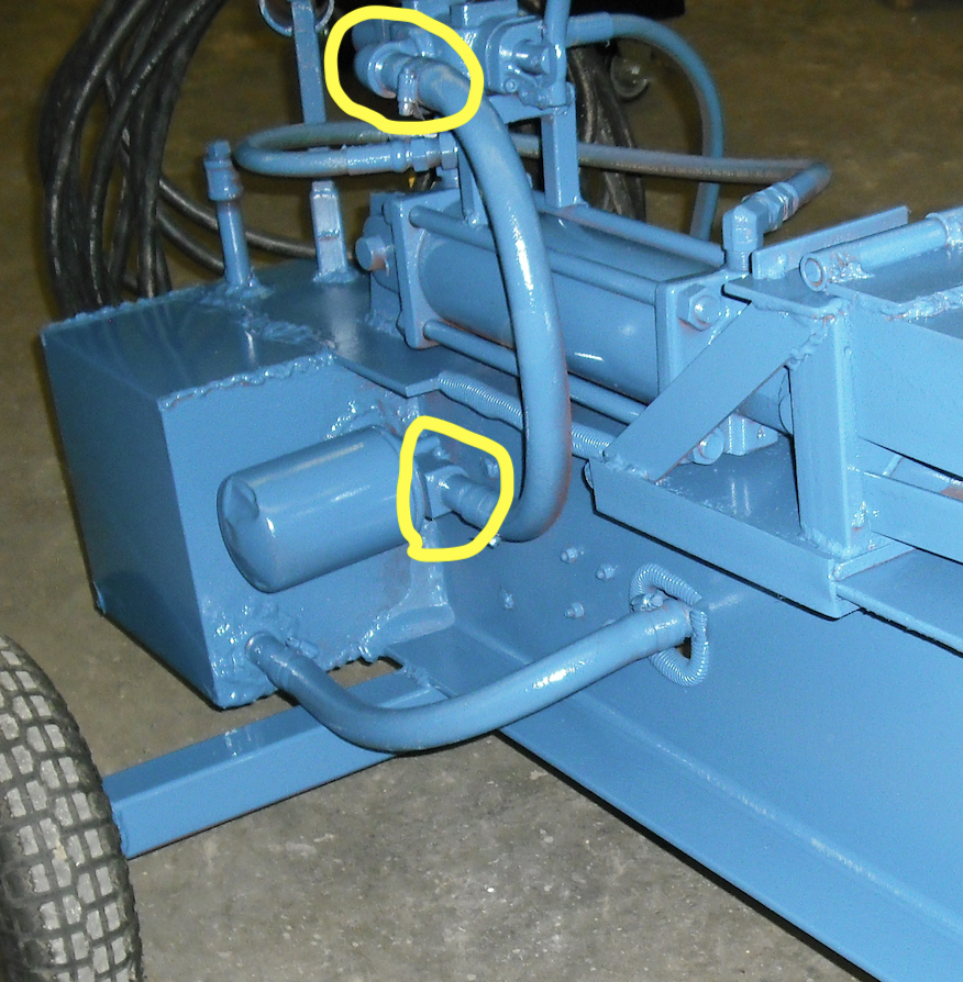

Heck, i think most hydraulic lines on my tractor are only 1/2”.
Also did a home/hand made one using mostly scrounged parts. Out of the control return went to 1" back to filter then tank. Same stuff as feed line from tank to pump.
